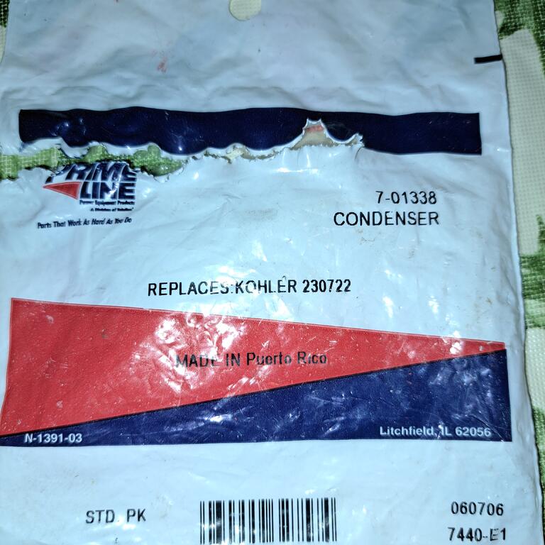

WHX?? 50,740 #11 Posted February 23, 2023 You sayin don't judge a book by its cover Bill? Sorry @wesley we got a little here. I get the prime lines in the jungle Used to pay about 5 apiece for them but now they are quite proud of them. Share this post Link to post Share on other sites
