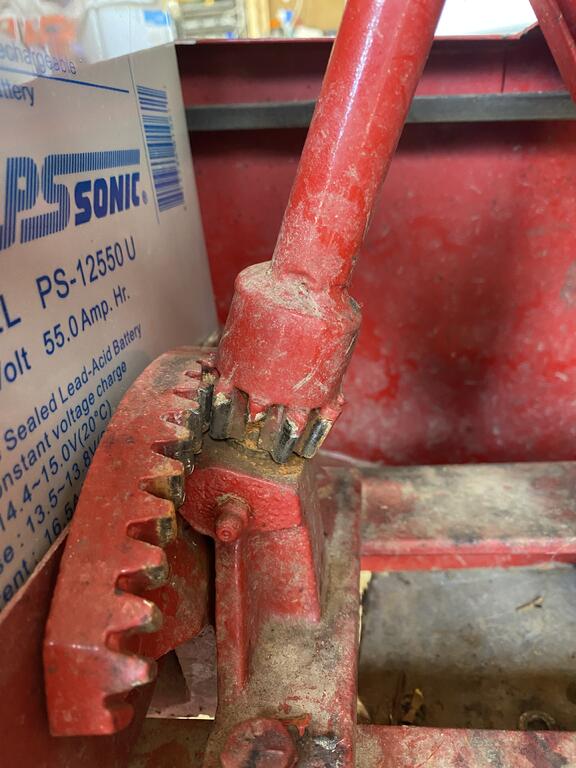

Sled Man 15 #1 Posted February 21, 2023 I have a B-80 that has busted tooth on the steering column. Does anyone know the part number or a place to locate a replacement? Not do or die but it does skip when steering. 1 Share this post Link to post Share on other sites

oldlineman 1,489 #3 Posted February 21, 2023 and that grease fitting could use a shot of grease, that would help the steering function a lot. 4 Share this post Link to post Share on other sites
ri702bill 8,738 #4 Posted February 21, 2023 Just now, oldlineman said: and that grease fitting could use a shot of grease and grease the teeth themselves... 3 1 Share this post Link to post Share on other sites

8ntruck 7,256 #6 Posted February 22, 2023 I wonder about greasing the teeth. My 14-8 is used mostly for mowing. That can get dusty at times on my property. Seems like any grease on the steering gears would collect dust and turn into lapping compound. How about some sort of dry lube, like Dri-Slide or some sort of graphite lube? 1 Share this post Link to post Share on other sites
ri702bill 8,738 #7 Posted February 22, 2023 7 hours ago, Pullstart said: The question is, can the steering wheel come off? That always seems to be a challenge - but hey, he can take a Sawzall to the shaft and then press the stub out - the shaft has already gone "paws up" anyway..... Share this post Link to post Share on other sites
ri702bill 8,738 #8 Posted February 22, 2023 7 hours ago, 8ntruck said: I wonder about greasing the teeth. My 14-8 is used mostly for mowing. That can get dusty at times on my property. Seems like any grease on the steering gears would collect dust and turn into lapping compound. How about some sort of dry lube, like Dri-Slide or some sort of graphite lube? My mowing is limited, I keep mine greased lightly. Dry lube OK - probably. The way I see it, something is better than nothing.... Share this post Link to post Share on other sites
squonk 41,940 #9 Posted February 22, 2023 I've seen more gear teeth damaged by worn out support blocks not being greased than damage caused by dirt. There's a grease fitting there for a reason! 6 Share this post Link to post Share on other sites
