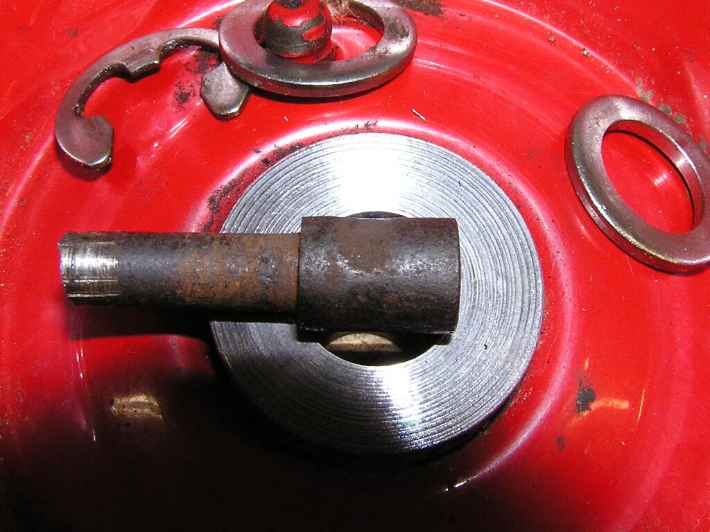

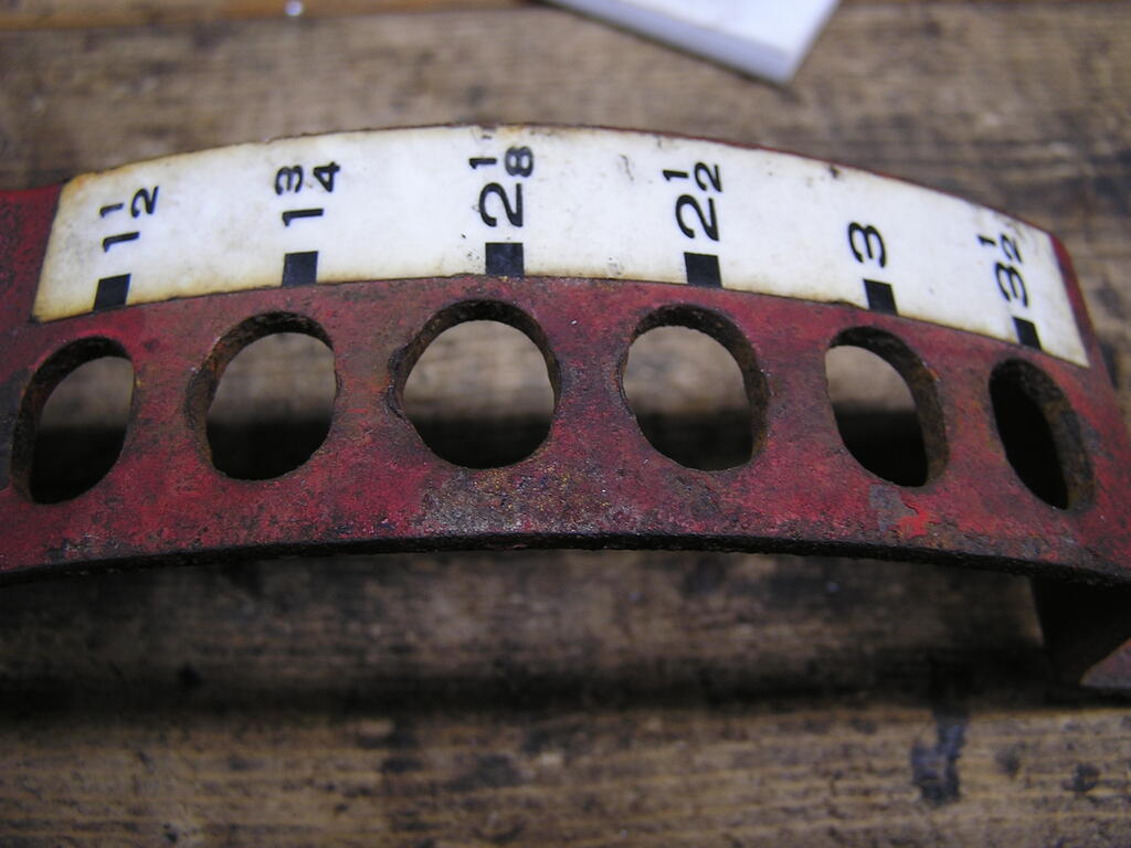

All of us using the old style gear drive 32 or 36 decks have seen the damage done to the height quadrant and plunger.

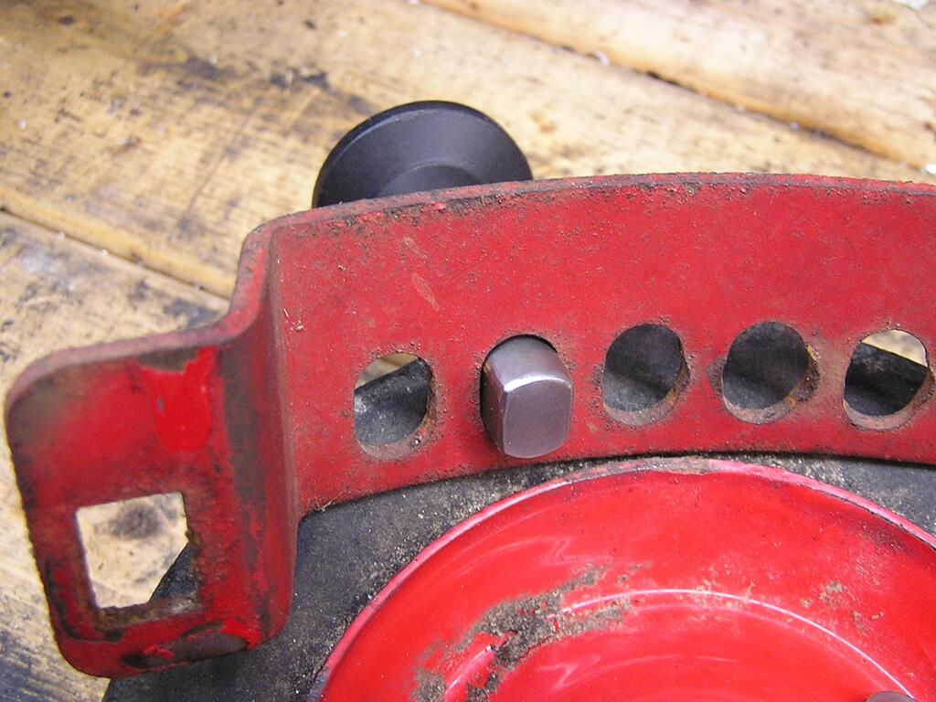

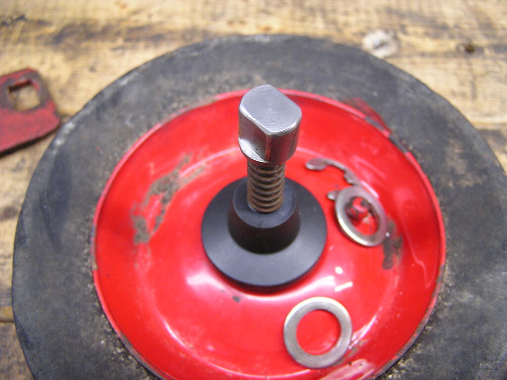

This newwst 32" deck has the least wear of any I've seen - yet I decided to "Fix" it
A larger head with 2 flats - a double D. The tire & rim were just a good locator for the pictures.....
Whatcha think ??
