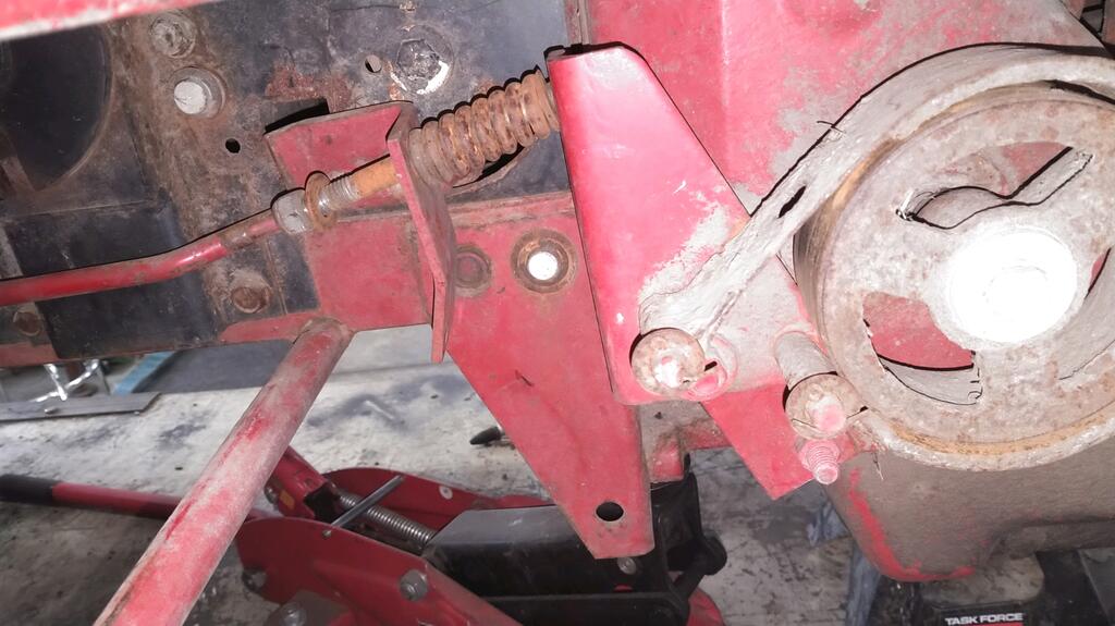

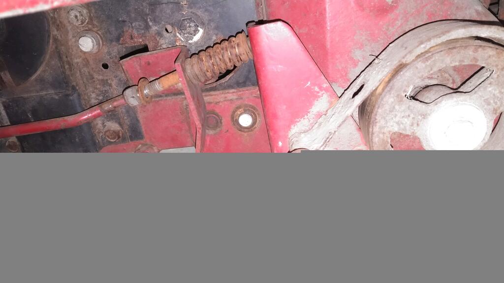

gris71 12 #1 Posted February 19, 2023 I have a wheel horse 312a I'm trying to find a picture of how the break leakage is hooked up with the springs I think the person that had it before me messed it up I went to parts diagram and it is diffrent than what i have can anyone help i will try to send picture of what mine looks like KIMG1013001.JPG.crdownload 1 Share this post Link to post Share on other sites

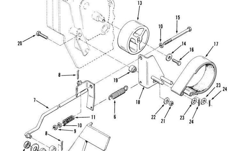

pfrederi 18,314 #6 Posted February 20, 2023 (edited) Sorry my only Eaton Hydro is in winter storage. I do not have any clear pics. Looking at parts manual the heavy spring #11 seems to be on the wrong side of the brake rod plate (part #7) and you are missing the brake return spring #6. Edited February 20, 2023 by pfrederi 1 Share this post Link to post Share on other sites
peter lena 9,074 #7 Posted February 21, 2023 @gris71 , @pfrederi , schematic layout shows you what you have .something I regularly see is neglect of just about anything mechanical that is saposed to move to function . if you can , get that elevated , so you can lubricate , and watch function , get a helper for that . penetrating oil , like KROIL , will get into the tightest rusty spots and make the rust run out . with a helper trying to move linkage , you can watch , intension . and get after it . only a suggestion , pete Share this post Link to post Share on other sites
