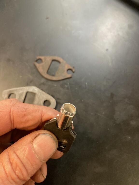

ineedanother 1,431 #1 Posted February 19, 2023 Nothing earth shattering here but I tend to cut my own gaskets at times and the long straight edges are one thing but the bolt holes are another story. I cut a gasket for a fuel pump this morning and considered drilling the 1/4" holes but they always end up being shaggy and a bit of a pain to do. I looked around the shop and considered several thing and landed on filing the teeth from a tool chest key and using it like a cigar punch. One or two hits on a hard surface works pretty well 4 1 Share this post Link to post Share on other sites

Oldskool 6,660 #3 Posted February 19, 2023 Looks like that was the key to success. Good repurpose. Those kits are fairly inexpensive. Worth the investment. Before I had mine I would cut straight in from the edge with scissors then cut my bolt hole. It was never really "round" lol. Share this post Link to post Share on other sites

ranger 1,783 #9 Posted February 19, 2023 If you can find a piece of tube the right size for the hole, file a chamfer on the inside of the tube, this gives a clean cut to the hole. If its ‘discs’ of the material you’re after, file the chamfer onto the outside of the tube, this puts the clean edge on the disc. Another thing to consider is after marking out the gasket, punch the holes first, then cut the inside profile, finally the outside. I find this works better than cutting the outside profile first, less chance of damaging the, usually narrow sides of most gaskets. If you own a lathe, you can make whatever size you need in minutes, use an old piece of copper or lead sheet, or hardwood as an anvil, then you won’t damage the punch. 2 2 Share this post Link to post Share on other sites
Wayne0 938 #10 Posted February 19, 2023 I've been making my own punches out of EMT and asst. pipe for years. Sharpen the end and back it up with a piece of hard (Yellow) pine. 5 1 Share this post Link to post Share on other sites
