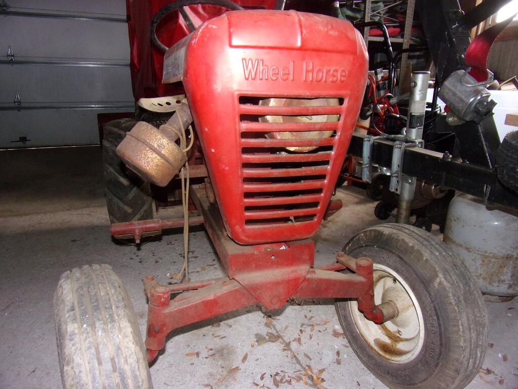

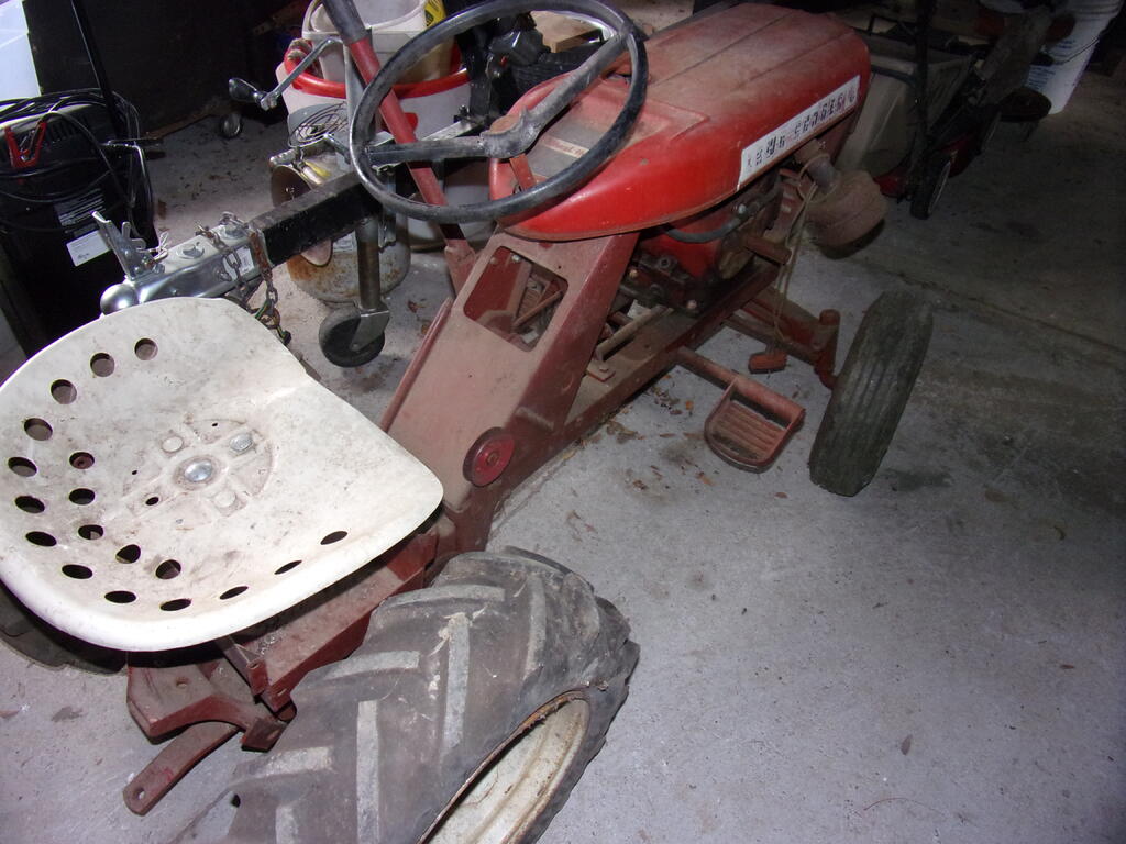

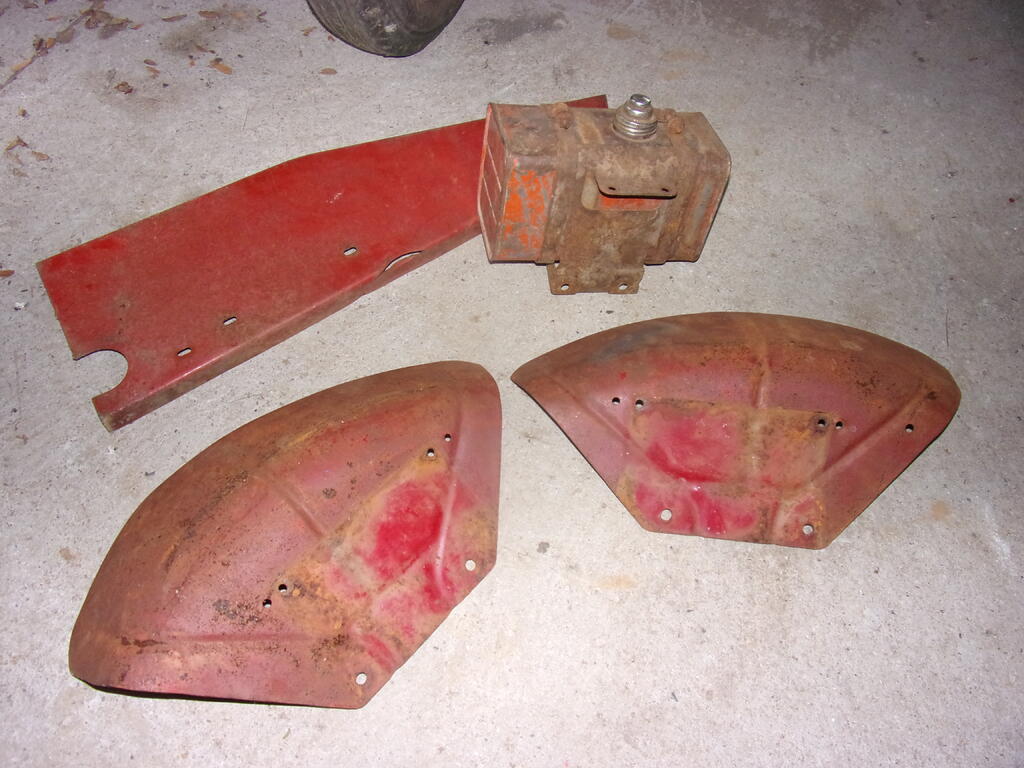

Ed Kennell 39,513 #1 Posted February 16, 2023 What izit? The engine numbers (7HP T 74969 28937E) indicate a 704 with a Lawn Ranger hood ? Are Lawn Ranger and 704 hoods identical but for the decals? Is the seat correct for a 704? The belt guards don't seem to fit. Any idea what they are? The fenders seem to fit. Missing a console plate and a left side panel and correct belt guard ? Does the gas tank look correct? 1 1 Share this post Link to post Share on other sites

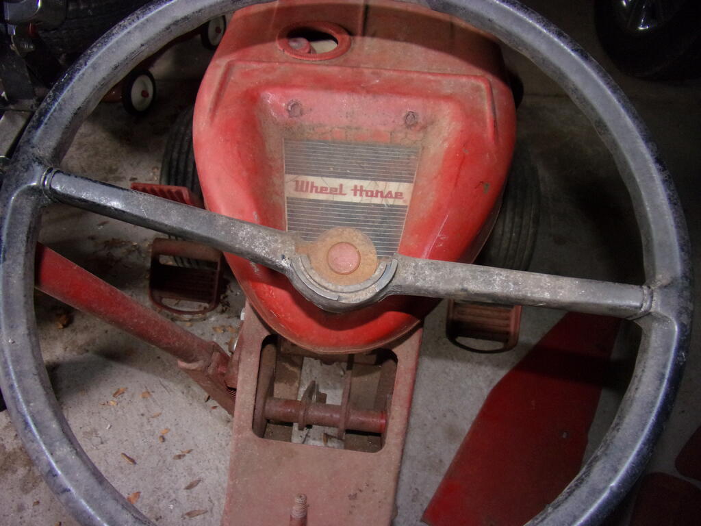

ri702bill 8,633 #3 Posted February 16, 2023 Ed - The broken 2 spoke steering wheel look to be correct, the belt guard with no decal indentation does not - only one like that - that I know of - is the 701. Didn't the Lawn Ranger come with a 6 HP yank start Tecumseh??? The GOOD thing is that the hood is not cut below the upper steering shaft to aid easy removal.... Bill 1 1 Share this post Link to post Share on other sites
Achto 28,080 #4 Posted February 16, 2023 14 minutes ago, ri702bill said: the belt guard with no decal indentation does not - only one like that - that I know of - is the 701. The 867 also shared the lack of ID on the belt guard. 2 Share this post Link to post Share on other sites

ri702bill 8,633 #6 Posted February 16, 2023 (edited) i believe the seat is wrong, should be the rectangular (or square??) pan seat.... but that one is the one to have after a bean dinner... Edited February 16, 2023 by ri702bill 1 1 2 Share this post Link to post Share on other sites
Achto 28,080 #7 Posted February 16, 2023 (edited) 10 minutes ago, Ed Kennell said: Any ideas on the seat and fuel tank pictured with the fenders and belt guards The manual pictures a square pan seat. Which would fit in with the '61 to '64 models. If engine mount tab for the belt guard is on top it is for a Kohler. If the engine mount tab is in the middle it is for a Techy. Parts manual shows an oval gas tank. Fenders look correct for a 704 Edited February 16, 2023 by Achto 1 Share this post Link to post Share on other sites
wallfish 17,141 #8 Posted February 16, 2023 Lawn Ranger, 604,654, 704 use that hood Gas tank is a Briggs and not correct Seat is the style for RJs and Suburbans Fenders are just like a 604,654 and? So is the frame. I'm not that familiar with Lawn Rangers so...might be the same My first guess is a modified Lawn Ranger by someone else that thinks those tiny front tires look ridiculous. 2 1 Share this post Link to post Share on other sites
Achto 28,080 #9 Posted February 16, 2023 (edited) 6 minutes ago, wallfish said: My first guess is a modified Lawn Ranger The dash/ rear hood stand is not correct for a Ranger. The Ranger uses a 2 piece stand held together on the sides with 4 bolts. I'm going to stick with 704 that has some other pieces thrown at it here & there. I do agree that the 4" rims look silly on a LR Edited February 16, 2023 by Achto 2 Share this post Link to post Share on other sites

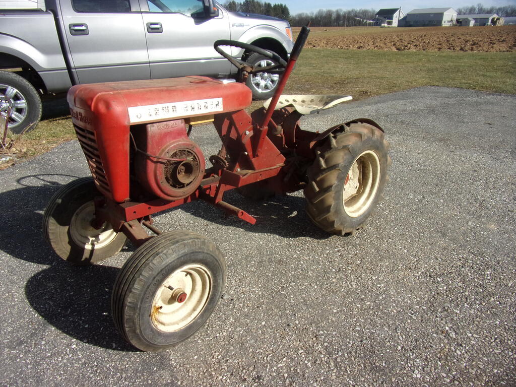

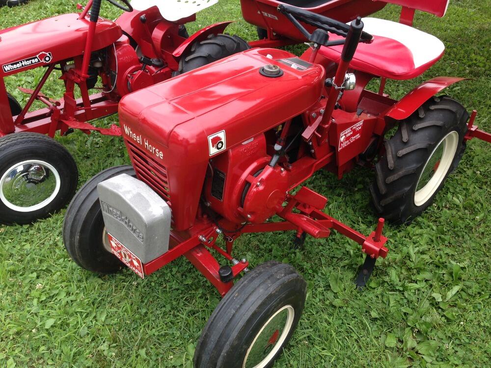

squonk 41,774 #10 Posted February 16, 2023 (edited) How a 704 looks. 604 Is the same but with Tecky Drive Edited February 16, 2023 by squonk 2 1 1 Share this post Link to post Share on other sites
