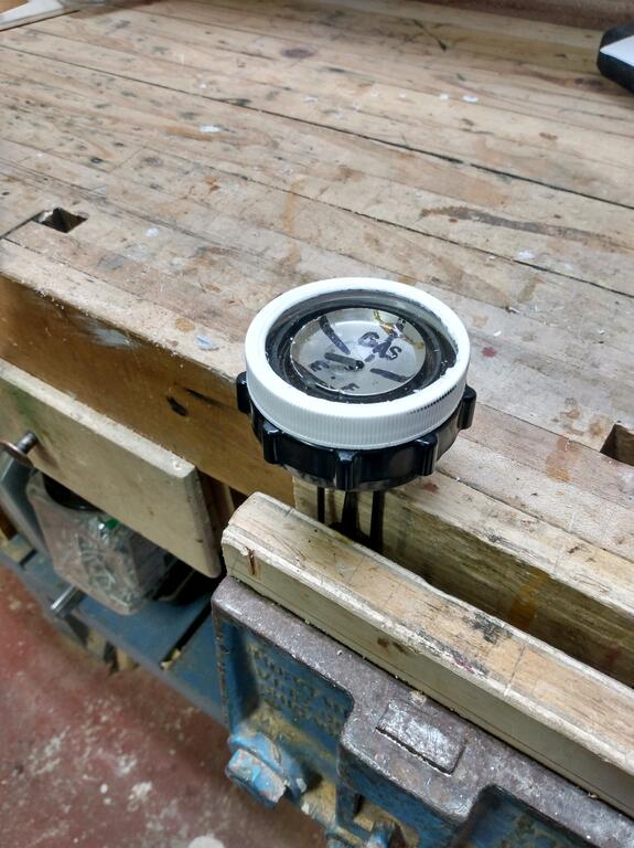

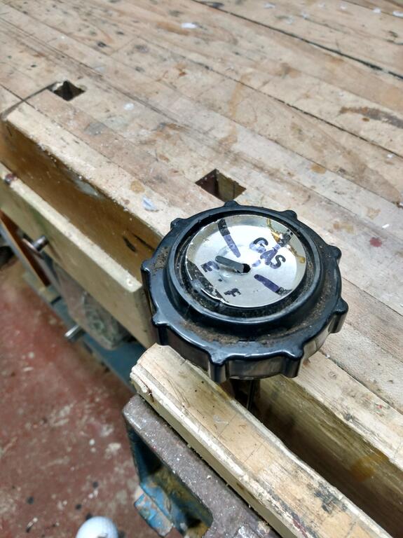

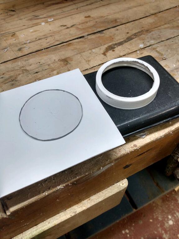

CCW 1,313 #1 Posted February 14, 2023 (edited) Check the three photos. First shows gas cap without plastic dome cover. Second displays a piece of plexiglass and plastic jar top with the center removed. Third is the planned assembly. What I need is an adhesive that will glue the plastics together and is impervious to gasoline. Any suggestions? Edited February 14, 2023 by CCW 1 Share this post Link to post Share on other sites
ineedanother 1,369 #2 Posted February 14, 2023 I would probably go with epoxy or even consider superglue since either of those are likely best cleaned up with acetone. There may be better solutions but nothing else comes to mind Share this post Link to post Share on other sites
Skwerl58 737 #3 Posted February 15, 2023 JB Weld makes a plastic weld epoxy that works great on plastics. I used it on a radiator overflow and also on my atv plastic and it has held up for a couple of years. It also dries black. 1 Share this post Link to post Share on other sites
