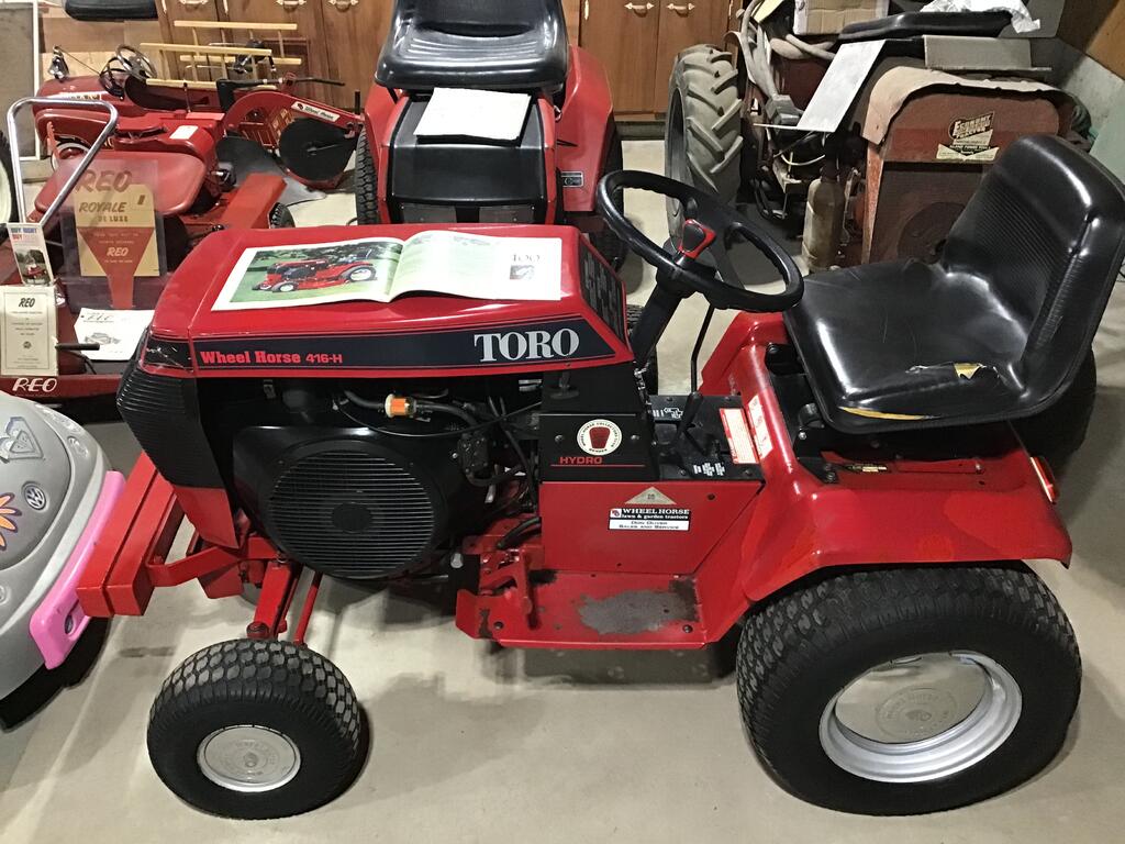

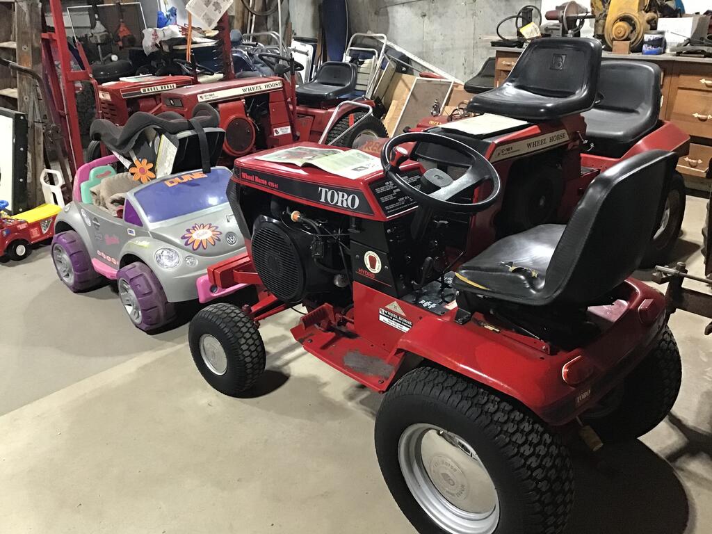

Some of the 416’s came with 6” front wheels which required a taller spindle so the tractor would sit level. The smaller front wheels would allow room for the 37” twin blade mower deck. Because the blades were so offset the deck was a little deeper front to back. 42” and 48” decks use standard spindles and 8” wheels. Here’s a reference.
