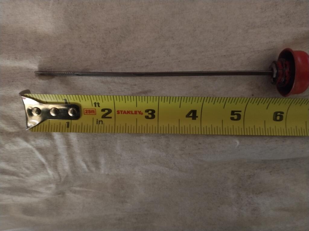

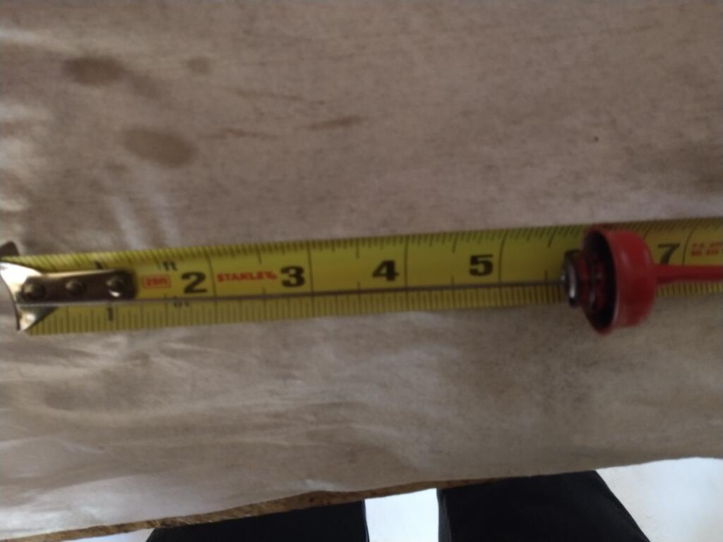

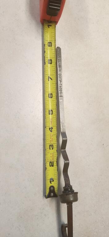

Mark siebenaler 107 #2 Posted February 14, 2023 Could someone please verify this is the correct length obviously someone else put this in at some point. I usually make sure the oil is up to the o. In oil? 1 Share this post Link to post Share on other sites

ebinmaine 69,082 #5 Posted February 14, 2023 So a mid-70s Sundstrand transmission. I can get a pic with length in an hour or two if somebody doesn't do it sooner. You want to make sure this type of transmission is NOT overfilled per @daveoman1966 but I don't remember the technical reason. Share this post Link to post Share on other sites

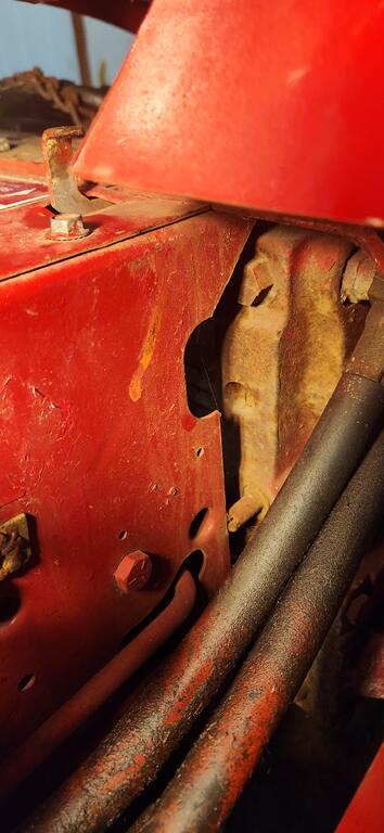

Mark siebenaler 107 #15 Posted February 15, 2023 Without removing fenders or top covers I can not see a relief valve so I'm sure it's some sort of bolt or something hidden? 1 Share this post Link to post Share on other sites
ebinmaine 69,082 #16 Posted February 15, 2023 4 hours ago, Mark siebenaler said: Without removing fenders or top covers I can not see a relief valve so I'm sure it's some sort of bolt or something hidden? Might be a bit tough to see but you shouldn't need to remove any sheet metal. Can you please post pics of your tractor so we can see what you're seeing? Share this post Link to post Share on other sites
Ed Kennell 39,330 #17 Posted February 15, 2023 Here is a pic of the tow/push valve that is on the transmission on many of the C-160s 2 Share this post Link to post Share on other sites
Mark siebenaler 107 #18 Posted February 15, 2023 Yep same exact spot 1 Share this post Link to post Share on other sites
