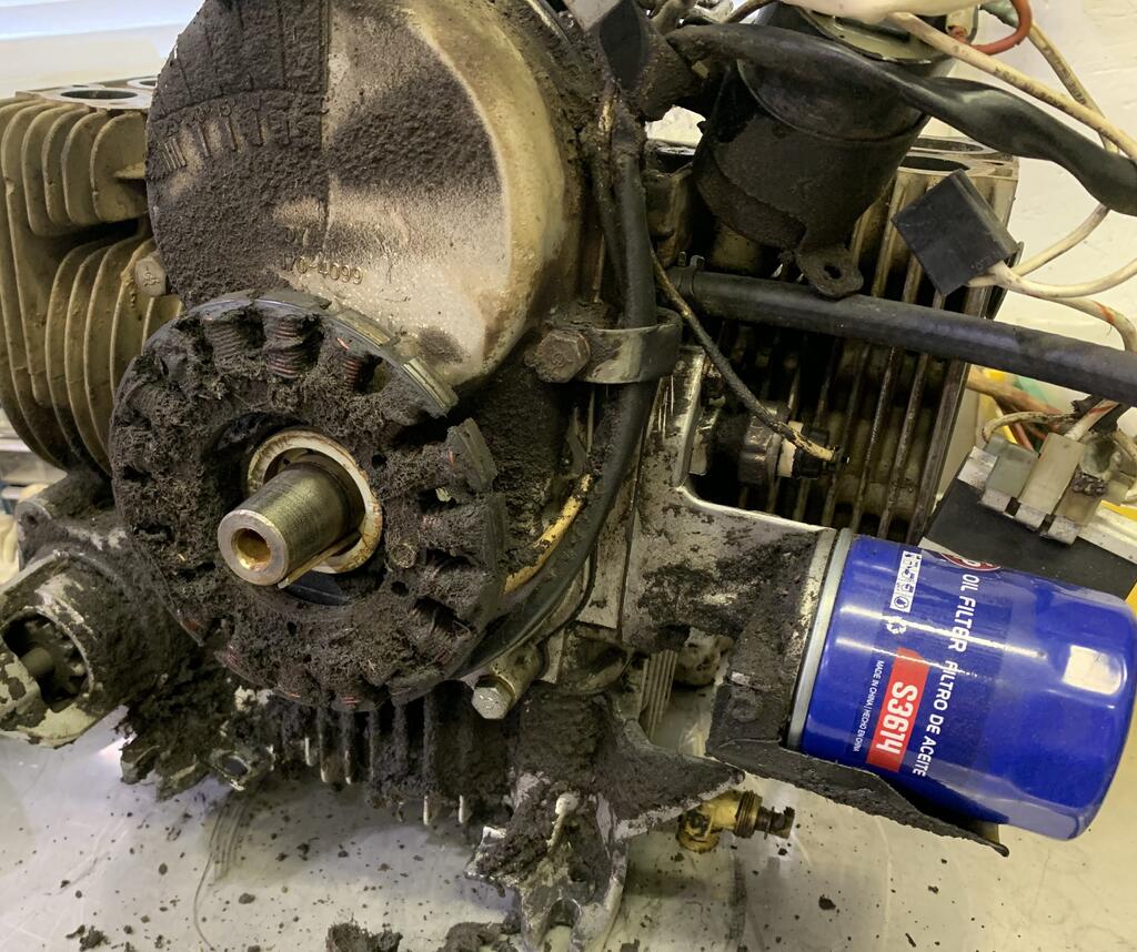

lynnmor 7,216 #6 Posted February 9, 2023 1 hour ago, Brad520H said: Sorry correct, pulse hose. I was able to take it off and it does in fact still have pulse so doesn’t seem to be cracked/ disconnected thankfully, but gonna be a little tough to get back on the pump with basically no extra. I cranked for awhile with nothing. Going to replace long fuel line from tank to pump since it’s definitely old. Didn’t see leaks but definitely chance of air getting in from some places. Had been out in the sun for awhile so some very small rot areas by the pump may be the problem. Thanks for the help! Did you try pulling the line that goes back to the tank to see if fuel will flow? You usually can hold the pulse hose with skinny long needle nose pliers while installing it on the pump. Your pump might be bad, you can buy cheap aftermarket for about $15. Here is a photo, the black hose above the blue oil filter is the pulse hose, as you can see there is a path to the hose nipple with the oil filter off. 1 Share this post Link to post Share on other sites

Brad520H 17 #8 Posted February 10, 2023 19 hours ago, lynnmor said: Did you try pulling the line that goes back to the tank to see if fuel will flow? You usually can hold the pulse hose with skinny long needle nose pliers while installing it on the pump. Your pump might be bad, you can buy cheap aftermarket for about $15. Here is a photo, the black hose above the blue oil filter is the pulse hose, as you can see there is a path to the hose nipple with the oil filter off. Thanks this helps for sure seeing where it goes. Thankfully that line happened to still be good but gonna save this for reference if needed in the future 1 Share this post Link to post Share on other sites
