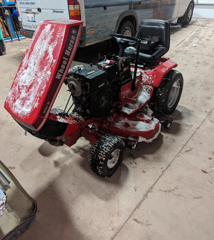

stegs 325 #1 Posted February 1, 2023 (edited) Picked up another horse. Saved it from being parted out and sent to the scrap yard I got a 1989 312-8 12 HP kohler magnum came with a 42" side discharge deck Guy had it for sale for weeks for $950. Dropped the price down to $750 about a month ago I messaged on it to ask questions . He told me it ran great, drove great, all the lights work and the hour meter works. He was in need of cash and ready to part it out/scrap it Well I got it for 300 bucks with the mower deck DELIVERED!! Put the battery charger on it and the headlights work, tail lights work, hour meter is clicking/working I havent tried to fire it up yet, but it looks promising!!! oh, and as the snow melted off it overnight, looking at it this morning it appears to be in great shape. Just needs a good wash. Pics to come shortly!! Pic below is when we unloaded it in the shop (battery was dead so we pushed it inside and let it thaw overnight) Edited February 1, 2023 by stegs 12 13 Share this post Link to post Share on other sites

peter lena 8,877 #3 Posted February 1, 2023 @stegs were you wearing a mask on that delivery ? kidding , take advantage of what works , obviousely go over everything . lots of things I would detail do , would especially do the engine run in , for fuel and lubrication improvements . you did more than well , pete 4 Share this post Link to post Share on other sites

stegs 325 #5 Posted February 1, 2023 Battery that came with it, doesnt seem to be taking a charge at all. So on my lunch break ill stop and grab a new one. Hopefully when i get she will turn over and fire up All the lights do work on it, even the "test" lights so im very hopefull a new battery is all it needs (besides some maintenance) 6 Share this post Link to post Share on other sites
oliver2-44 9,929 #6 Posted February 1, 2023 Very Nice! I'm always a little concerned about the engine when the air cleaner is missing and it has a mower deck on em. 3 Share this post Link to post Share on other sites

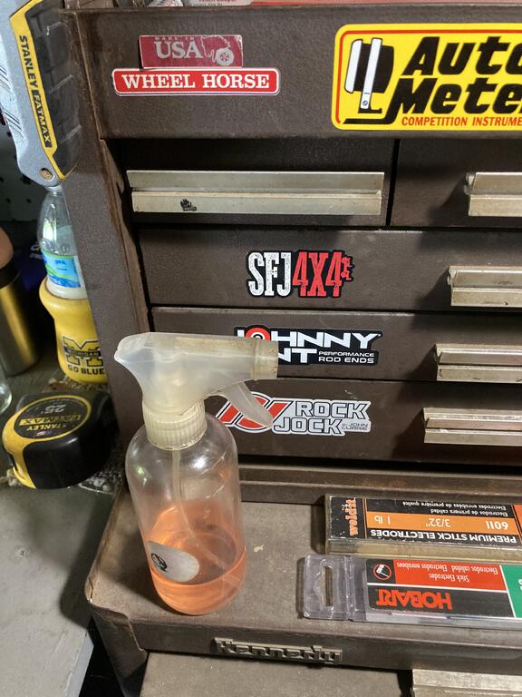

Blasterdad 2,734 #7 Posted February 1, 2023 Give her a little shot of gas in a squirt bottle to prime it, once it fires up I keep squirting gas into the carb until the fuel pump primes & starts running on it's own. ( choke open. about 1/2 throttle ) 5 Share this post Link to post Share on other sites
peter lena 8,877 #8 Posted February 1, 2023 @stegs drop that carb bowl , before your starting attempt , would also verify what you have for oil in it , if its down , just top it off , would just let it heat up on a fast idle , also use the pto lever to enhance side thrust bearing lubrication . have a number of things I do on a recovery . go slow at it , change the fuel filter . lubricate the choke and throttle cables , good luck , pete 5 Share this post Link to post Share on other sites
stegs 325 #9 Posted February 1, 2023 the filter was off because he tried to start it before he delivered it. He was trying to get it to crank but it wouldnt I did drain the bowl. It wasnt bad, but it wasnt great either Installed the new battery, and .........Nothing. No power at all i found a brown wire, coming out of the harness loose by the battery tray. I found a spade connector that was empty, and put the brown wire on it..... She fired right up, no smoke, no noises. Nice and quiet. Trans was good. Idled down and ran sweet at 3/4 throttle Fresh gas, oil change, grease and wash and i think we have a winner!!! 6 11 Share this post Link to post Share on other sites
