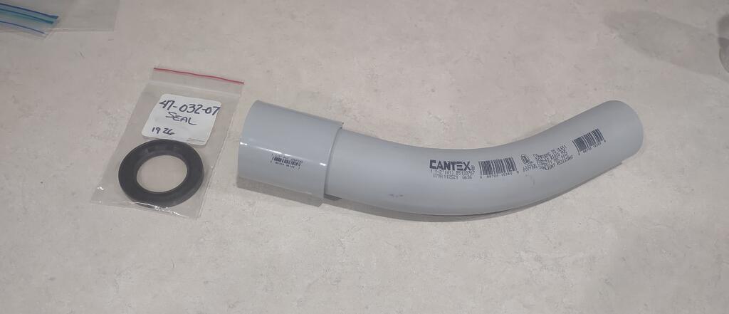

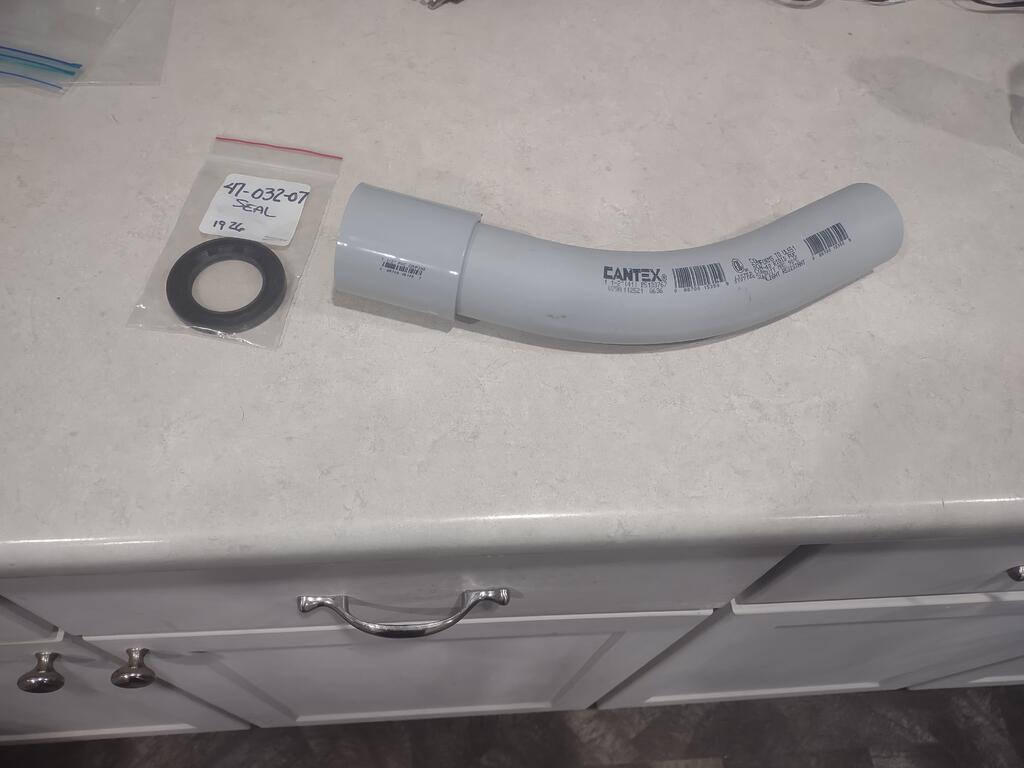

ebinmaine 70,480 #1 Posted February 1, 2023 I posted this somewhere else already but I figured I'd throw it up in the tools section here. I needed a seal driver that would get around the crankshaft because the engine is not disassembled. Even my own favorite small engine repair shop doesn't have these and this was the advice he gave me, along with several people on here. I took the actual seal into the adapters section of plumbing heating and electrical in a Hardware store. I bought the bend so I could chop off a few inches on one side leaving it perfectly straight and then insert that into the adapter. The large end will work on a big block Kohler and the small end will work on a small block Kohler. 8 1 2 Share this post Link to post Share on other sites

ri702bill 8,931 #3 Posted February 1, 2023 OK..... would not a straight section be easier to strike with a mallet?? But - thumbs up for finding a low cost solution - 2 thumbs up because one tool does both styles - always a huge plus... 1 1 Share this post Link to post Share on other sites
ebinmaine 70,480 #4 Posted February 1, 2023 4 minutes ago, ri702bill said: would not a straight section be easier to strike with a mallet?? Sure as heck would but I had to buy 10 ft to get a straight stick so I picked up the type of corner that had the least amount of bend and the most straight section in it. 2 1 Share this post Link to post Share on other sites

oldlineman 1,494 #6 Posted February 1, 2023 Eric, if you heat that pvc with a heat gun slowly it will want to straighten back to its original shape. We used to do that when we needed an angle in-between the factory bends. Don't heat the ends just the bend slowley, you really don't have to help it , bend wants to go back straight. Bob 5 1 Share this post Link to post Share on other sites
squonk 42,428 #7 Posted February 1, 2023 LOWES sells short sticks of PVC. Like 2 footers. 3 1 Share this post Link to post Share on other sites
ebinmaine 70,480 #8 Posted February 1, 2023 7 minutes ago, squonk said: LOWES sells short sticks of PVC. Like 2 footers. Oh sure. NOW ya tell me! 😁 2 Share this post Link to post Share on other sites
