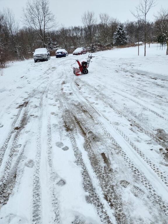

And......  I may be done until warmer weather.  I've temporarily solved my no spark issue as shown in the picture.  That poor red demon (Honda HS928) probably hasn't been run since we moved out of our last house 4 years ago.  Fresh fuel and it fired right up!  It bailed me out today.  Thanks everyone for all of the tips.  I'll do some reading and dive into it when it's warmer.
