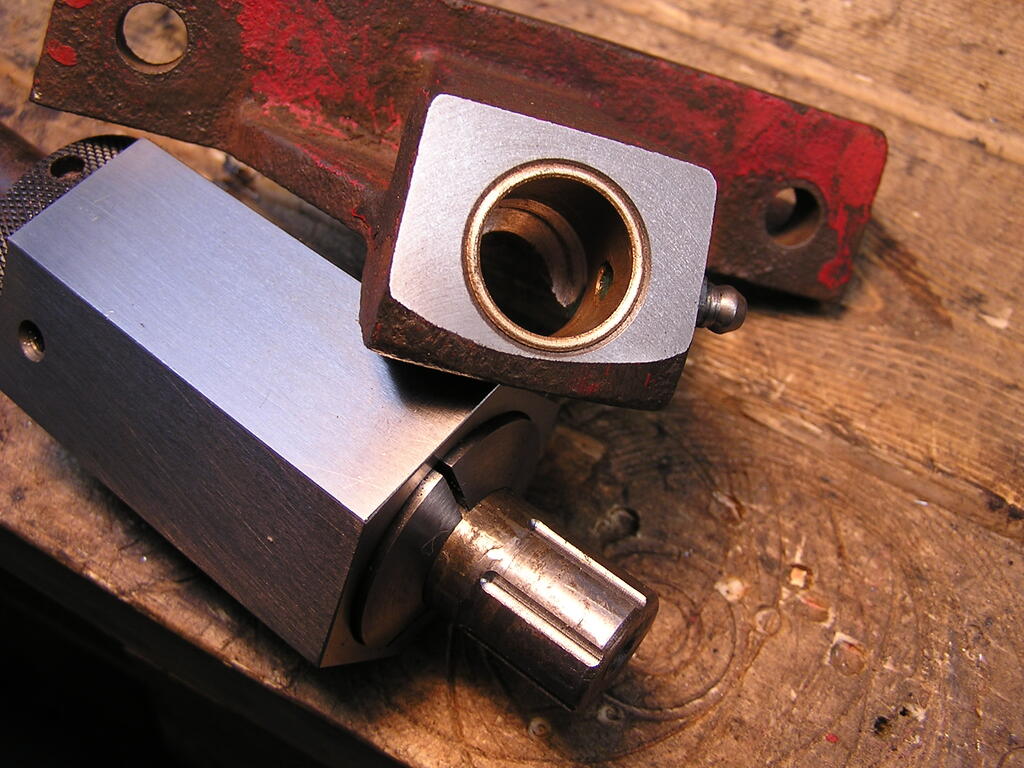

ri702bill 8,740 #4 Posted January 27, 2023 I added a bronze sleeve bearing to the top of the lower steering block; also added a second grease fitting to the lower portion. I undercut the lower steering shaft to accept a sleeve bearing - also I cut 6 small reliefs in the steering wheel shaft to hold grease - all this made a HUGE improvement to reduce steering effort. Do you raise the front of the tractor off the ground and let the wheels hang when you grease the spindles?? It is the only way the grease will get to the upper and lower sections.... 3 Share this post Link to post Share on other sites

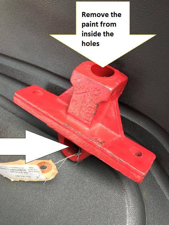

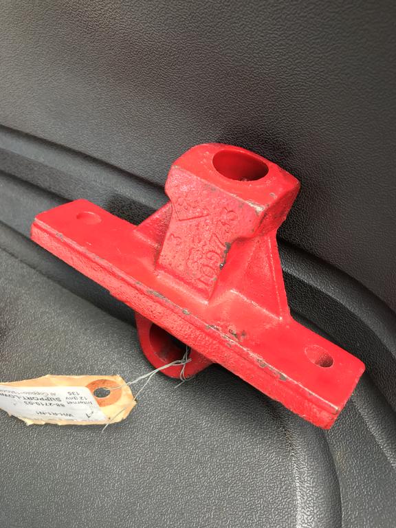

wallfish 17,193 #14 Posted January 28, 2023 If you have any paint in any of the holes it will stick. Spindles too Share this post Link to post Share on other sites
