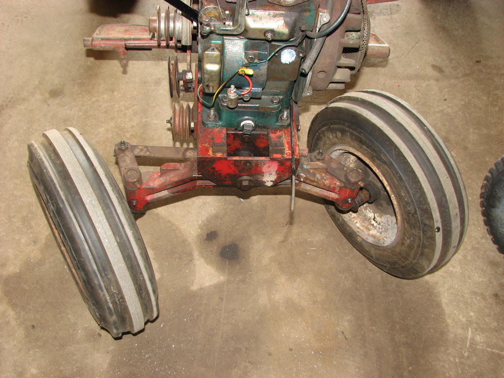

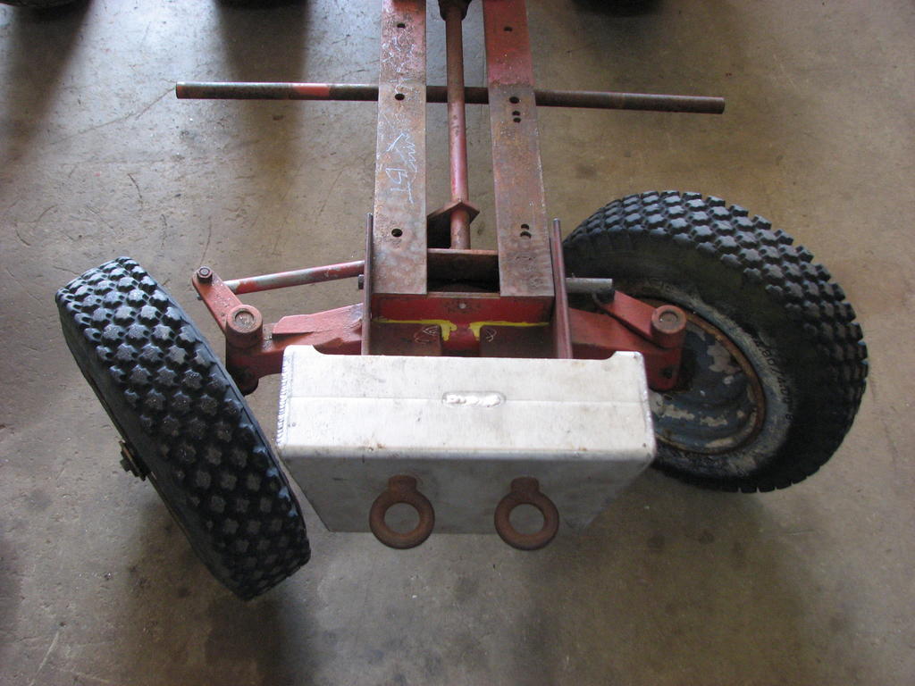

Pullstart 63,529 #3 Posted January 23, 2023 5 hours ago, clueless said: other than year what are the differences between the 702 and the 753? 4 hours ago, ACman said: Check out this thread . oh…. Nothing much! The visual axle and front frame differences made a huge steering radius improvement! 2 Share this post Link to post Share on other sites
ri702bill 8,740 #4 Posted January 23, 2023 (edited) As Kevin mentioned, the 753 has the improved cambered axle with separate tie rods. Frames are different, 753 had the dial-a-height lift lever stop, the 702 had a 2 position. 702 last of the 1 piece fuel tanks with the removable dash plate, last of the hood stand lower braces..... Bill Edited January 23, 2023 by ri702bill 1 Share this post Link to post Share on other sites
