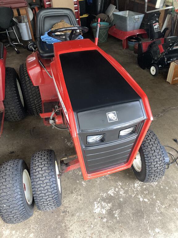

SylvanLakeWH 25,148 #4 Posted January 20, 2023 How about a picture? 1 Share this post Link to post Share on other sites

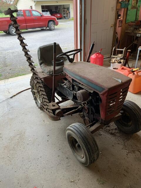

John2189 439 #5 Posted January 20, 2023 10 minutes ago, SylvanLakeWH said: How about a picture? Best pics I have 5 3 Share this post Link to post Share on other sites
ebinmaine 66,576 #6 Posted January 20, 2023 That "12" 56 is a neat looking rig. Must be quite the beast with that engine. 1 Share this post Link to post Share on other sites
John2189 439 #7 Posted January 20, 2023 1 minute ago, ebinmaine said: That "12" 56 is a neat looking rig. Must be quite the beast with that engine. Both tractors was given to me by a friend. The C165 had a broken connecting rod , and it broke a small piece off of the cylinder skirt, it was well below the rings so I put a new rod in it and it runs great. Put it in first gear low range and its a tank. The 656 engine, the ignition coil was bad. I found a fix on you tube that uses a ford brake sensor and a gm ignition module It runs ok but anything over 1/2 throttle it back fires. Im ok with that since you run the sickle at a low speed. The sickle wobble box was loose and wouldn’t hold oil so i put new bushings and seal in it. 6 Share this post Link to post Share on other sites
SylvanLakeWH 25,148 #8 Posted January 20, 2023 The 165 is definitely a repainted Black Hood. Hoods look like this original: 6 Share this post Link to post Share on other sites

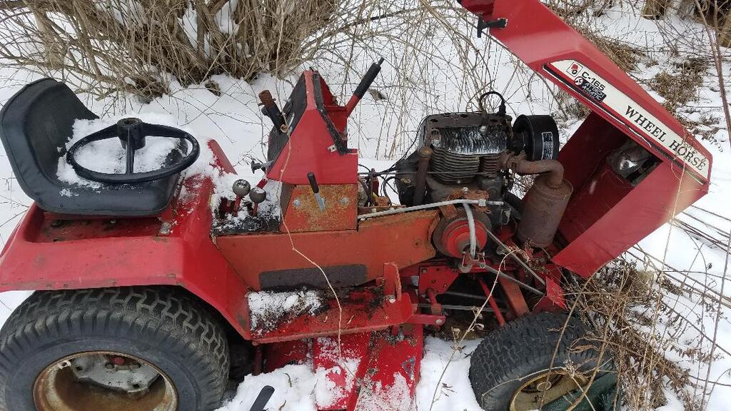

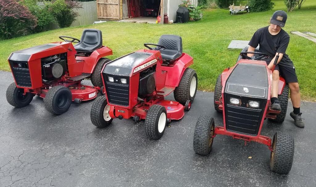

Brockport Bill 1,557 #19 Posted January 20, 2023 18 hours ago, John2189 said: I have a c165. I know the 16 is the horse power, but what does the 5 stand for? the same for my 656 john john -- heres my grandson's C165 Blackhood he and I rescued last year from someone's backyard weeds area that had been sitting many yrs............. we have only really done some modest mechanical work on it but runs fine now - plus a few cosmetics since this photo - we also have two C175 blackhoods 4 2 Share this post Link to post Share on other sites

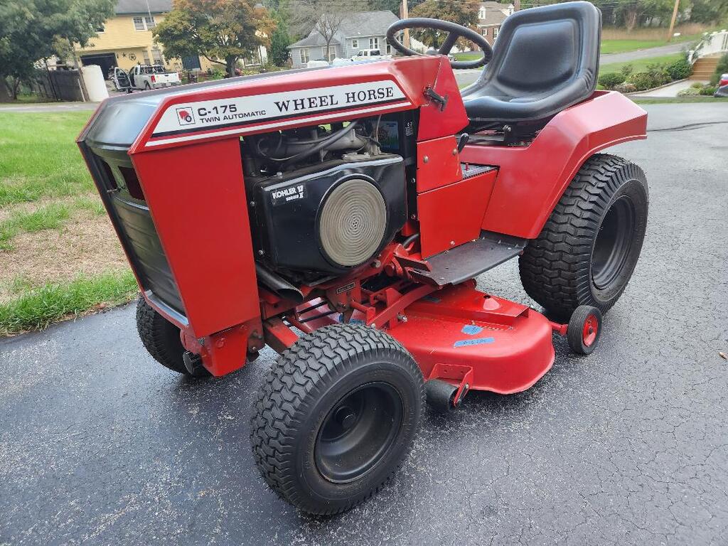

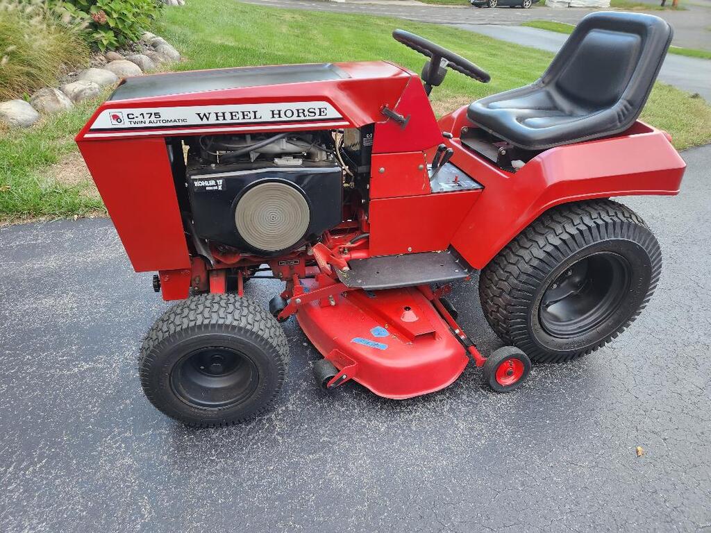

Brockport Bill 1,557 #21 Posted January 20, 2023 here are updated photos of the C175 Blackhood we did some rehab on - including new decal - We did black footrests, and the Engine tin, plus the rims just as some added black to compliment the blackhood design 2 3 1 Share this post Link to post Share on other sites
