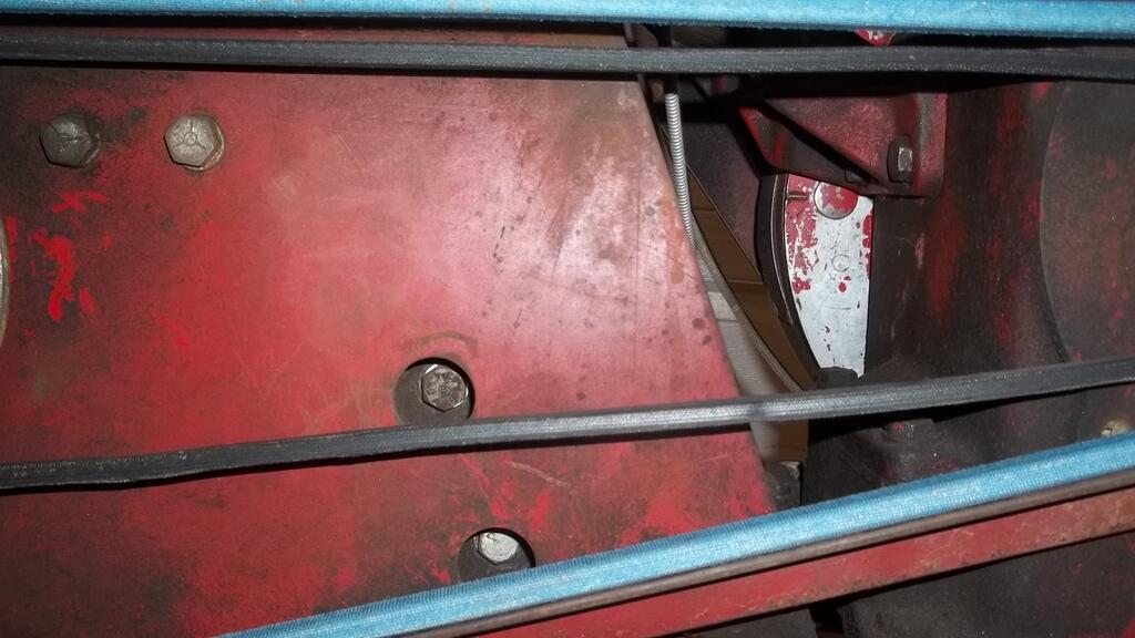

Ed Kennell 40,500 #7 Posted January 20, 2023 (edited) 1 hour ago, wallfish said: there are still ways to guide the belt I used a series of pins and bolts to support the belt on the low rider build. You can see a couple of the pins on either side of the belt tensioner arm. When the clutch was depressed, the pulley pushed the belt forward away from the engine pulley and the clip on the idler pully pinched the belt locking it from moving. It worked great. Edited January 20, 2023 by Ed Kennell 2 Share this post Link to post Share on other sites
