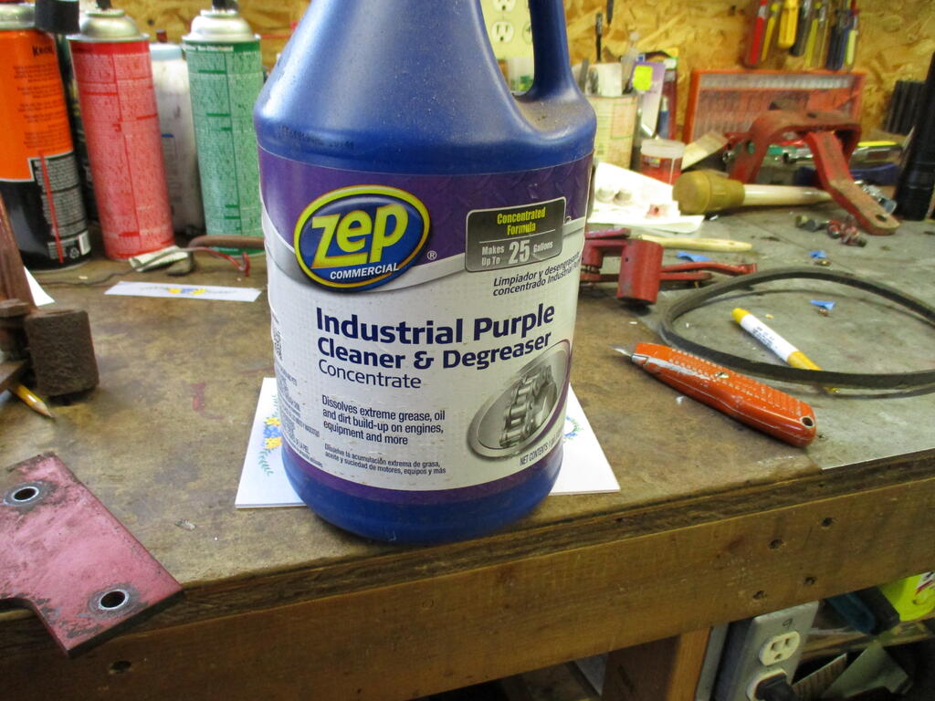

Jeff-C175 7,203 #35 Posted January 20, 2023 (edited) 1 hour ago, squonk said: what I use for degreaser Some of those cleaner / degreasers will turn aluminum a dark gray color and it can't easily be brought back to shiny again. It won't happen immediately, so if you are cleaning and immediately rinsing, probably OK, it takes a bit of time. Make sure to read the labels if it's something that you are concerned about the appearance! I don't think it actually 'hurts' the part though, just alters the surface finish. I think it was the purple stuff, can't remember the name, but it totally wrecked the appearance of an aluminum air plenum on a Chevy engine I was working on. I soaked it in a tub for about an hour. Then I read the label... That said, if it's aluminum that you want to PAINT, it probably makes an excellent etch for paint adhesion. Simple Green does make a solution that they say is "Aluminum Safe" by the way. It ain't cheap!!! Edited January 20, 2023 by Jeff-C175 Share this post Link to post Share on other sites
squonk 42,339 #36 Posted January 20, 2023 1 hour ago, Jeff-C175 said: Some of those cleaner / degreasers will turn aluminum a dark gray color and it can't easily be brought back to shiny again. It won't happen immediately, so if you are cleaning and immediately rinsing, probably OK, it takes a bit of time. Make sure to read the labels if it's something that you are concerned about the appearance! I don't think it actually 'hurts' the part though, just alters the surface finish. I think it was the purple stuff, can't remember the name, but it totally wrecked the appearance of an aluminum air plenum on a Chevy engine I was working on. I soaked it in a tub for about an hour. Then I read the label... That said, if it's aluminum that you want to PAINT, it probably makes an excellent etch for paint adhesion. Simple Green does make a solution that they say is "Aluminum Safe" by the way. It ain't cheap!!! This carb was first soaked in Berrymans carb cleaner for a couple of hours then about an hour in the Ultrasonic with the Simple green and heat for about a half hour. Immediately rinsed after removing from cleaner. No scrubbing or coating applied. 1 2 Share this post Link to post Share on other sites

pfrederi 18,285 #47 Posted February 17, 2023 I used this cleaner in an ultra sonic unit. The Tecky carb came out a dull dark gray and would leave residue on you hand when you picked it up. Tried a bit of buffing just made the wheel very dirty and not much improvement.... Share this post Link to post Share on other sites
