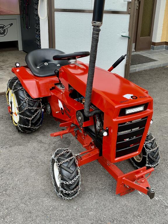

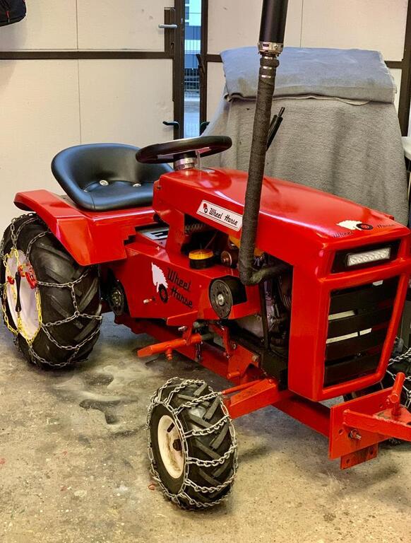

backlash012 61 #1 Posted January 17, 2023 (edited) Hello, everyone, My name is Dieter and I come from Austria. I have a modified wheel horse with a little bit more power and I'm always searching new informations when I have to repair someting Best regards Dieter Edited January 17, 2023 by backlash012 3 9 1 Share this post Link to post Share on other sites
Ed Kennell 40,413 #3 Posted January 17, 2023 to the Dieter. Awesome looking tractor. Tell us more about it....Was it a C series before the mods? I made many trips to Graz, Austria to test hydro turbines at the Astro Hydro Lab. Beautiful City. 5 Share this post Link to post Share on other sites
davem1111 2,091 #4 Posted January 17, 2023 Welcome, Dieter! That is a really nice looking tractor. We would all love to hear any stories you have about its history and the modifications to it. I'm curious - does that stack shake much when running? That is a very tall stack. 2 Share this post Link to post Share on other sites

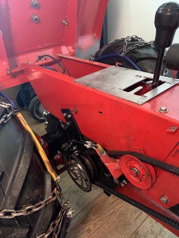

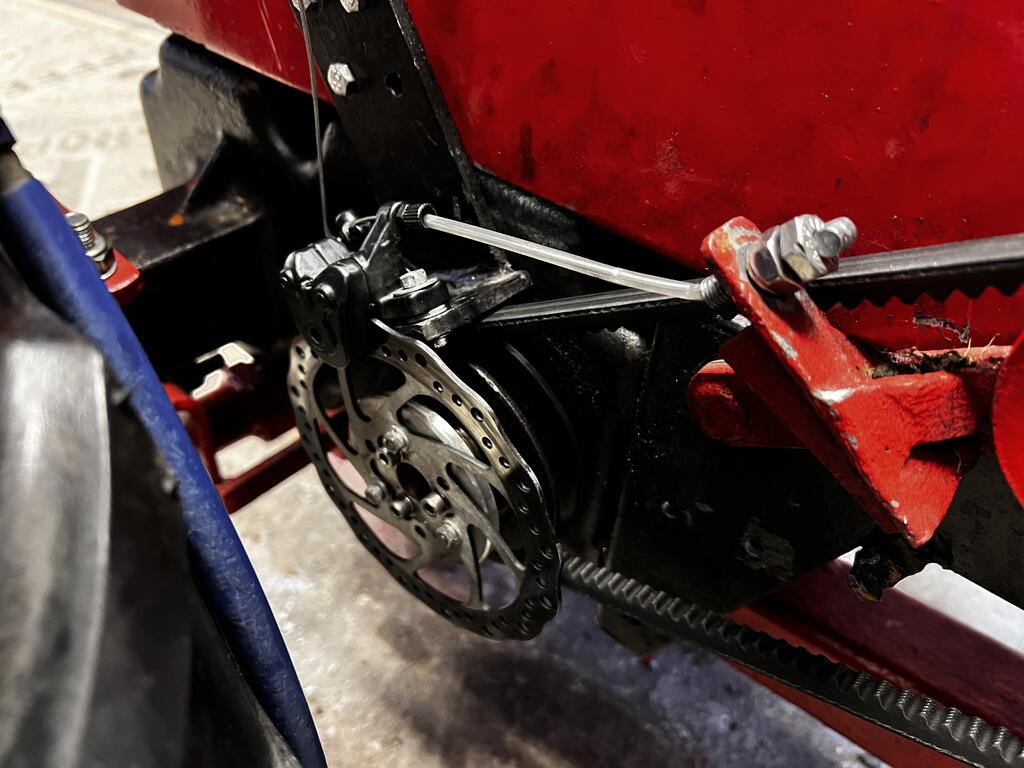

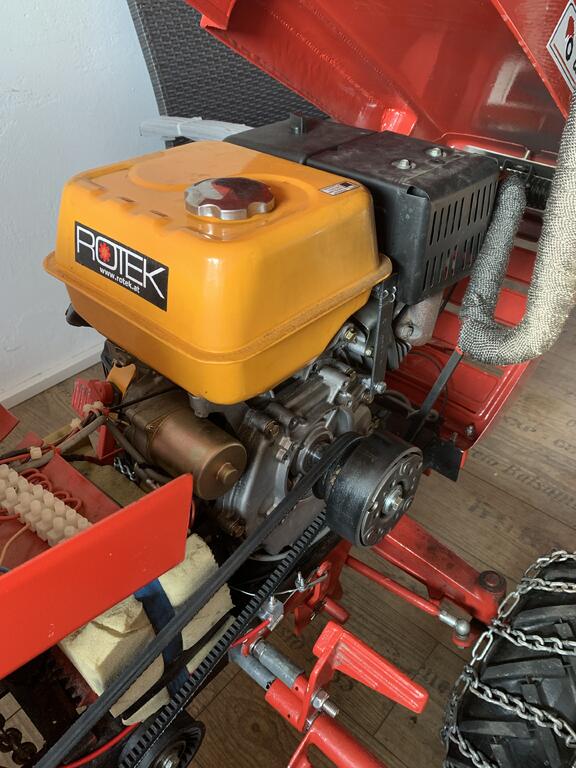

backlash012 61 #5 Posted January 17, 2023 Thanks! I bought it a few years ago only to for snow shipping but slowly one idea comes after another . I added a Rotec 270ccm engine with 6.5kW. You mean the muffler? I made it so high because i don't wanted to breath in the exhaust gases from the engine. Maybe i change it to sidepipes in furure To realize a good working clutch with the more powerfull engine I added a centrifugal clutch to decouple the engine and a disc brake to brake the input axle of the gearbox. I know confusing construction but it works. I also switched from constant hand throttle to foot pedal throttle. Also i added some position lights like showed in the second pic and a more sporty stearingwheel 4 6 Share this post Link to post Share on other sites
Pullstart 64,452 #6 Posted January 17, 2023 Very interesting, it looks like a beast! What kind of snow plow do you have for it? It looks quite custom as well, from what I can see. 1 Share this post Link to post Share on other sites
Ed Kennell 40,413 #7 Posted January 17, 2023 3 hours ago, backlash012 said: a disc brake to brake the input axle Ingenious modification. I've never seen that one. Was it a C series? 3 1 Share this post Link to post Share on other sites

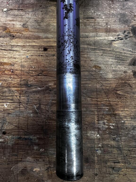

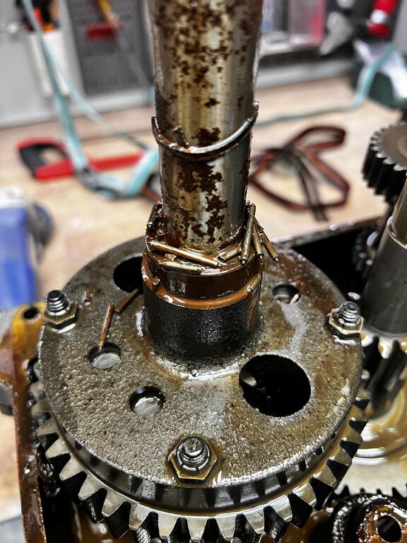

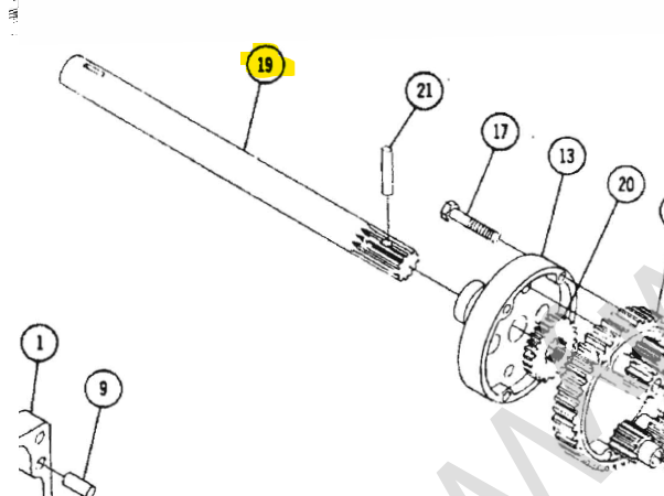

backlash012 61 #11 Posted January 17, 2023 Maybe someone hast an idea were i can get a main axle in europ? 3 Share this post Link to post Share on other sites
Handy Don 13,338 #12 Posted January 17, 2023 (edited) 1 hour ago, backlash012 said: Maybe someone hast an idea were i can get a main axle in europ? Hey, if a member stateside has one, I’m up for being commissioned to deliver it Probably cheaper to ship it though. Edited January 17, 2023 by Handy Don 2 Share this post Link to post Share on other sites
Pullstart 64,452 #13 Posted January 18, 2023 There are 1” (25.4 mm) and 1-1/8” (31.75”) axles, in various lengths. Could you please measure yours and report back? 1 Share this post Link to post Share on other sites
backlash012 61 #14 Posted January 18, 2023 (edited) Hi It is the 1" diameter and 10.5/8" length version. Edited January 18, 2023 by backlash012 Share this post Link to post Share on other sites

Stormin 9,983 #16 Posted January 23, 2023 to Dieter from the UK. I like the disc brake idea. Is it off a bicycle? Share this post Link to post Share on other sites
backlash012 61 #17 Posted January 24, 2023 11 hours ago, Stormin said: to Dieter from the UK. I like the disc brake idea. Is it off a bicycle? No it is from a e-scooter 1 5 Share this post Link to post Share on other sites

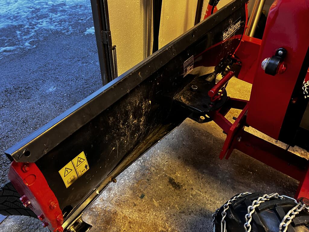

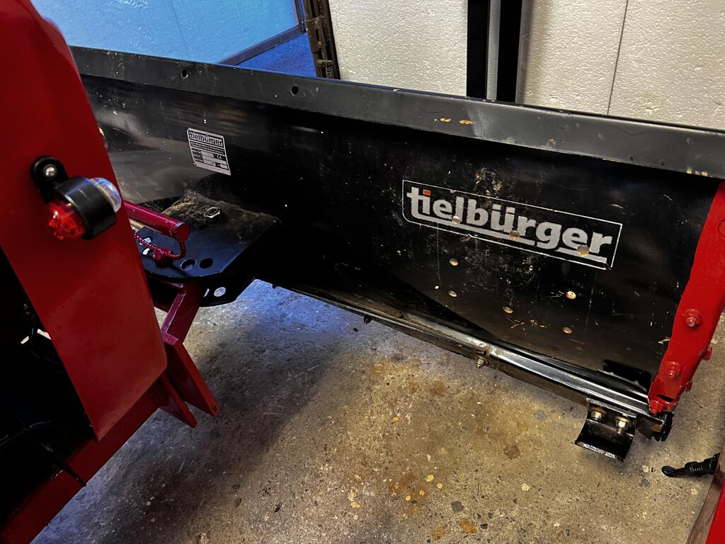

backlash012 61 #18 Posted January 24, 2023 On 1/18/2023 at 9:37 AM, backlash012 said: I will make you a foto of the snow shield, it is for sure custom. This is the snow shield. 3 2 Share this post Link to post Share on other sites
