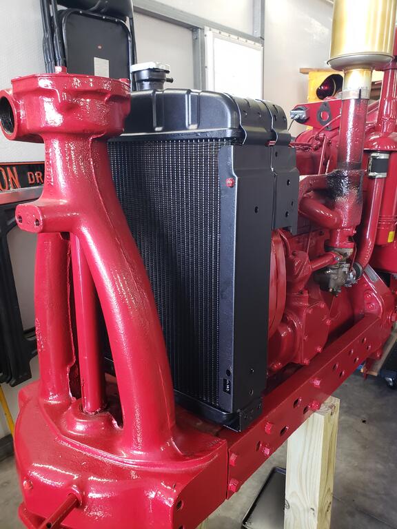

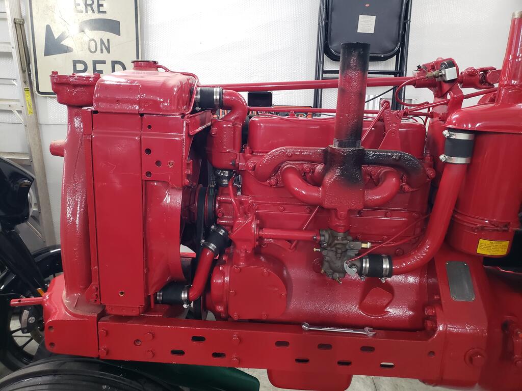

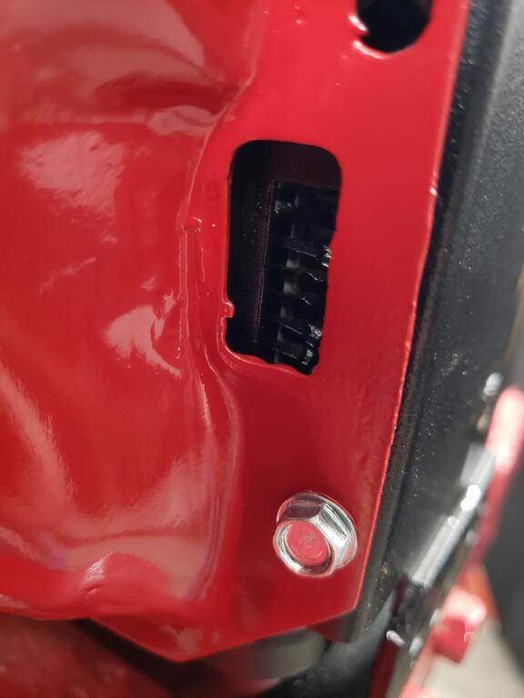

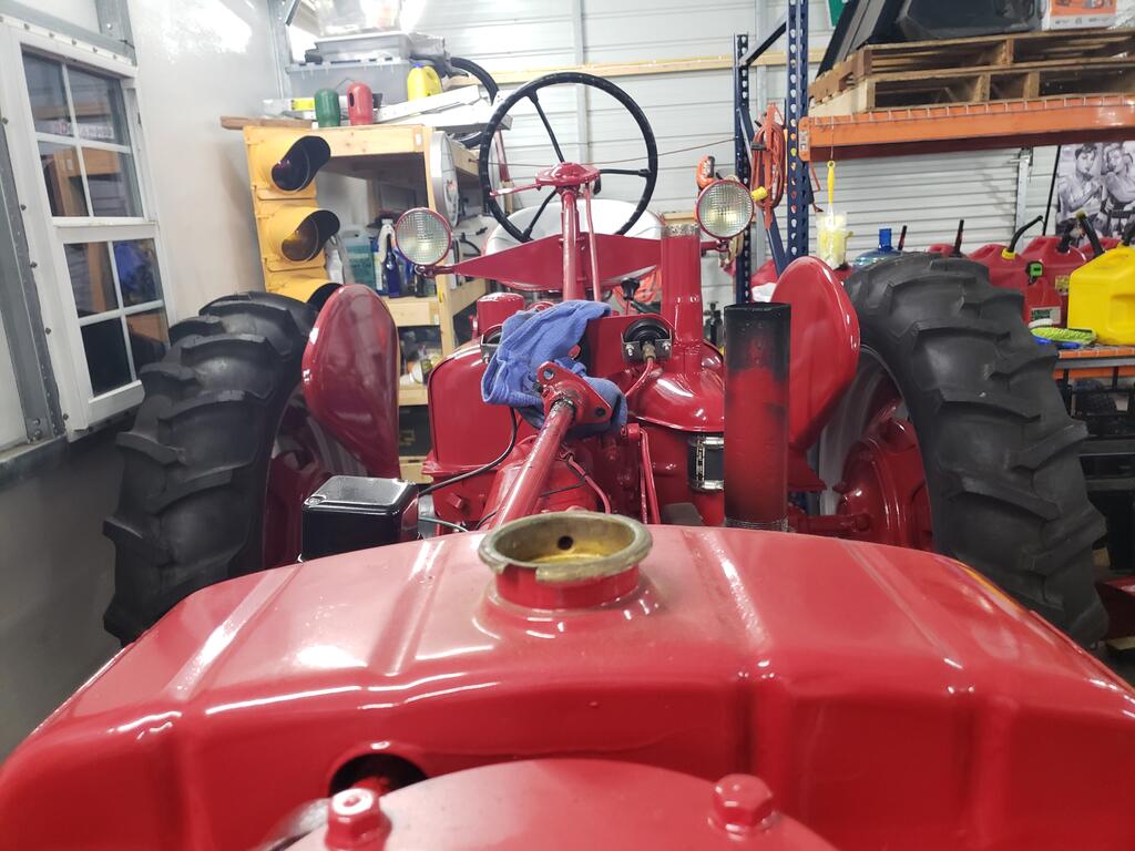

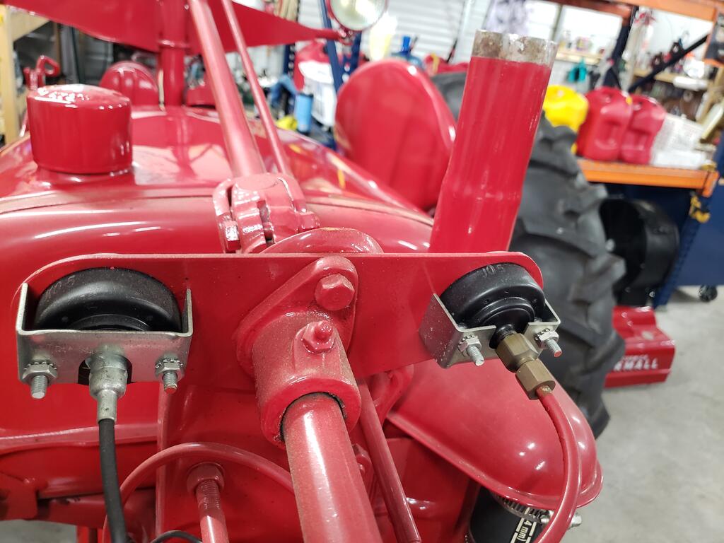

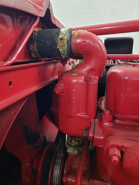

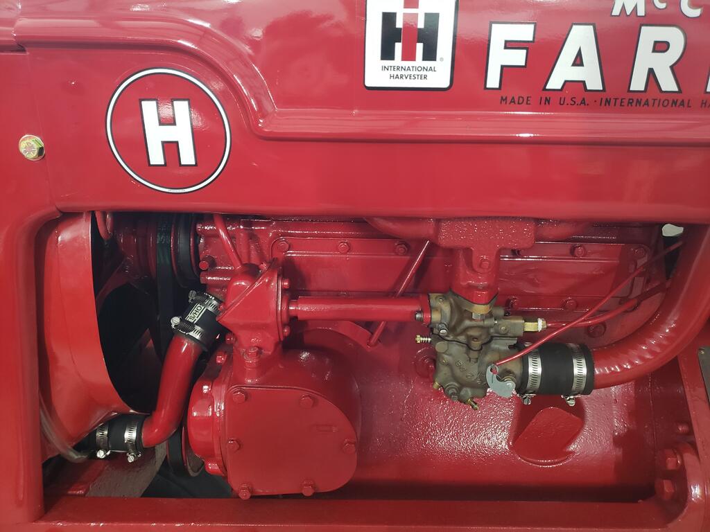

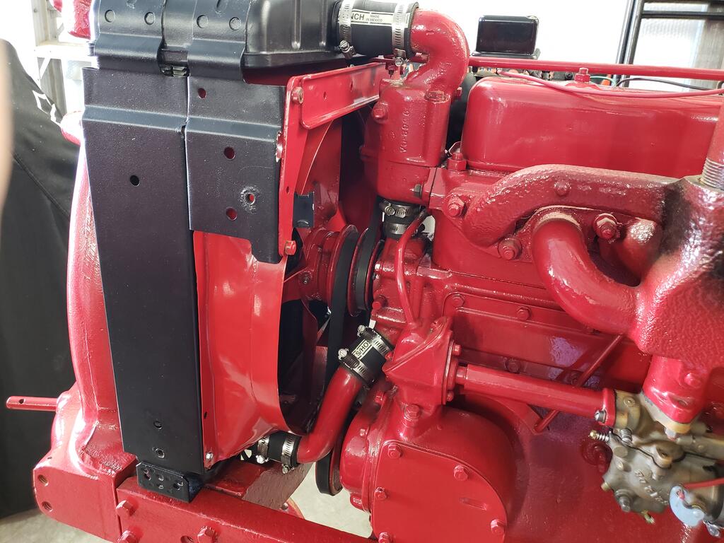

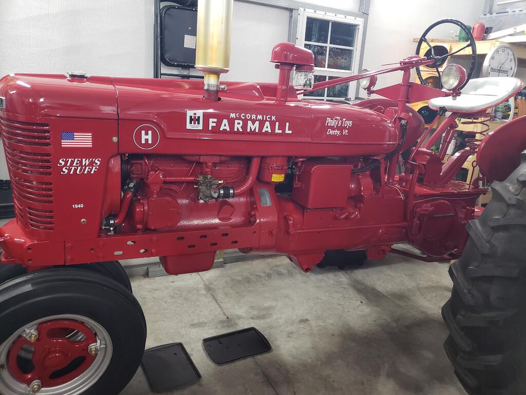

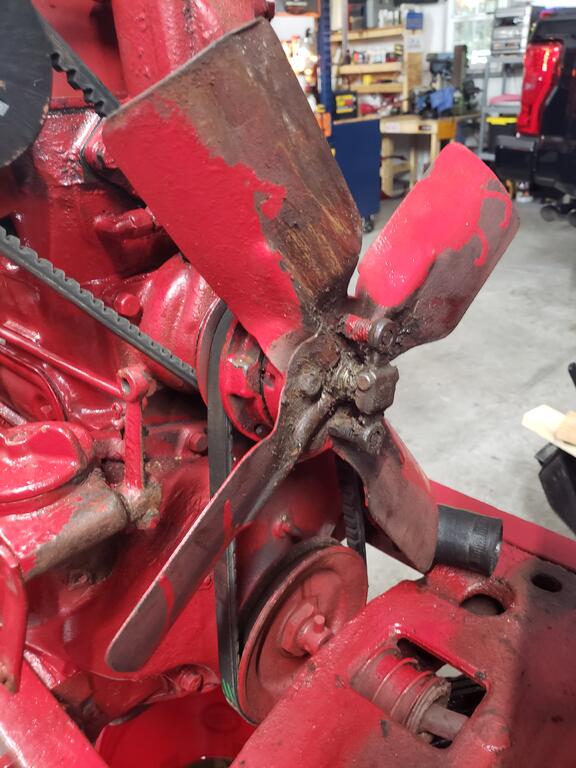

Zeek 2,286 #1 Posted January 13, 2023 This post started being about keys, but was really about replacing a radiator, so I created a new post. The original was here. I finally got this done last weekend and took her for a ride, all good I had to remove all this I cleaned up and repainted some parts like the fan, radiator mount and fan shroud I replaced the front tires while I had the wheels off. Believe it or not I got the best price on these from Walmart, shipped for free to my local store. They are good quality. The brand is "Farm Crop" or something like that an Asian thought would sound good. Overall it came out good, but if you get one of these off of eBay like I did, I'd call it a CLOSE copy. The mounting holes needed modification. I needed new mounting springs because the studs on this were shorter than original. I had to cut bolt access holes for the relocated hole as well as use the cutoff wheel to remove portions of the bracket where it interfered with the hood. Either way it was way cheaper ($360) than getting the original re-cored ($700). Plus, the core is twice as thick on the new version. 11 Share this post Link to post Share on other sites

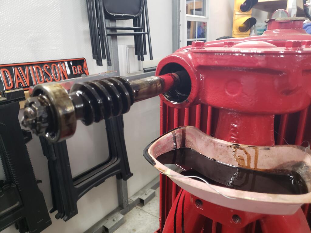

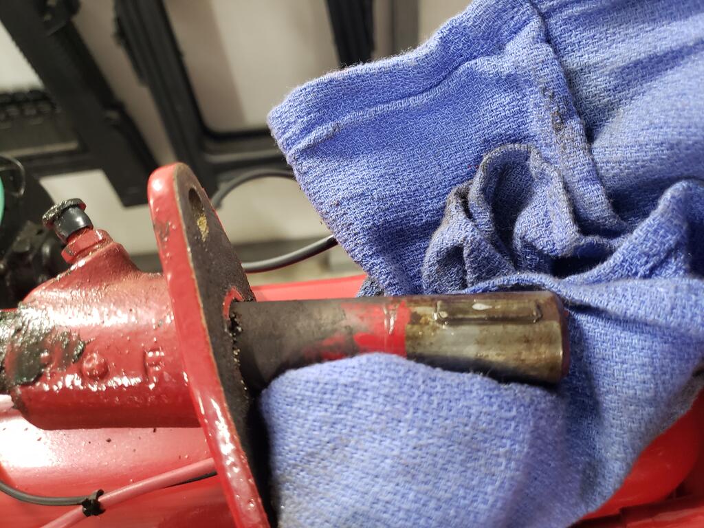

6wheeler 662 #3 Posted January 30, 2023 Nice looking H. I see your steering gear has oil in it. So? I would guess there is a seal under the main gear? (I have never taken an H apart). What weight oil does it take?. I need to pull my steering shaft out of my John Deere A. Unfortunately? The fuel tank leaks. So? I have to take the steering shaft off, to take the hood off, to get the fuel tank off. I don't know what is in there. But? The way it steers? It is either really old grease. Or? No oil. If? That is what it takes. It is nice to see old AG iron getting the resto they deserve. Share this post Link to post Share on other sites
Inspectorjoe 473 #4 Posted February 1, 2023 That's a beautiful H! It makes me miss mine. It was a '42.I still have seller's remorse. 1 Share this post Link to post Share on other sites

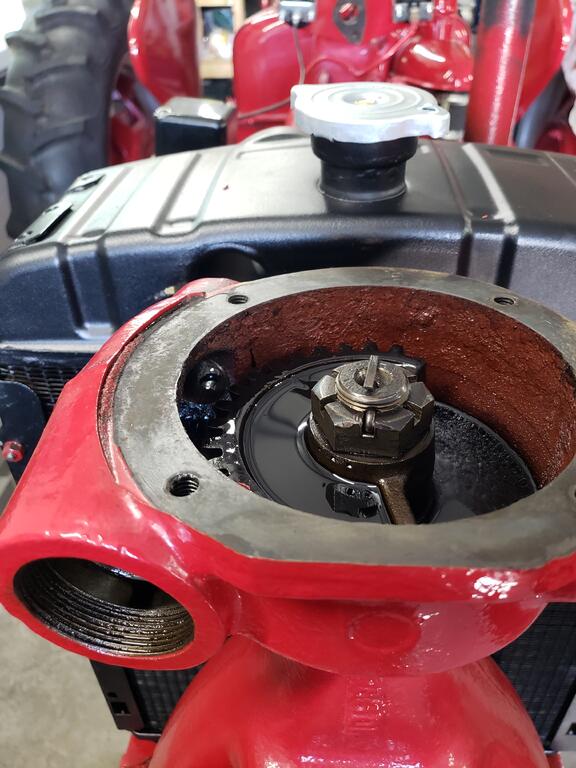

Zeek 2,286 #5 Posted February 2, 2023 (edited) On 1/30/2023 at 5:06 PM, 6wheeler said: Nice looking H. I see your steering gear has oil in it. So? I would guess there is a seal under the main gear? (I have never taken an H apart). What weight oil does it take?. I need to pull my steering shaft out of my John Deere A. Unfortunately? The fuel tank leaks. So? I have to take the steering shaft off, to take the hood off, to get the fuel tank off. I don't know what is in there. But? The way it steers? It is either really old grease. Or? No oil. If? That is what it takes. It is nice to see old AG iron getting the resto they deserve. The steering gear takes 90W gear oil. Yes, it sealed and sits in the little tub where the gear is. The non-power steering versions steer like the old non-power steering cars, it just takes a little more effort. I bought and downloaded the original owner's manual for mine which I found to be extremely helpful. It tells you where everything is, how to adjust it, what weight fluids, etc. In this particular H everything is either 30W or 90W. Steiner Tractor carries almost every single part you could ever need for large antique tractors. Some things (like my radiator) can be purchased on eBay, but you have to watch the quality on some of that. So far everything I got from Steiner was of good quality. Edited February 2, 2023 by Zeek Share this post Link to post Share on other sites
6wheeler 662 #6 Posted February 3, 2023 (edited) 23 hours ago, Zeek said: The steering gear takes 90W gear oil. Yes, it sealed and sits in the little tub where the gear is. The non-power steering versions steer like the old non-power steering cars, it just takes a little more effort. I bought and downloaded the original owner's manual for mine which I found to be extremely helpful. It tells you where everything is, how to adjust it, what weight fluids, etc. In this particular H everything is either 30W or 90W. Steiner Tractor carries almost every single part you could ever need for large antique tractors. Some things (like my radiator) can be purchased on eBay, but you have to watch the quality on some of that. So far everything I got from Steiner was of good quality. . Thanks for the info. Steiner is where I go for a lot of Our older tractor parts. We have 3 JD A's (different ages) 1 B. And? A JD H. My Uncle restores Minneapolis Molines. He has several. Plus a wide front Farmall H. New Paris Tractor is a good place for used parts too. Colfax Tractor is good too. But? It seems they have less and less old parts. Edited February 3, 2023 by 6wheeler Share this post Link to post Share on other sites
