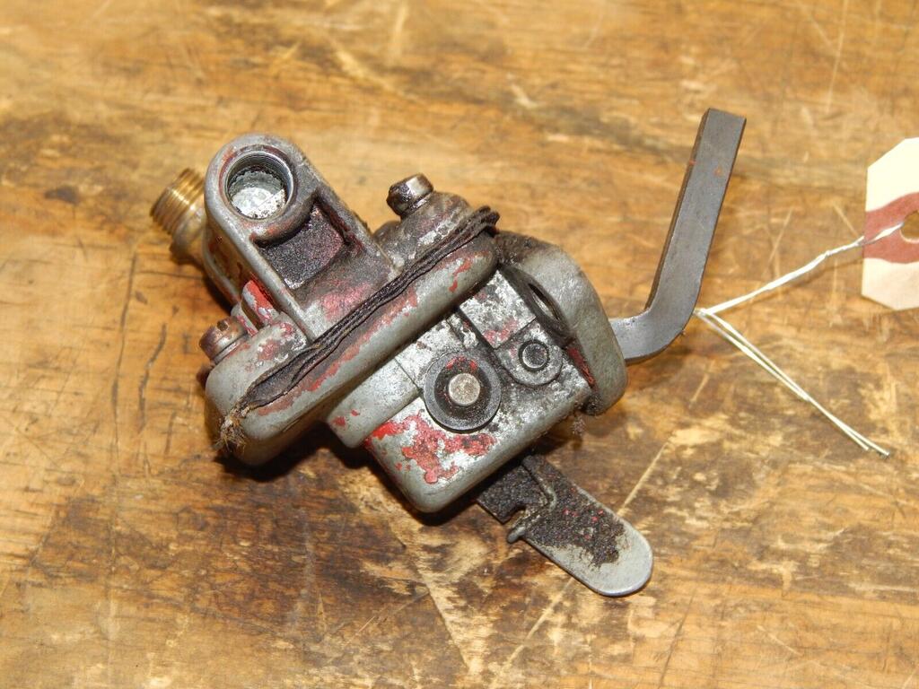

Lane Ranger 11,125 #26 Posted January 13, 2023 Picture of Kohler metal fuel pump with primer arm! 3 1 Share this post Link to post Share on other sites
