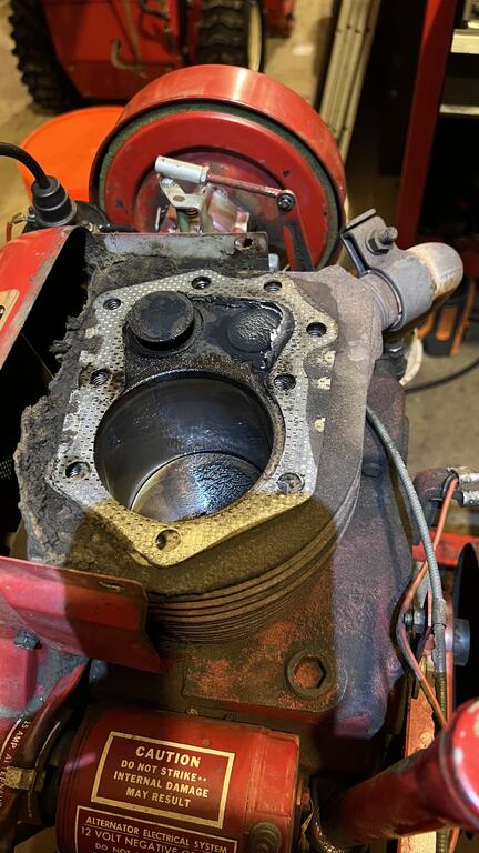

Redav72 231 #1 Posted January 11, 2023 (edited) Just added my third. Do I have a collection now? At any rate it’s got a weird little rough bit when running and I can see wisps of smoke coming out of the carb. I did a carb rebuild and replaced the plug. Is there an adjustment that I need to make? (the beeping is my carbon monoxide sector which apparently works) IMG_6545.MOV Edited January 11, 2023 by Redav72 1 2 Share this post Link to post Share on other sites
Pullstart 64,573 #2 Posted January 11, 2023 Awesome news! A puff out the carb tells me either timing, or possibly a valve cleaning/adjustment is needed. It might be worth pulling the head and inspecting the valves. That rumble could be a carboned up combustion chamber, or could indicate needing carburetor adjustment too. 3 Share this post Link to post Share on other sites

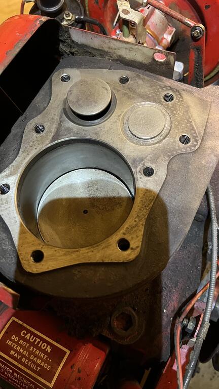

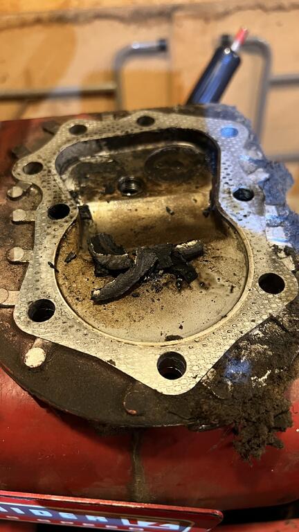

Redav72 231 #6 Posted January 12, 2023 Before and after, got quite a bit carbon out of the combustion chamber. 3 Share this post Link to post Share on other sites
oliver2-44 10,370 #7 Posted January 12, 2023 26 minutes ago, Redav72 said: Before and after, got quite a bit carbon out of the combustion chamber. It looks like the piston had carbon on one side and was clean on part of it. If I recall correctly that is a sign of blowby. I have a k301 like that. It still runs OK, maybe a little power loss and has a small puff of whit smoke on startup. 1 Share this post Link to post Share on other sites
