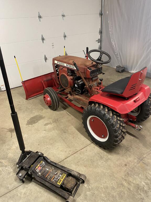

Tonytoro416 1,097 #1 Posted January 9, 2023 (edited) I know this topic has been on and off but I haven’t found exactly what I am looking for. I recently purchased some 23x8.50-12 Carlisle Versa Track tires and put them on my Raider 12. I like the tires and want to put a set on my 416H. Kicker is I think the 9.50 is too narrow and the next size they currently make is 24x12-12. I am not opposed to running a spacer but has anyone achieved this? Pictures plz if so. Also I wonder if I need a 10 or 10.50 wide wheel to keep the tire fairly flat across the tread pattern. I’m not sure 8.50 wide 520 wheels would be the look I would be happy with. As usual you guys will help and I appreciate all of it. Thanks again Edited January 9, 2023 by Tonytoro416 2 Share this post Link to post Share on other sites
ri702bill 8,992 #2 Posted January 9, 2023 You need to consider the true diameter of the rear tire - if too large, it could affect getting a cutting deck level. Interresting front wheel weights - homemade?? Bill Share this post Link to post Share on other sites

Tonytoro416 1,097 #5 Posted January 9, 2023 1 hour ago, ri702bill said: You need to consider the true diameter of the rear tire - if too large, it could affect getting a cutting deck level. Interresting front wheel weights - homemade?? Bill Where are you located ? Share this post Link to post Share on other sites
ri702bill 8,992 #6 Posted January 9, 2023 1 hour ago, Tonytoro416 said: Where are you located ? I'm in Rhode island....... Share this post Link to post Share on other sites
Tonytoro416 1,097 #7 Posted January 9, 2023 28 minutes ago, ri702bill said: I'm in Rhode island....... I’m always interested in wheel weights but I doubt shipping them that far would be economical Thanks tho 1 Share this post Link to post Share on other sites
ri702bill 8,992 #8 Posted January 9, 2023 Confused - I am not interrested in buying them - just wanted to know if they were store bought or homemade. I make my own out of 25 pound flat barbell weights - done 2 sets so far... Bill Share this post Link to post Share on other sites
Tonytoro416 1,097 #9 Posted January 9, 2023 4 minutes ago, ri702bill said: Confused - I am not interrested in buying them - just wanted to know if they were store bought or homemade. I make my own out of 25 pound flat barbell weights - done 2 sets so far... Bill Ohh I’m sorry 😣. The rears are homemade from flat steel. Fronts are actually trolley wheels used in a factory to shuttle molten metal from one end to the other. My grandfather had them. He drilled holes to bolt them on so I guess kind of homemade on those 3 Share this post Link to post Share on other sites
ri702bill 8,992 #10 Posted January 9, 2023 Excellent repurposing of thr trolley wheels - thanks. Bill Share this post Link to post Share on other sites

kpinnc 13,750 #12 Posted January 11, 2023 (edited) On 1/9/2023 at 9:19 AM, ri702bill said: You need to consider the true diameter of the rear tire - if too large, it could affect getting a cutting deck level. Respectfully, I have to clarify. At least as I understand it. So long as the deck is functioning as designed, the tires should have little effect on the deck. Wheel Horse decks "float" seperately from the tractor- at least to the limits of travel. The condition of the guage wheels and attachment rack is far more important. A slack tire on one side or the other can exert pressure if the frame leans enough, but so far as tire size is concerned- if the rack drops down enough to allow slack, you're likely ok. Edited January 11, 2023 by kpinnc Share this post Link to post Share on other sites
ri702bill 8,992 #13 Posted January 11, 2023 3 hours ago, kpinnc said: The condition of the guage wheels and attachment rack is far more important. Agreed - you don't want the gage wheels dancing up against the rear tire.... 1 Share this post Link to post Share on other sites
