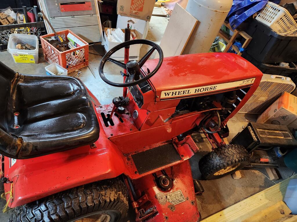

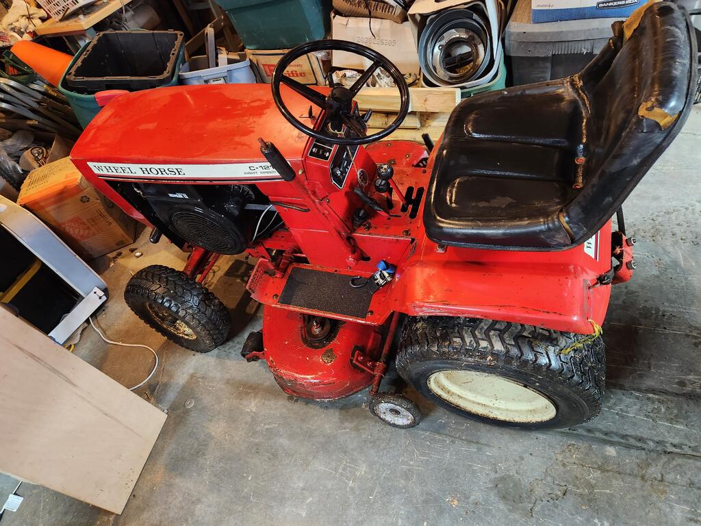

Grumpyjoe 13 #1 Posted January 7, 2023 Bartered for a C121 looks like a 1979. The hood says c121, fuel tank is under the seat and there is a 12hp motor. THe serial/model number on the frame by the motor is 91-08k801 which comes back to a c81? so was the only difference on the c81 and c121 the motor? I am still cleaning things up to get a better idea of what I have. So far it looks better than my Sears l1000 mowers. I can assure you the steering is much stronger. 2 7 Share this post Link to post Share on other sites
Blasterdad 3,037 #2 Posted January 7, 2023 (edited) to They are the same frame & transmission,,,As far as I can tell from your pics someone has put a Magnum engine in it & different front wheels. They either changed the hood or put different stickers on it too... 91-08K801 1979 C Series Garden Tractor C-81 8-Speed Kohler K181S-30700D 8 Wheel Horse 103916 91-12K801 1979 C Series Garden Tractor C-121 8-Speed Kohler K301AS-47648D 12 Wheel Horse 103916 Edited January 7, 2023 by Blasterdad 1 Share this post Link to post Share on other sites
ronwh 190 #3 Posted January 7, 2023 to Redsquare, you have came to the right place. There will be several people along soon to answer your questions. One thing I did notice is that the PTO lever is in the on position which will prevent the tractor from starting. Ron 1 1 Share this post Link to post Share on other sites

Blasterdad 3,037 #5 Posted January 7, 2023 4 minutes ago, ronwh said: One thing I did notice is that the PTO lever is in the on position which will prevent the tractor from starting. PTO lever is off... Share this post Link to post Share on other sites

Sparky-(Admin) 22,036 #8 Posted January 7, 2023 That Magnum 12 is a real nice upgrade! 3 Share this post Link to post Share on other sites
Blasterdad 3,037 #11 Posted January 8, 2023 2 hours ago, Grumpyjoe said: I am absolutely clueless today as to the levers and knobs 2 hours ago, Grumpyjoe said: The front pully mount for the belt feed to mower is bent almost 30 degrees. The lever on the right hand side of the tractor is the PTO. Straight up is off, pushed forward so it is facing the front of the tractor is engaged. @oliver2-44 is right, those pulley's (mule drive) are supposed to be on an angle. You did good! Nice tractor! 1 Share this post Link to post Share on other sites

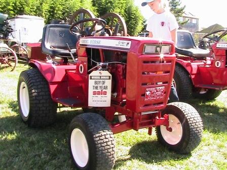

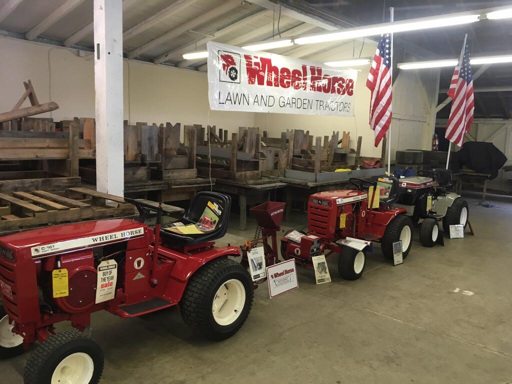

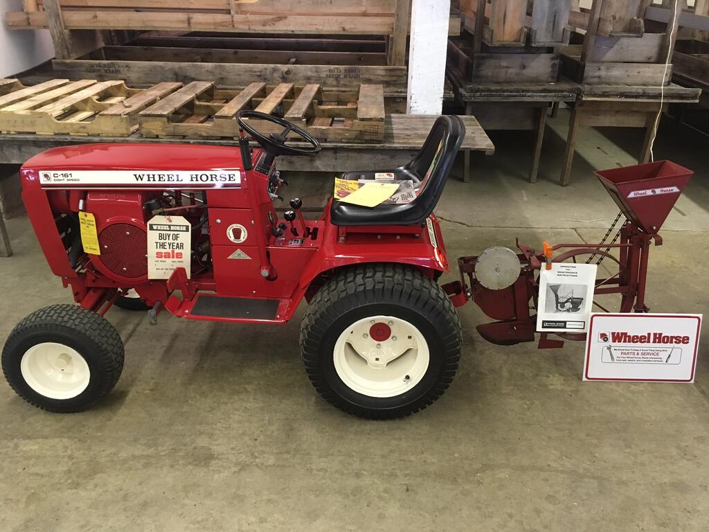

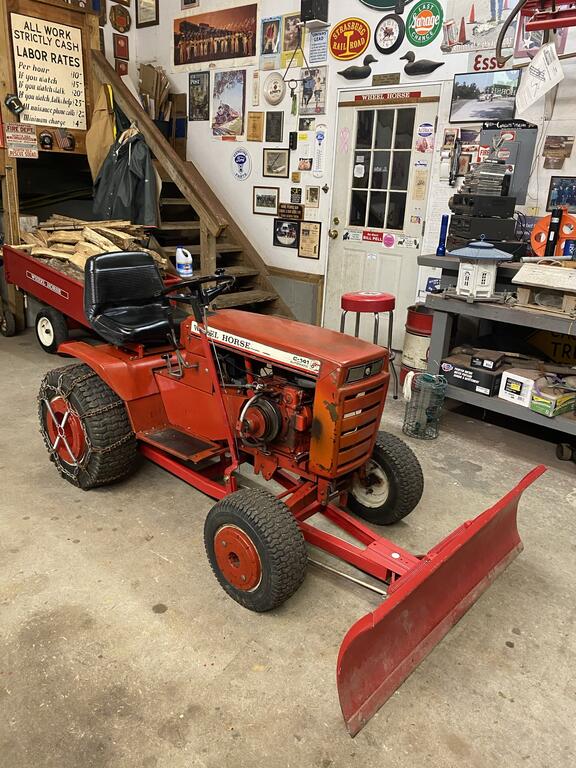

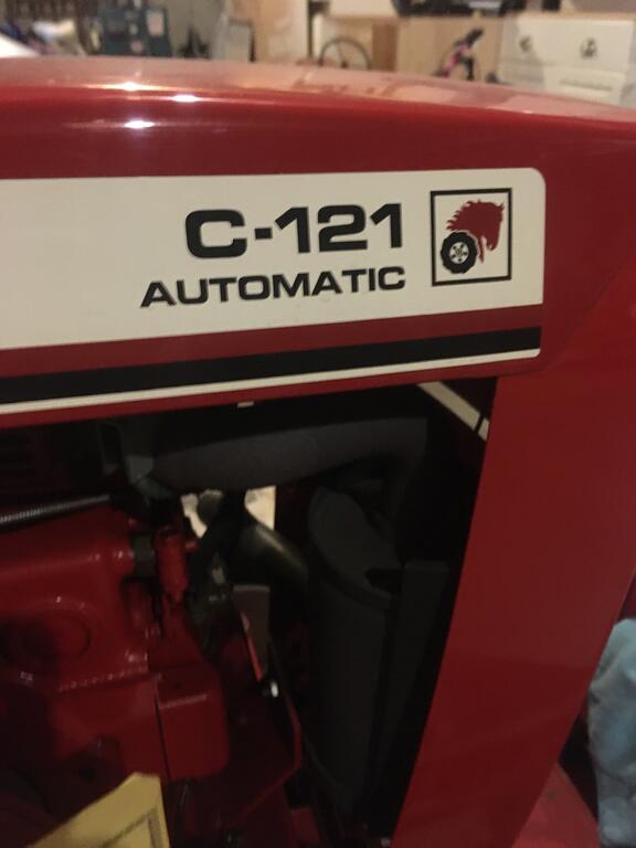

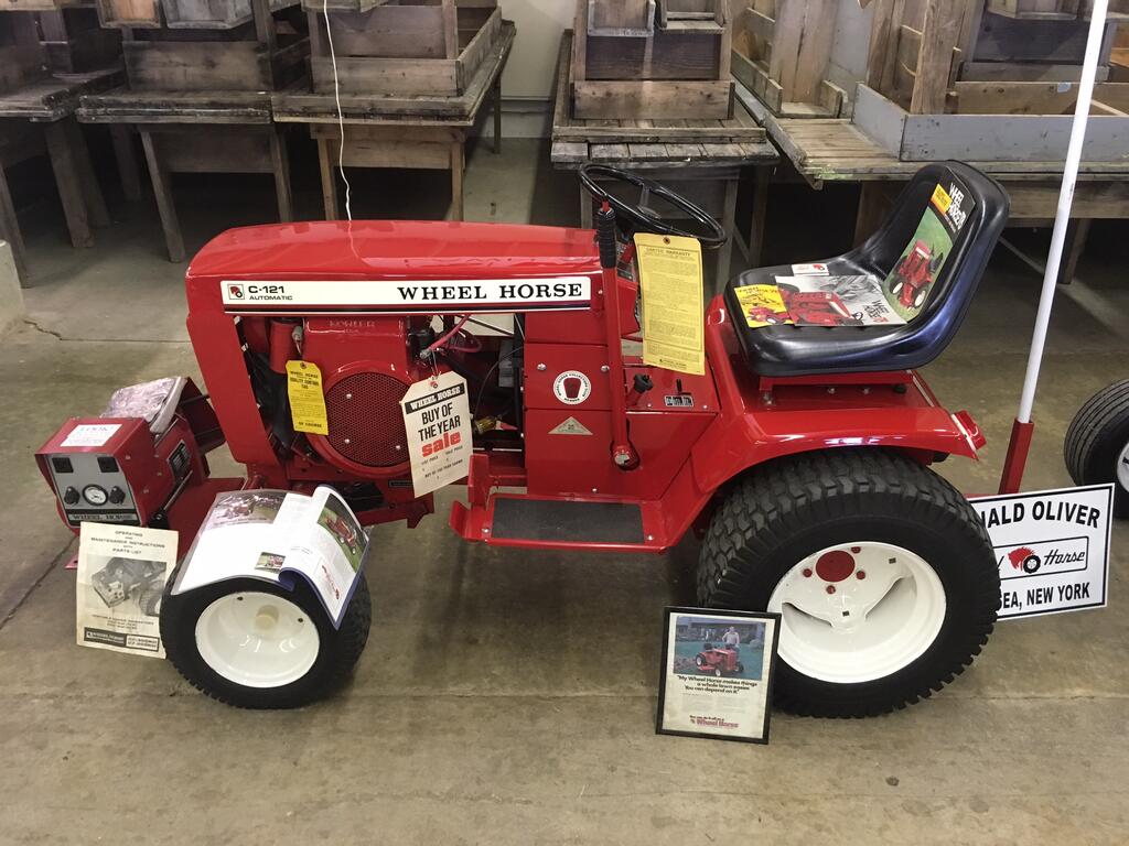

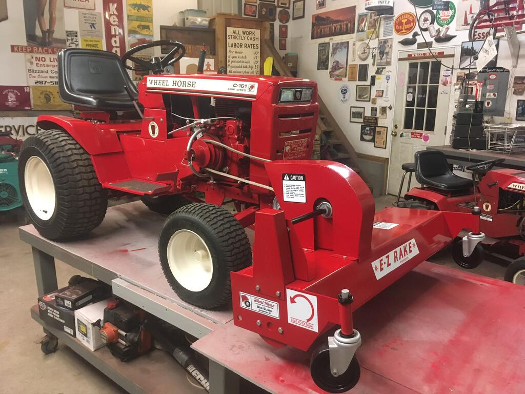

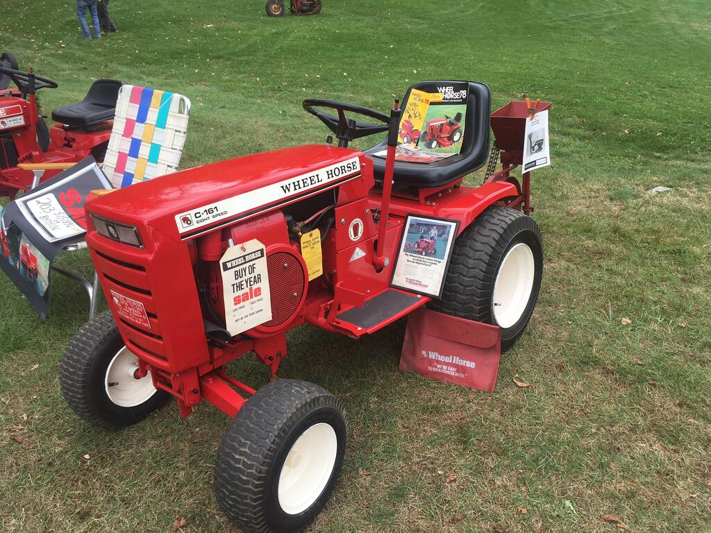

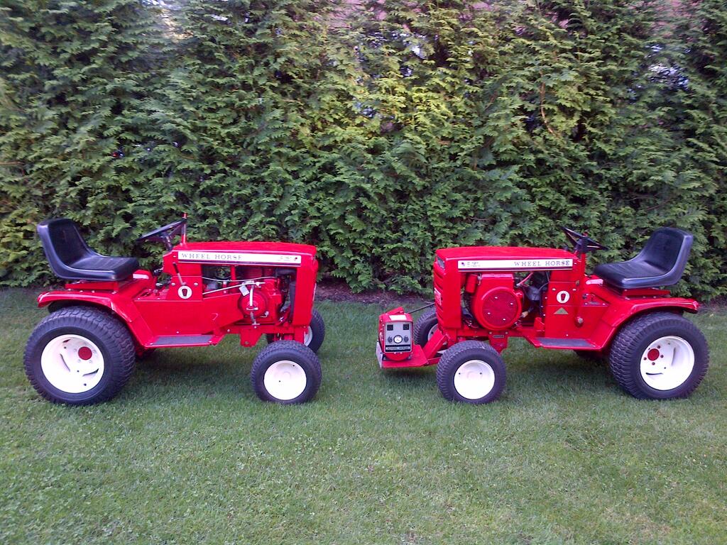

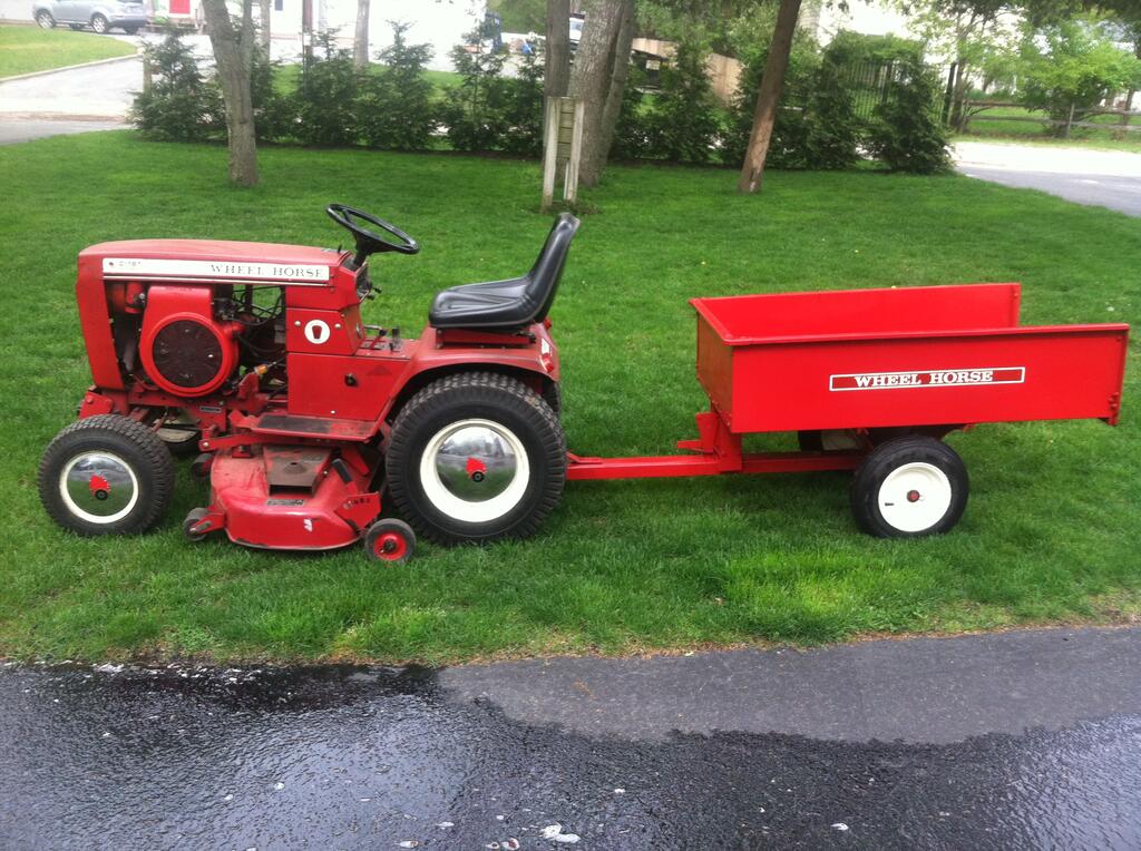

c-series don 9,424 #12 Posted January 8, 2023 My guess is that it started life as a C-81 and someone swapped out the 8hp for a 12hp and changed the hood decals. By the way they are on backwards, I’m not criticizing your tractor please don’t think I am, I’m just letting you know because you said you may repaint it! I’ve said it here before many times, the 78-79 C-series and some of my favorite Wheel Horse tractors ever made! I have almost all of them except the C-101. Here are a few of them. 2 1 Share this post Link to post Share on other sites
clueless 3,110 #13 Posted January 8, 2023 The front pulleys (mule drive) for the deck drive belt are angled at 30 degrees to the right, somewhere between 1 and 2 o'clock when sitting on the tractor. Also the 12 hp is a mag ignition, and the original engine was a battery ignition system make sure you know the difference before working on the electrical system, you could fry that nice 12 hp. 1 Share this post Link to post Share on other sites
Grumpyjoe 13 #14 Posted January 8, 2023 C Series Don, I saw your twins already. Very nice. I really like the seed planter setup. I wonder if I will ever find one again? Couple of nice friends with old tractor yards I will ask to keep an eye out. Was there a model number or anything about it that might help? Even at 60 years old I can learn a few things. Avid mechanic and handyman. I love working on things and the older things make me happier. Many of the old tractors nearby get cut up into racers. If I can I will grab a couple more just for giggles. First off I need to get this one going by April. We mow twice a week April thru August. Having this little guy help will be nice. After we replant the yard I will post the tractor shed and garden. SOme will get a real kick out of it. 3 Share this post Link to post Share on other sites
WHGuy413 2,771 #15 Posted January 8, 2023 Nice looking tractor. As stated before the 12hp magnum was an upgrade. My son has a c-121. They are definitely great work tractors. His plans are to mow with his this spring too. 1 1 Share this post Link to post Share on other sites
