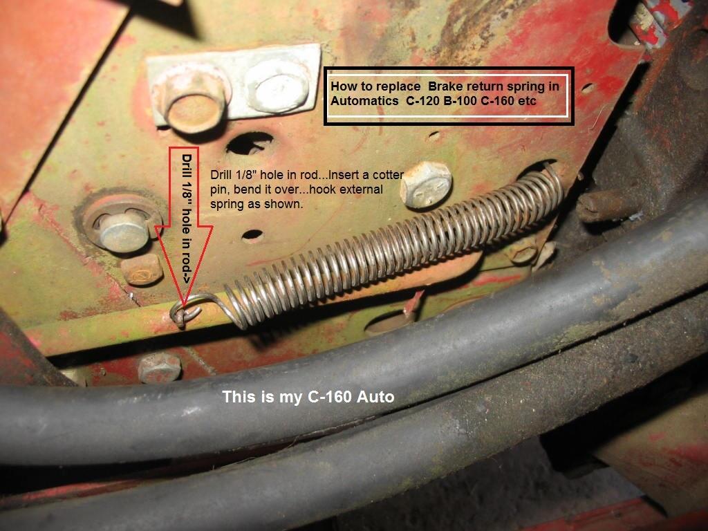

whman01 15 #1 Posted January 4, 2023 The brake pedal on my C-160 falls down and stays down. I found a small return spring unhooked and reattached it but the spring seems too long and will not return the pedal to the upright position. Has anyone come up with a solution for this? 1 Share this post Link to post Share on other sites
daveoman1966 3,881 #2 Posted January 4, 2023 (edited) Solution... NOTE... Instead of drilling the 1/8" hole, one could use a small HOSE CLAMP on that rod, then connect the spring to that clamp.. Edited January 5, 2023 by daveoman1966 4 1 Share this post Link to post Share on other sites

pfrederi 19,266 #4 Posted January 4, 2023 1 hour ago, whman01 said: The brake pedal on my C-160 falls down and stays down. I found a small return spring unhooked and reattached it but the spring seems too long and will not return the pedal to the upright position. Has anyone come up with a solution for this? Daveoman has a great fix shown above. If you feel you need originality (and have a streak of masochism) I have a spring that I have used I can give you one. Share this post Link to post Share on other sites
c-series don 10,777 #5 Posted January 5, 2023 I tried replacing the original spring on my C-160 and it is damn near impossible. I then used Dave’s method and it took 5 minutes to fix. I did this a few years ago and it still works great. Very funny to me that this comes up because just YESTERDAY I fixed my neighbors Bronco 14 with the same method! @daveoman1966 Thanks Dave!! 3 1 Share this post Link to post Share on other sites
