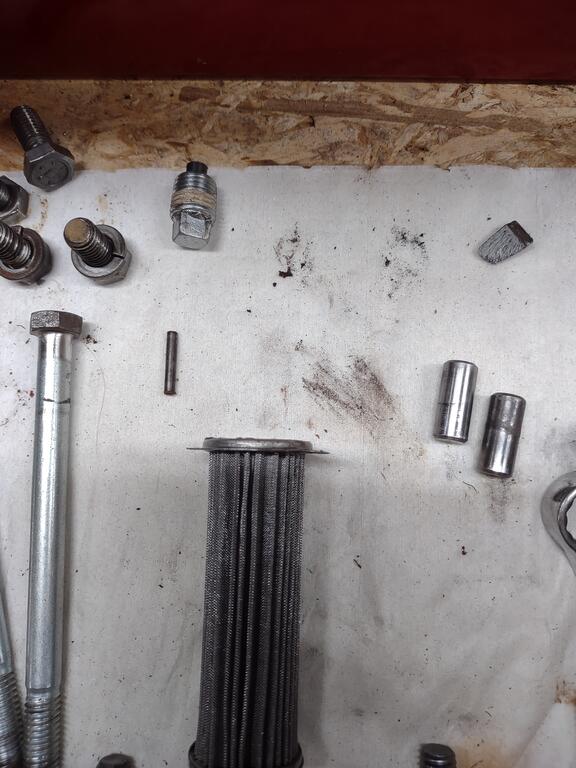

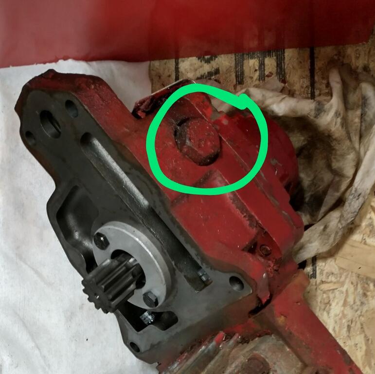

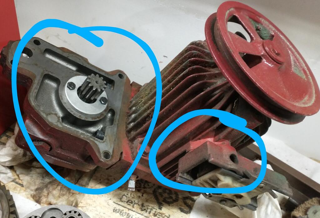

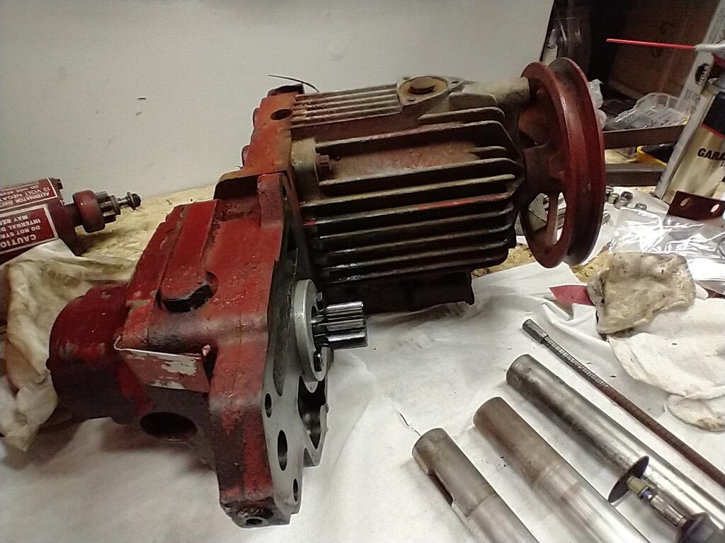

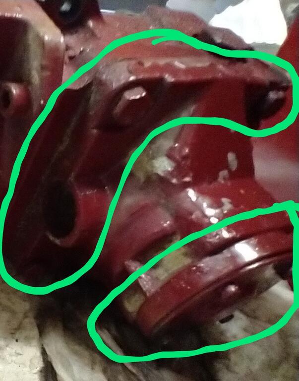

ebinmaine 70,679 #1 Posted January 3, 2023 Folks I need some parts help and also advice on what (if anything) to do next... I have the gasket and orings circled in blue. Zoom in on the nut at topside lower left here: It's also circled in green here: I believe that nut/bolt head is seeping some judging by the staining. I'm also wondering if there are gaskets here: They don't appear to be leaking but I'm in there. Lastly.... This transmission had some metal chips/filings in the base pool of fluid because of a bad bearing. That said, it was driving fine with plenty of pull both forward and reverse. Is there something else I should be opening up while it's off the tractor ? 1 Share this post Link to post Share on other sites
Ed Kennell 40,455 #2 Posted January 3, 2023 @daveoman1966 may be able to help Eric. 1 Share this post Link to post Share on other sites
daveoman1966 3,807 #3 Posted January 3, 2023 The 3 items marked in GREEN are (1)gasket 200191 (2) O-ring 973500 and (3) big O-ring 970132. All 3 are identified here in the HYD PUMP Excel SS. If you can't find them on-line, I probably have them in my shop. MOTOR 90-1136, 37, 40.xlsx 2 2 Share this post Link to post Share on other sites
ebinmaine 70,679 #4 Posted January 4, 2023 1 hour ago, daveoman1966 said: The 3 items marked in GREEN are (1)gasket 200191 (2) O-ring 973500 and (3) big O-ring 970132. All 3 are identified here in the HYD PUMP Excel SS. If you can't find them on-line, I probably have them in my shop. MOTOR 90-1136, 37, 40.xlsx 51.01 kB · 3 downloads Dave if you do have them I'd be interested in purchasing them from you. 1 Share this post Link to post Share on other sites

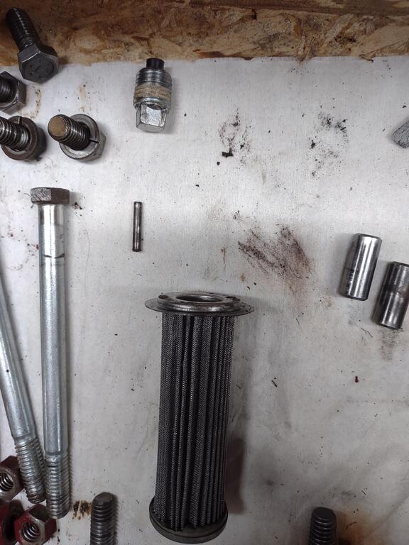

sjoemie himself 3,072 #5 Posted January 4, 2023 Regarding the chips/filings.. might not be a bad idea to install a magnetic (drain-)plug somewhere. That way if something lets loose it will most likely end up on the magnet instead of floating around through who knows what. Also an easy way to check if something might have excessive wear going on when servicing fluids.. 1 Share this post Link to post Share on other sites
ebinmaine 70,679 #6 Posted January 4, 2023 1 hour ago, sjoemie himself said: Regarding the chips/filings.. might not be a bad idea to install a magnetic (drain-)plug somewhere. That way if something lets loose it will most likely end up on the magnet instead of floating around through who knows what. Also an easy way to check if something might have excessive wear going on when servicing fluids.. Yessir. The standard Wheel Horse strainer has a magnet on it already. I'll be installing a magnetic drain plug. I've also considered drilling and tapping for a second drain plug forward of the middle hump because I want to run this tractor for a few hours and change out the fluid again. I've also considered placing a neodymium magnet... Somewhere... 1 1 Share this post Link to post Share on other sites

daveoman1966 3,807 #11 Posted January 4, 2023 18 hours ago, ebinmaine said: Dave if you do have them I'd be interested in purchasing them from you. I'll have a look-C in the am... What is your mailing address....? I will send you a NEW O-ring # 970132...no charge. I have 5 or 6 of them I don't have the gasket 200191 or the smaller O-ring 973500 Source those from Wheelhorse Parts N More... on Red Square. 1 1 Share this post Link to post Share on other sites

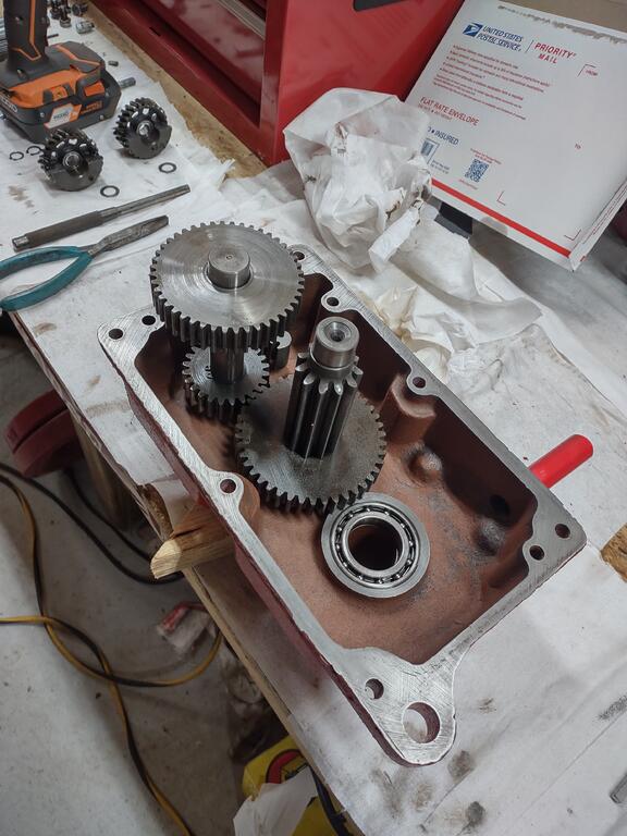

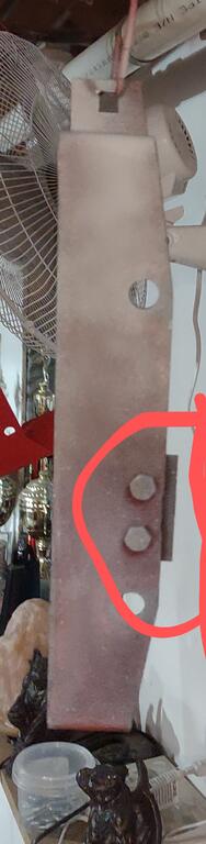

ebinmaine 70,679 #18 Posted January 5, 2023 Trina has been soaking and cleaning and soaking and cleaning on the cable housing for the rear lift. It's pretty well cleaned right out. She spent some time sanding down the bracket at the front of the seat pan that catches on the latch. First thin coat of primer. Note the circled part where I modified the bracket so the latch... Would. I ground the keyway groove a bit but wasn't sure about the straight-osity of the cut so I left it for another day. The gears are set in the transmission housing. Somehow or another the internal metal strainer was bent around the outside lip. I got that de-bendeded. 1 Share this post Link to post Share on other sites
