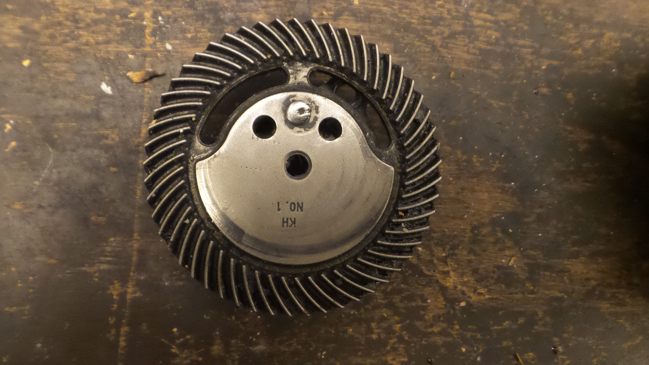

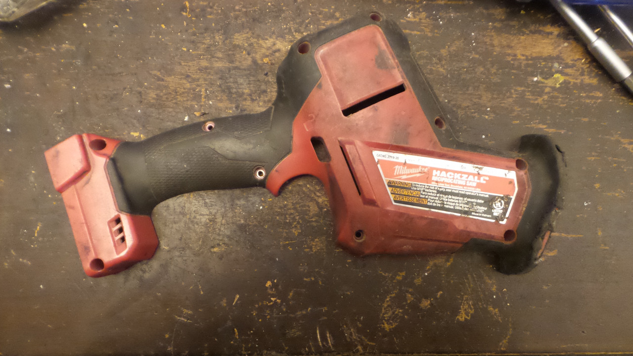

bc.gold 3,403 #1 Posted January 2, 2023 Milwaukee M18 Fuel Hackzall needs a doctor. Removing the gear to replace the broken drive pin is a PITA and the bearing still has to be removed to drive out whats left of the pin. Read this carefully, the gear did not have to be removed, as you can see the manufacture has anticipated this pin failure and has conveniently provided a pair of extra holes. Yea grind the old pin flat to the face of the gear then install the new pin in a vacant hole. Your back in business. Three strikes your done, you'll have to remove the gear and bearing to clear the holes for another round. The screws are a treat, I found that you have to push upwards on the bearing to keep the height of the counterweight above the screw heads. But as you can see this was totally unnecessary to remove the gear. In my next yard sale, all my Milwaukee junk will be on the bargain table. Share this post Link to post Share on other sites
bc.gold 3,403 #2 Posted January 2, 2023 The lubricant a sticky almost dry graphite compound does not perform well in sub zero weather. I believe this to be the cause of the drive pin failure. 1 Share this post Link to post Share on other sites

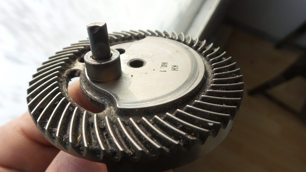

bc.gold 3,403 #3 Posted January 2, 2023 (edited) Drive pin is NA from Milwaukee but the drive roller is. The cure. Drill Rod is a round metal bar stock made from tool steel that has been ground and polished to tight tolerances. It is generally supplied unhardened and is therefore readily machine workable making it an ideal product to use to manufacture tools. Edited January 2, 2023 by bc.gold 2 Share this post Link to post Share on other sites

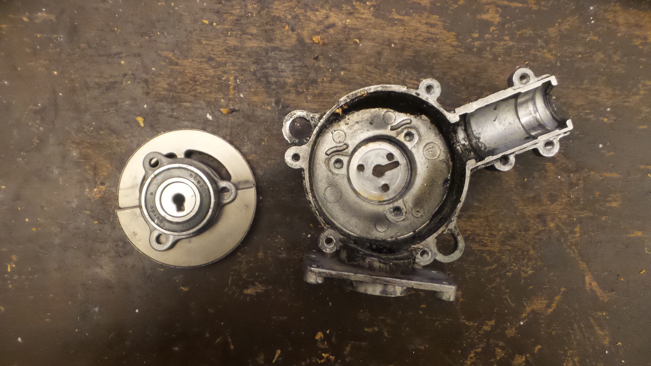

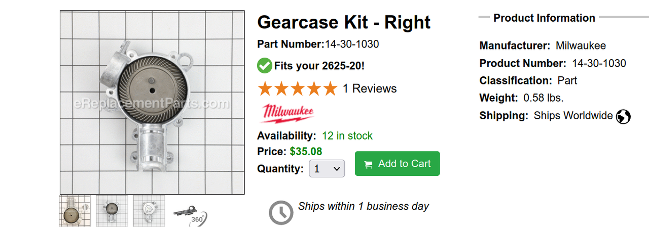

bc.gold 3,403 #4 Posted January 21, 2023 Stopped in at the Milwaukee warranty depot in Brandon MB, was informed I would have to purchase the whole gear case and that i would be better off economically too purchase a new Hackzall. I asked if the pin wearing out was a common problem, yes he replied. Next stop Princes Auto our Canadian version of Harbour Freight, purchased some small zip cut off wheels for the Dremal these will be used to trim the drill rod I plan to use to replace the worn out pin. I addition will pack the gear case with a better lubricant, make a gasket and put everything back together. The Hackzall has less than 50 hours on it, have other Milwaukee M18 tools, multiple chargers and battery's so I'm not about to send everything into the trash just yet. 2 Share this post Link to post Share on other sites
bc.gold 3,403 #5 Posted January 21, 2023 (edited) Corn head grease. One side of the gear case comes with the gear and drive pin installed. Making an observation the drive pin is located closer to the centre line, shorter stroke less stress on the drive pin, a ha ha gotcha moment from the manufacture. My GF vibrator has a longer stroke. o Edited January 22, 2023 by bc.gold Share this post Link to post Share on other sites
bc.gold 3,403 #6 Posted January 22, 2023 (edited) All that's left to do, trim the pin then reassemble the Hackzall with some good grease. Had to heat the gear to install the pin, $6.00 cobalt drill. Edited January 22, 2023 by bc.gold 1 Share this post Link to post Share on other sites
