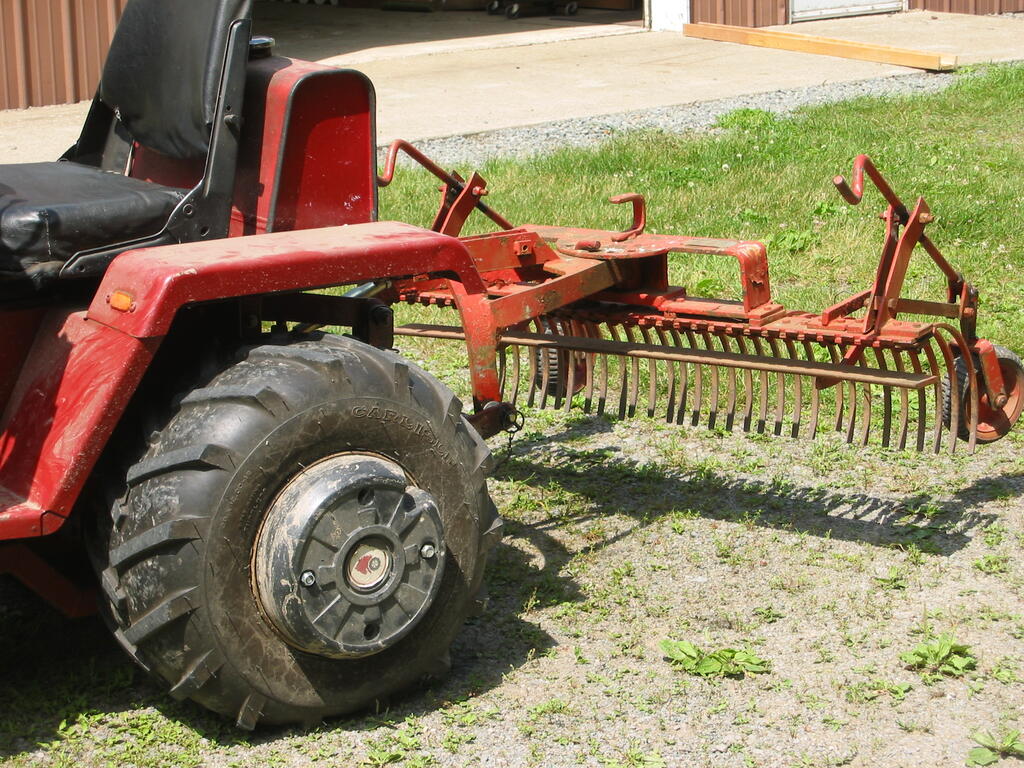

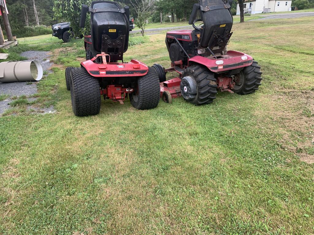

littleredrider 409 #9 Posted January 1, 2023 I have 24x12x12 on 520 rims. They look like a fat 23". Pics somewhere.... 2 Share this post Link to post Share on other sites
Tonytoro416 1,097 #10 Posted January 1, 2023 17 minutes ago, littleredrider said: I have 24x12x12 on 520 rims. They look like a fat 23". Pics somewhere.... I was thinking guys have done it. Pictures would be appreciated 1 Share this post Link to post Share on other sites

littleredrider 409 #12 Posted January 2, 2023 5x4.5. Funny, the wheels off my D-250 fit lol. They have close if not the same offset, and are 10" wide. Forgot to post pics... 1 Share this post Link to post Share on other sites
littleredrider 409 #13 Posted January 2, 2023 The tires are slight different size. One on left is new, right one is older, dunno when was made. 5 2 Share this post Link to post Share on other sites

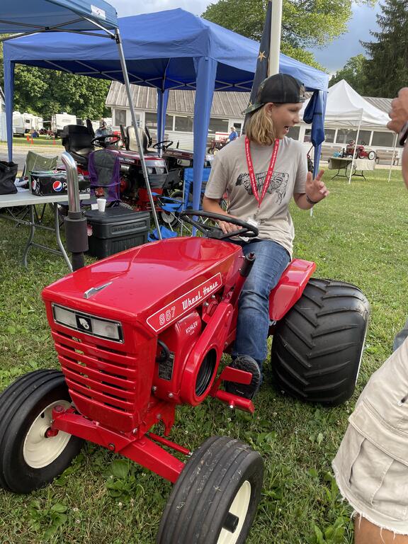

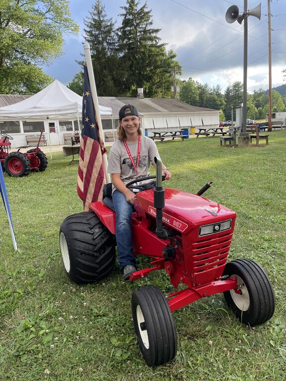

Pullstart 64,582 #15 Posted January 3, 2023 @Howard dellapuca / @857 horse Knows a guy who makes super wide wheels. I don’t think he’s on here but they were selling at the Big Show in ‘22. Here he has a set of tires stretched on a super wide wheel. He was explaining something to my daughter about the seat… they were good buddies all through the show! 2 5 1 Share this post Link to post Share on other sites

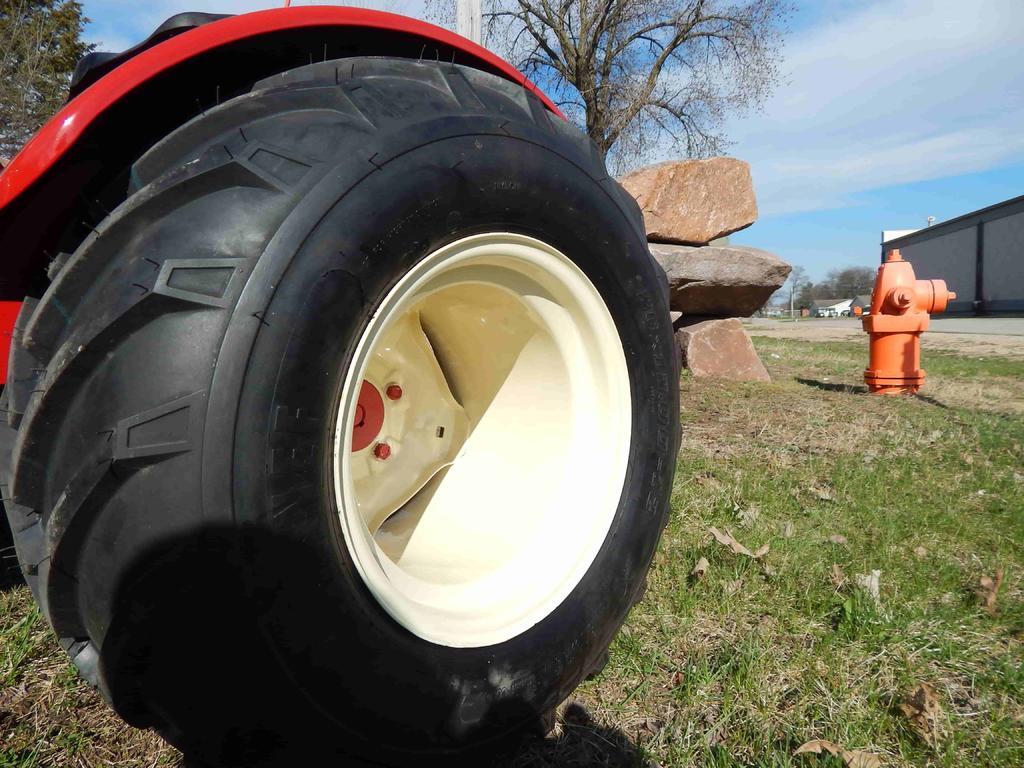

Achto 28,794 #18 Posted January 3, 2023 On 12/27/2022 at 6:52 PM, Tonytoro416 said: Any thoughts or someone already done so? I took four 7 1/2" wide rims and cut them apart to make two 11 1/2" rims. One set of the rims did not have the correct off set for a , this didn't matter cause I was going to cut the centers out of them anyway. I marked them on the inside where I wanted to make my cut. To get the cut strait I jacked a tractor up, bolted the rim on, fired the tractor up, put it in high gear to spin the rim, then made my cut with a 4 1/2" grinder with a cutting wheel on it. "My Red Neck Lathe" After the cuts were made I removed the center from 2 of the rim halves & welded the rims back together. Followed by grinding the welds smooth inside and out. Leak detector spray showed that my welds were sealed air tight but I decided to run tubes any way. When completed I fit the rims with 26x12x12 tires. Here is one other more expensive option. Rim blank and the center disc will allow you to adjust the off set to your liking. https://www.millertire.com/products/wheels-by-type/lawn-garden-wheels/12x10-5-rim-blank/ https://www.millertire.com/products/wheels/lawn-garden-wheels/12-rim-center-disc-5-hole-concave/ 2 4 Share this post Link to post Share on other sites

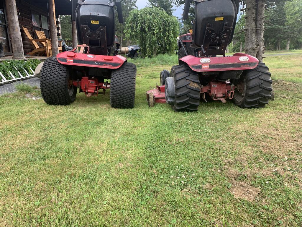

Titus105 0 #22 Posted August 6, 2024 On 12/31/2022 at 2:51 PM, pfrederi said: WH used the 24 x 12 x12 tires on the D series. the rims were 10.5 wide: (6 lug) I think true to size 24 x 12 x 12 would look very bulgy on 8.5. The look fat on the 10.5. Now maybe a Deestone which run very small??? I have a d250 that came with 26×12-12. They look tall . Share this post Link to post Share on other sites
Thor27 832 #23 Posted August 7, 2024 (edited) On 12/31/2022 at 12:51 PM, pfrederi said: If you blow up picture those are 26x12-12. Edited August 7, 2024 by Thor27 Tried to delete Share this post Link to post Share on other sites
