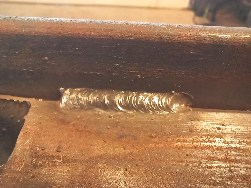

Pullstart 64,603 #2 Posted December 26, 2022 7 hours ago, ClassicTractorProfessor said: I have this disease that makes it almost impossible to buy the one thing I came for in Harbor Freight (or any other tool store for that matter) I think I have that, but it spread to my Horse shoppin’ muscle too! congrats Bryce, where’s the picture of the beads? 6 Share this post Link to post Share on other sites

ClassicTractorProfessor 5,366 #5 Posted December 26, 2022 1 hour ago, Pullstart said: I think I have that, but it spread to my Horse shoppin’ muscle too! congrats Bryce, where’s the picture of the beads? If I get time today I'm gonna play around with it some more and I'll get some pictures then...kind of embarrassed to show what I did yesterday...we were in the wife's pickup when we came over here instead of my welding truck, so I didn't have my good hood with me...used the one at the shop but my blind eyes can't see to weld real well without my cheaters 2 2 Share this post Link to post Share on other sites

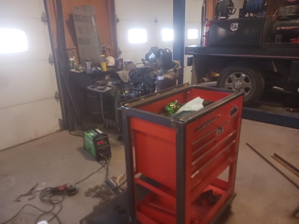

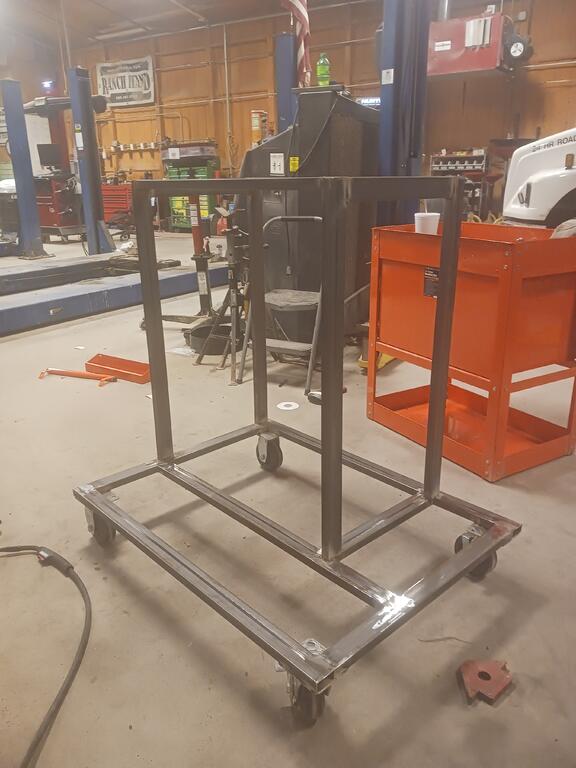

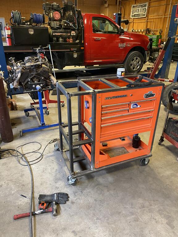

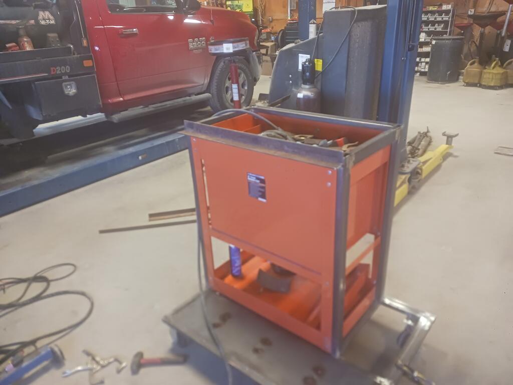

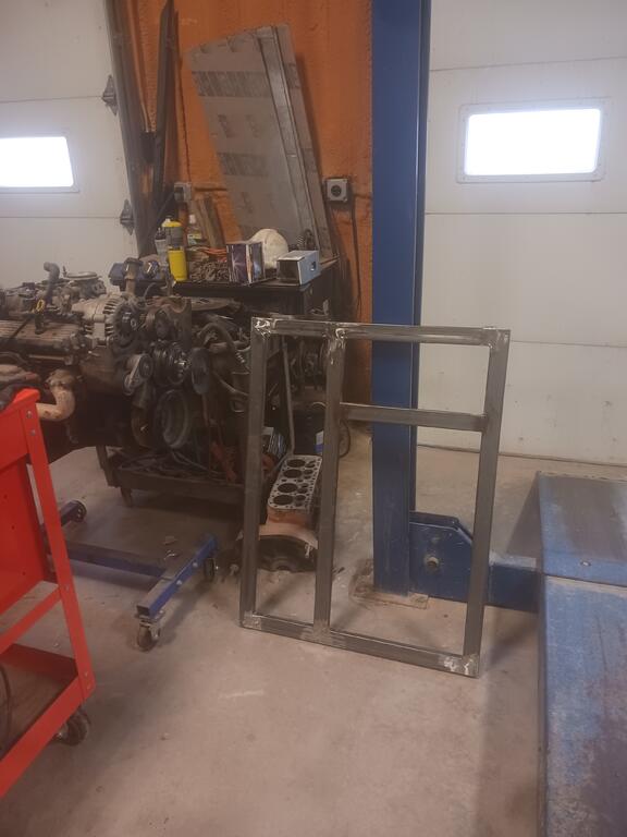

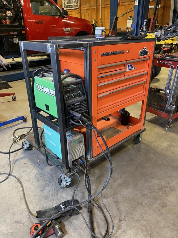

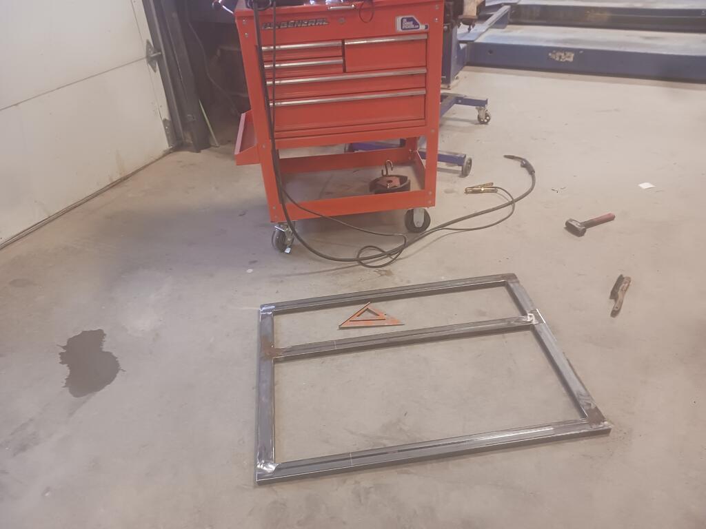

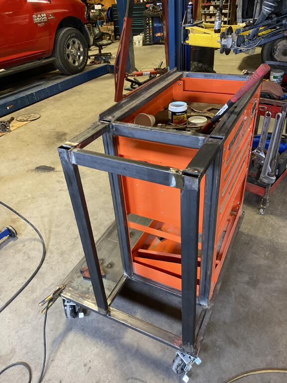

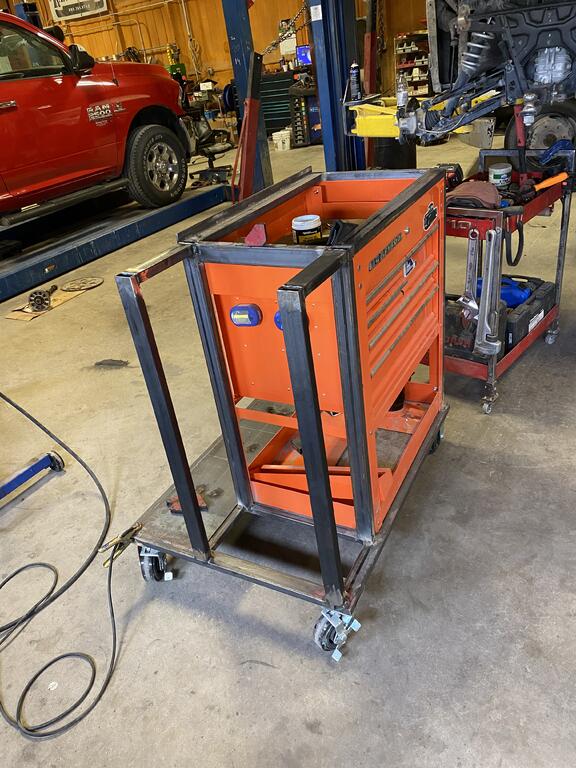

ClassicTractorProfessor 5,366 #10 Posted March 18, 2023 Been messing around with the welder quite a bit in my spare time the past couple months, and I must say that I am impressed. Once you play around with the settings and find the sweet spot for what you are welding, the little machine works extremely well. Still haven't ran any solid MIG wire through it yet, but running flux core it welds really smooth. Haven't gotten it set up to try TIG yet, but I did play around with the stick feature a little bit, welded a few pieces of scrap together with some 3/32" 6011. It could be used for light repairs with stick electrodes, but I wouldn't recommend it as a machine if one is primarily looking for a dedicated stick welder. Which is fine as most of my stick welding is done with the old faithful Miller on the truck anyway. One of the first projects I have been working on with the new machine is a rolling cart and workstation which will hold said machine, as well as the YesWelder Cut55-DS plasma cutter I purchased last month. I looked at several of the welding carts sold at various retailers, but none of them offered all the features that I wanted, so I opted to build my own. I started with a US General 5 drawer roll cart, and began by removing the handle, top lid, and casters. I then began building a rolling frame out of 14 gauge 1"x2" rectangular tubing that cages the original box. I then reinforced the rear part of the cart behind the box, and covered it with a piece of 1/8" plate, this area will hold up to 3 125cf gas cylinders. The space to the left of the box will have shelves built for the welder and plasma cutter to sit on. And finally a close up of one of the beads laid with this little unit running flux core wire. Hope to get this cart finished soon, I ran out of 1x2 tubing due to a midway design change. Steel supplier is 40 miles away, and only open M-F 8-5, which really sucks as I work M-F 8-5. Probably have to take the wife's pickup to work one day and send her to the steel supplier with my welding truck and trailer to pick up the rest of the tubing for this project as well as another one I need to get started on for the neighbor. Once the frame is built the top will be covered with a solid piece of 3/16" plate to make a small workstation for small repairs and projects. 3 2 Share this post Link to post Share on other sites
Handy Don 13,340 #11 Posted March 18, 2023 I have the Flux/MIG 140 version and I’ve been impressed, as well. I’ve been sticking together some quite heavy stuff (¾” rod; ¼” plate) with flux core as well as smaller stuff. I have found that spraying anti-spatter helps with the cleanup. You do have to pay attention to duty cycle when running it at full power but on the smaller stuff, it’s pretty easy (and I’m a novice at welding). I’ll likely be getting a tank so I can do some MIG work in a couple of months. So far, I’m quite satisfied at the value. I did drop coin on a fast, adjustable, wide-view Hobart helmet and good gloves--no compromise on personal safety. 1 1 Share this post Link to post Share on other sites

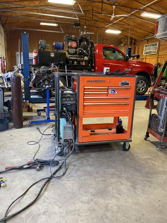

Wayne0 935 #12 Posted March 23, 2023 On 3/17/2023 at 10:54 PM, ClassicTractorProfessor said: Been messing around with the welder quite a bit in my spare time the past couple months, and I must say that I am impressed. Once you play around with the settings and find the sweet spot for what you are welding, the little machine works extremely well. Still haven't ran any solid MIG wire through it yet, but running flux core it welds really smooth. Haven't gotten it set up to try TIG yet, but I did play around with the stick feature a little bit, welded a few pieces of scrap together with some 3/32" 6011. It could be used for light repairs with stick electrodes, but I wouldn't recommend it as a machine if one is primarily looking for a dedicated stick welder. Which is fine as most of my stick welding is done with the old faithful Miller on the truck anyway. One of the first projects I have been working on with the new machine is a rolling cart and workstation which will hold said machine, as well as the YesWelder Cut55-DS plasma cutter I purchased last month. I looked at several of the welding carts sold at various retailers, but none of them offered all the features that I wanted, so I opted to build my own. I started with a US General 5 drawer roll cart, and began by removing the handle, top lid, and casters. I then began building a rolling frame out of 14 gauge 1"x2" rectangular tubing that cages the original box. I then reinforced the rear part of the cart behind the box, and covered it with a piece of 1/8" plate, this area will hold up to 3 125cf gas cylinders. The space to the left of the box will have shelves built for the welder and plasma cutter to sit on. And finally a close up of one of the beads laid with this little unit running flux core wire. Hope to get this cart finished soon, I ran out of 1x2 tubing due to a midway design change. Steel supplier is 40 miles away, and only open M-F 8-5, which really sucks as I work M-F 8-5. Probably have to take the wife's pickup to work one day and send her to the steel supplier with my welding truck and trailer to pick up the rest of the tubing for this project as well as another one I need to get started on for the neighbor. Once the frame is built the top will be covered with a solid piece of 3/16" plate to make a small workstation for small repairs and projects. Damn nice bead for flux core! 1 Share this post Link to post Share on other sites
kpinnc 13,771 #13 Posted March 23, 2023 On 3/17/2023 at 10:54 PM, ClassicTractorProfessor said: Been messing around with the welder quite a bit in my spare time the past couple months Nice mobile welding station! I picked up a Hobart 140 a couple years back. Never took the plunge on a bottle yet, still using flux core. BUT very impressed with the power on these little 110V welders. I "grew up" on stick welders, and I'll not likely go back to those- unless I find a need for 1/2 inch thick and up steel welding. Share this post Link to post Share on other sites

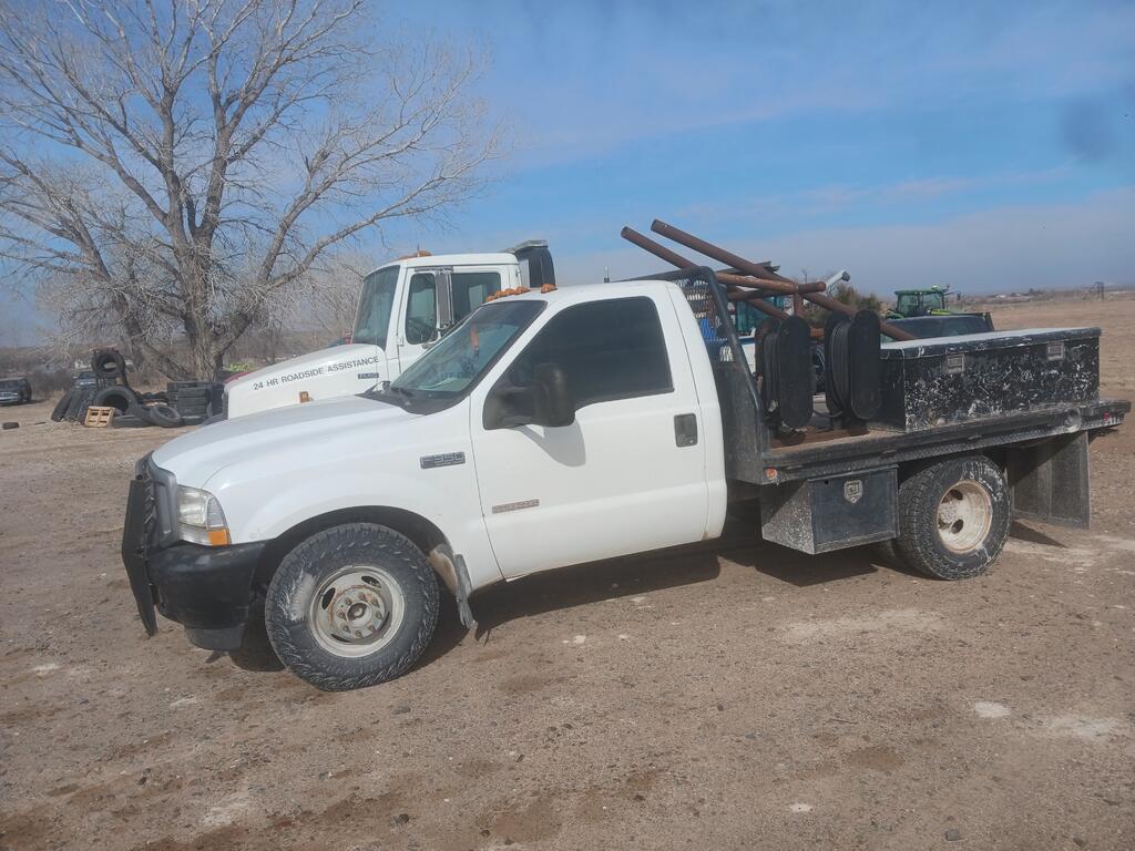

ClassicTractorProfessor 5,366 #14 Posted March 23, 2023 43 minutes ago, kpinnc said: Nice mobile welding station! I picked up a Hobart 140 a couple years back. Never took the plunge on a bottle yet, still using flux core. BUT very impressed with the power on these little 110V welders. I "grew up" on stick welders, and I'll not likely go back to those- unless I find a need for 1/2 inch thick and up steel welding. Thanks...that one is my mobile welding station...then I have my MOBILE welding station I grew up on a stick machine as well. Matter of fact I learned to weld on this Miller that Grandpa bought new in 1979. Up until my junior year of high school I didn't even know that electric powered welders of any kind even existed. The old Onan powered Miller was the only type of welder I knew there was 4 Share this post Link to post Share on other sites

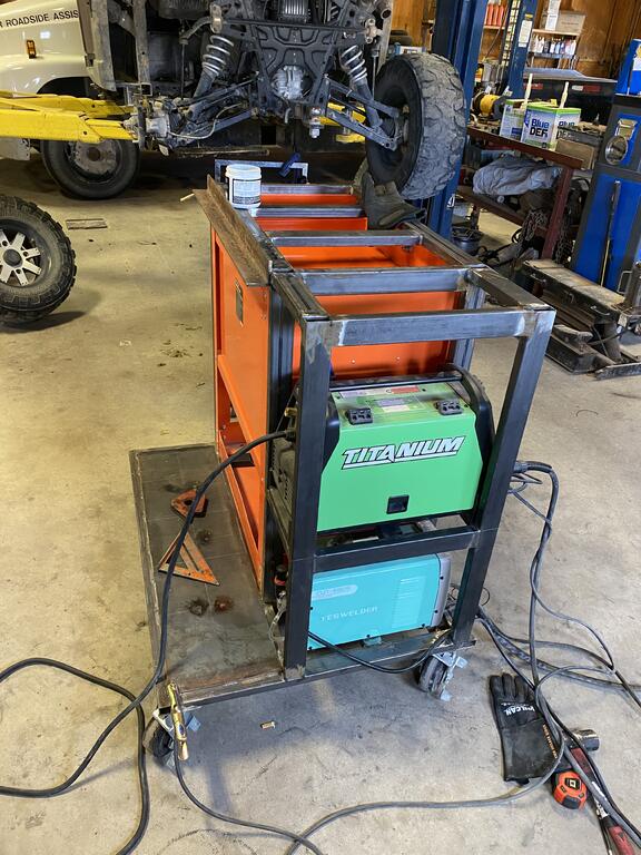

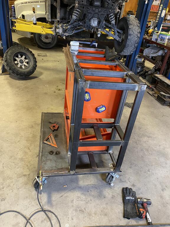

ClassicTractorProfessor 5,366 #16 Posted April 16, 2023 Did some more work on the cart today, and finally got to use the Titanium running solid wire. I changed the machine over from flux core to solid wire a couple weeks ago for a coworker of mine to do some exhaust work on his pickup, but this was the first time I ran it since. Running .030 wire from my local welding supply with a 75/25 Argon/CO2 mix shielding gas. Very happy with how the machine welds and very happy with how the cart is coming along as well. 3 1 Share this post Link to post Share on other sites
