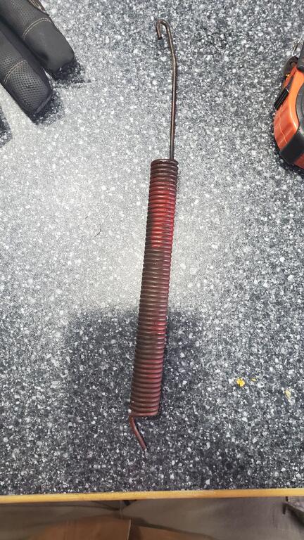

Slippery 16 #1 Posted December 21, 2022 Where's a good place to get replacement springs? I just broke one that's 3/4 diameter by 14" long. In case it matters it's the belt tensioner spring for my snowblower. 2 Share this post Link to post Share on other sites
oldlineman 1,495 #2 Posted December 21, 2022 you may be able to bend a new eye in the end to get you back in service till you find one. I have no W H snowblowers so will have to wait for someone with experience with them to respond. Bob 2 1 Share this post Link to post Share on other sites
stevasaurus 23,072 #3 Posted December 21, 2022 ACE, TSC and others may have something that works. Does TORO still show the part?? 3 Share this post Link to post Share on other sites
Pullstart 64,576 #4 Posted December 21, 2022 Yup, I’d head to the nearest hardware store and bring my McGuyver hat! 2 1 Share this post Link to post Share on other sites
peter lena 9,091 #5 Posted December 21, 2022 @Slippery local h/w store should have a good supply , don't expect to pick up the exact size / type, personally , always have small steel round stock on hand to adapt to any spring , situation look for an extension spring , with the same winding size , cut and bend up the end connections with 1/8 " steel round stock , like a long " S SHAPE " . been doing that for years . piece of cake , pete 3 1 1 Share this post Link to post Share on other sites

pacer 3,175 #14 Posted December 21, 2022 Feller can find himself fixing something that would have never thought of before the particular ... incident? happens. So I was cutting my 2 acres when I noticed the deck blades wernt turning, head to shop, find a spring for tensioning the belts was missing - didnt even try to find a spring in amongst all that grass. Always keep a few odd springs in the shop, so went and dug one that was close, just too short maybe 2 inches. Some time previously had about 20-30 stick welder rods get wet and flux was falling off and I had never thrown them away so after scratching my head for a few, I thought of them and got one and started bending ---- after couple tries I had one that worked nicely, still on there. Have since found all sorts of things to do with otherwise useless welding rods..... 1 2 1 Share this post Link to post Share on other sites
ri702bill 8,989 #15 Posted December 21, 2022 Yo Slippery - you MAY be able to do a "I need it now fix" using a short piece of steel coat hanger to get you thru. Bend up a circle of hanger, use a pair of side cutter pliers to open up the spring 2 or 3 coils past the break - fish the hanger in, twist it off to make a loop. Reattach the spring & check for function. BT,DT. 5 Share this post Link to post Share on other sites
