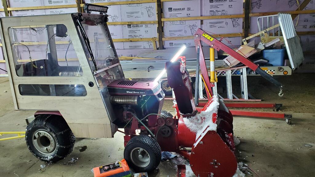

Slippery 16 #1 Posted December 15, 2022 So I was blowing snow with my 520H with a 2stage blower mounted on it and I noticed a trail of fluid that looked like transmission fluid. I also noticed some spots on the blower. Everything is still working but for how long? My main question is where would transmission fluid be used on a 520h or 2 stage snowblower? It's a factory wheelhorse blower. It was late so I didn't have much time to investigate. Thank you inadvance. 2 Share this post Link to post Share on other sites

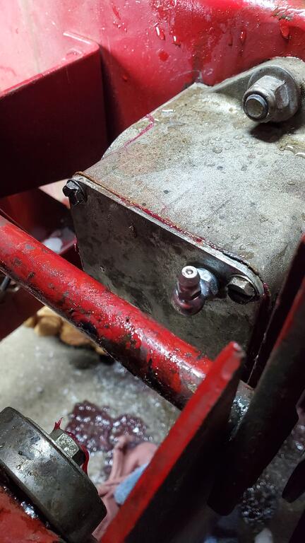

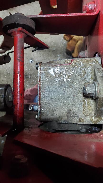

Slippery 16 #8 Posted December 15, 2022 The hydro takes motor oil. I'm guessing it came from the blower. From what I can tell the gear box has a plate on the side. How do you add oil to it? 3 Share this post Link to post Share on other sites
kwalshy 237 #9 Posted December 15, 2022 Here is a link to the manuals section. there is a gear box that can be easily accessed to add more oil. you don't have to remove side panel. https://www.wheelhorseforum.com/files/category/28-snow-blowers/ 2 1 Share this post Link to post Share on other sites
wallfish 17,498 #10 Posted December 15, 2022 The Peerless 90 deg gearbox was filled with grease from the factory. There's technically no fill because of that. It won't leak unless someone had it open before and put something else in there. You can remove the plate to look in it and or add grease. The worm gearbox in the center of the augers can also be filled with grease instead of oil. I've been using Lubriplate 105 grease in mine for 3 years or more, no problem. JD Cornhead grease is designed for gearboxes and that will work too. 2 1 Share this post Link to post Share on other sites
Slippery 16 #11 Posted December 16, 2022 4 hours ago, wallfish said: The Peerless 90 deg gearbox was filled with grease from the factory. There's technically no fill because of that. It won't leak unless someone had it open before and put something else in there. You can remove the plate to look in it and or add grease. The worm gearbox in the center of the augers can also be filled with grease instead of oil. I've been using Lubriplate 105 grease in mine for 3 years or more, no problem. JD Cornhead grease is designed for gearboxes and that will work too. That's exactly what I did plus I added a grease zirt. FYI it was definitely coming from the gearbox. 3 Share this post Link to post Share on other sites

Slippery 16 #13 Posted December 16, 2022 It was red gear oil that leaked out. I packed it with red wheel bearing grease. Thanks I got a smoking deal on this bad boy 1200.00 for everything you see hear plus a mower deck, tiller, blade, disk, a bunch of other stuff, and around 1000.00 dollars worth of miscellaneous spare parts. I can blow snow in a hoodie and stay warm. 6 Share this post Link to post Share on other sites
