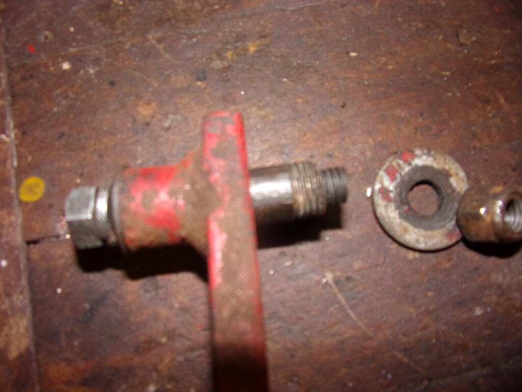

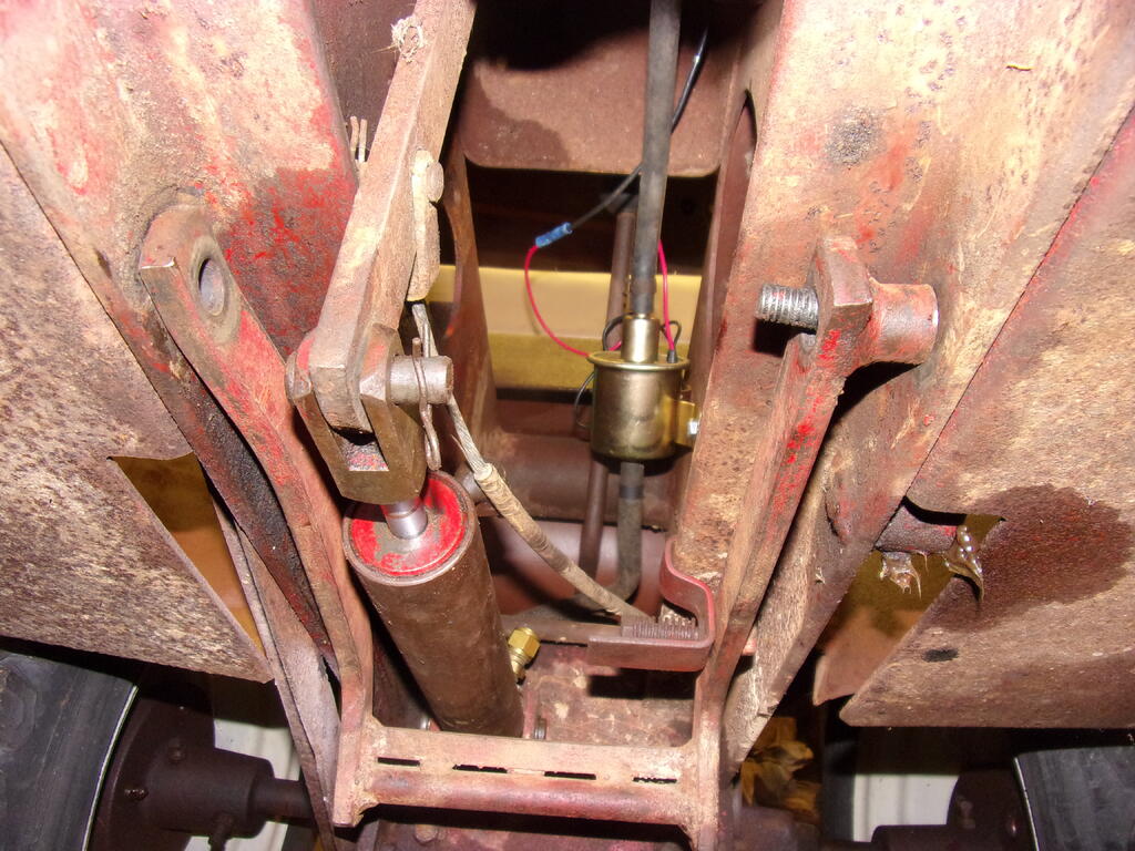

Ed Kennell 40,500 #1 Posted December 14, 2022 Started to but Fred back together. I didn't take pictures cause I know every parts location on a ....wrong. Is this the proper location of the deck attachment bracket ? I couldn't find it in the manuals and I don't have a deck. Are you there Richard? @953 nut thanks 1 1 Share this post Link to post Share on other sites
Pullstart 64,573 #2 Posted December 14, 2022 It LOOKS correct Ed. Could you use shoulder bolts from the inside? 1 Share this post Link to post Share on other sites
Ed Kennell 40,500 #3 Posted December 14, 2022 2 minutes ago, Pullstart said: It LOOKS correct Ed. Could you use shoulder bolts from the inside? Thanks Kev. No shoulder bolts or bushings when I disassembled, but it does look they should be used. 1 Share this post Link to post Share on other sites
peter lena 9,089 #4 Posted December 14, 2022 @Ed Kennell would not hesitate to washer and elastic lock nut that set up , pete 2 Share this post Link to post Share on other sites
RandyLittrell 3,894 #5 Posted December 15, 2022 Maybe some tubing for a bushing? Randy 3 Share this post Link to post Share on other sites
Ed Kennell 40,500 #6 Posted December 15, 2022 6 minutes ago, RandyLittrell said: Maybe some tubing for a bushing? Randy Yep, all ready in the works Randy. Thanks 3 Share this post Link to post Share on other sites

squonk 42,561 #8 Posted December 15, 2022 (edited) I don't want to jinx you Ed, but that fuel pump is one that hasn't performed the best in the past. Is it easy to get too? I mounted my Facet pump right under the tool box slot in the rear for easy service. Edited December 15, 2022 by squonk 1 Share this post Link to post Share on other sites
Ed Kennell 40,500 #9 Posted December 15, 2022 14 minutes ago, squonk said: Is it easy to get too? Yes it is. I had a couple fail early as well as an expensive one. There is some indication failure of the electric pumps may be caused by dirt or running dry. I started putting a filter on the pump inlets and it seems to help. 4 Share this post Link to post Share on other sites

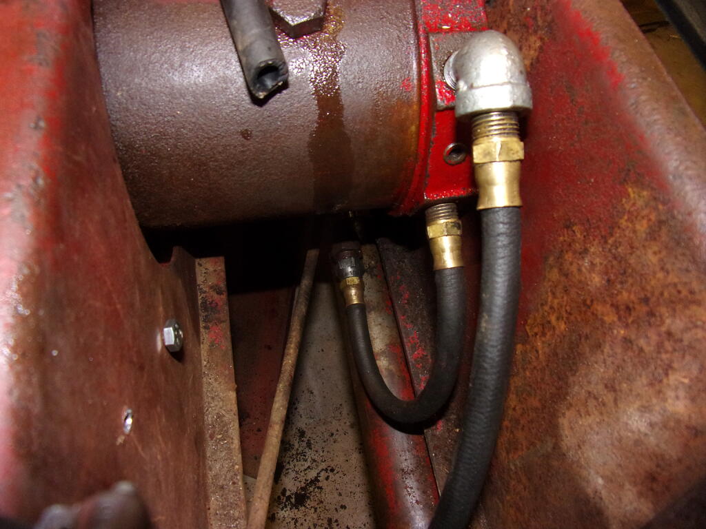

Ed Kennell 40,500 #10 Posted December 17, 2022 OK 953 owners, I need more help. Is this the correct hose layout? BTW, 1/4" pipe was the exact ID and OD to make the bushings for the deck hanger. 1 Share this post Link to post Share on other sites
