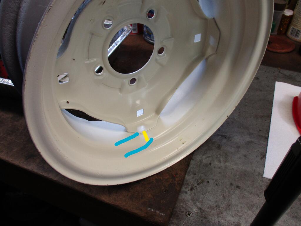

pfrederi 18,334 #7 Posted December 14, 2022 Not so sure guys. My 310-8 had the 22" tires. The rims were only 5". Measure the length of the yellow line between two blue ones. 1" means a 5" rim 3" is a 7" You can mount the 8.50 but it will be bulgy!! 1 Share this post Link to post Share on other sites

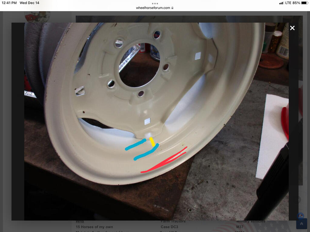

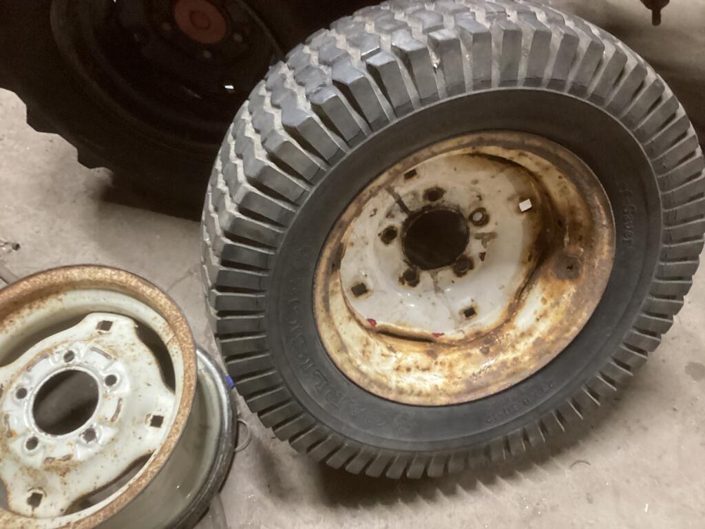

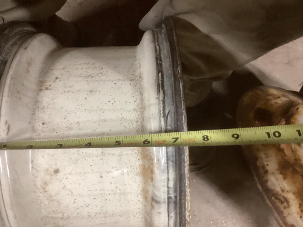

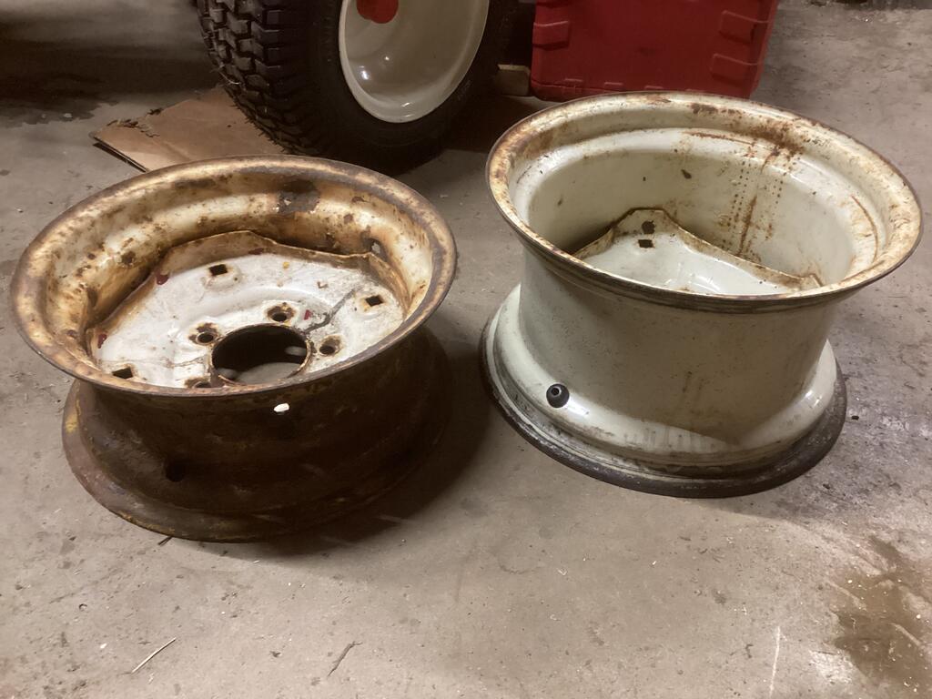

Pullstart 64,576 #9 Posted December 14, 2022 45 minutes ago, pfrederi said: Not so sure guys. My 310-8 had the 22" tires. The rims were only 5". Measure the length of the yellow line between two blue ones. 1" means a 5" rim 3" is a 7" You can mount the 8.50 but it will be bulgy!! Paul most 6-12’s were on 4” or 5” wide wheels. I’m not doubting that your 310 had them, but I find it hard to believe they were on it when built. Here are some wheels, a 5” and 7”. The 5” isn’t the BEST example, it’s riddled with rust holes and no valve stem so I couldn’t bead the tire. Wheels measured inside the lip, where the bead mounts. Tire used is an old Carlisle 23x8.50-12 1 Share this post Link to post Share on other sites
Pullstart 64,576 #10 Posted December 14, 2022 2 minutes ago, doc724 said: you might be correct on the rim width v. the "yellow line" However I found that over the years, WH changed the position where the center spider was welded to the rim. The rim width was the same at 7 inches, just the offset was different. Wheel width is measured at the lip (red line) anyway. Yeah, the yellow line doesn’t mean anything really… 1 Share this post Link to post Share on other sites
8ntruck 7,389 #11 Posted December 14, 2022 (edited) I was an engineer for 40 years in the steel wheel industry. Rim width is measured between the tire side of the flanges - as @Pullstart demonstrated. Measuring the width of the drop well from the disc flange is a quick and dirty way to estimate the rim width - IF you know the other reference points on that family of wheels. If 22x9-12's were mounted previously, going to a 23-8.5 x 12 will not be a problem on that same wheel. You will get about 1" more diameter, but loose 1/2" section width in the tire (slightly narrower tread width). Edited December 14, 2022 by 8ntruck 1 Share this post Link to post Share on other sites

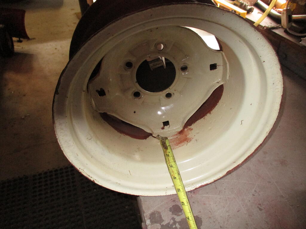

pfrederi 18,334 #12 Posted December 14, 2022 (edited) Parts manual does show 5" rims for some 308 310 312 depending on the year (and what WH had left over from previous years maybe) Backset on the 5" rims was 1-3/8 just like the 7 Inch rims. Note difference on this 7" rim I was just trying to give a quick way of making sure he didn't have eh narrow rims....with out demounting and measuring. Edited December 14, 2022 by pfrederi 2 Share this post Link to post Share on other sites
