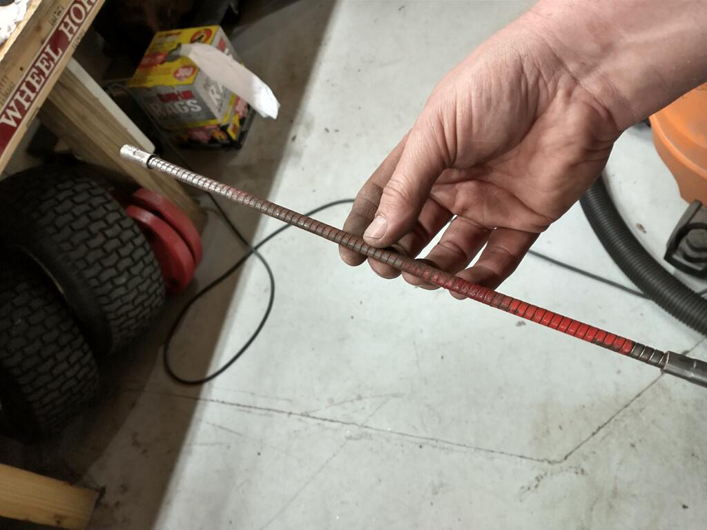

ebinmaine 75,744 #1 Posted December 11, 2022 This cable housing is off my 1975 C160 Automatic. I can poke into each end with a long thin punch. How can I free up the whole thing and use it? Cables available from Lowell? Share this post Link to post Share on other sites
Digger 66 3,488 #2 Posted December 11, 2022 (edited) I would soak it if that spiral casing is not sealed and if it is sealed , I'd hang it and drizzle some penetrant in until it comes out the bottom . If you have an old piece of garden hose , cork one end and slide the whole she-bang into it and pour in some kerosene while it's hanging . Oops , I misread it . I thought the inner cable was frozen inside . You could always sacrifice an old small drill bit and weld it to a piece of thin rod and chuck it up in a drill ? Edited December 11, 2022 by Digger 66 3 Share this post Link to post Share on other sites
stevasaurus 23,515 #3 Posted December 11, 2022 A length of 12 gage wire cut at an angle and put into a drill and worked a little at a time may do it. 3 Share this post Link to post Share on other sites
RandyLittrell 3,942 #4 Posted December 11, 2022 I would start with hot water and dawn then I would do the bailing wire trick and see what comes out. Randy 3 Share this post Link to post Share on other sites
Moparfanforever 896 #5 Posted December 11, 2022 Maybe a piece of no.9 wire?? I would soak it first. 2 Share this post Link to post Share on other sites

daveoman1966 3,881 #14 Posted December 12, 2022 Lay it on a flat steel surface. Start smacking it with a hammer...don't crush it... to 'break-up' the junk inside. Then start flexing it back/forth. The junk will free up...maybe some carb cleaner/penetrant/ air pressure etc. It'll open up eventually. OR... I'll put one in your mailbox for $20 3 Share this post Link to post Share on other sites

wallfish 18,786 #16 Posted December 12, 2022 Soak it in vinegar to eat the rust right out of it. Run a wire trough it on a drill as suggested, resoak , redrill wire and repeat until it's 100% clean and then lube of your choice. Wire rope is what the cable was. 3/16" ??? maybe 5 Share this post Link to post Share on other sites

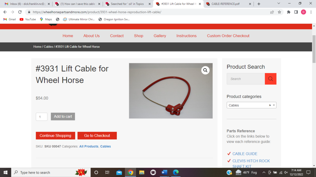

953 nut 63,003 #18 Posted December 12, 2022 11 hours ago, squonk said: Just buy a new cable/ casing from Lowell and be done with it. You need to hydraulically crimp the end on the wire. Any other method won't be able to stand up to heavy lifting. I tried every way. Nothing worked. $ 54.00 plus shipping and you can spend your time doing fun things. 5 1 1 Share this post Link to post Share on other sites

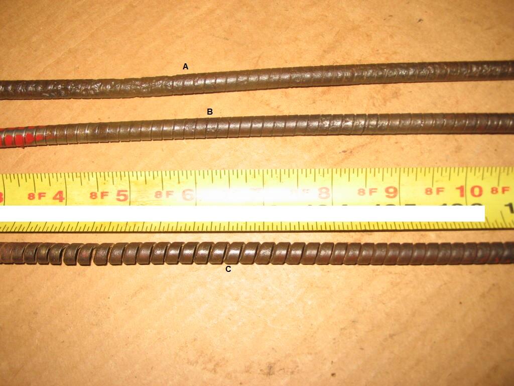

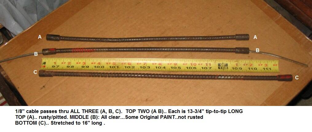

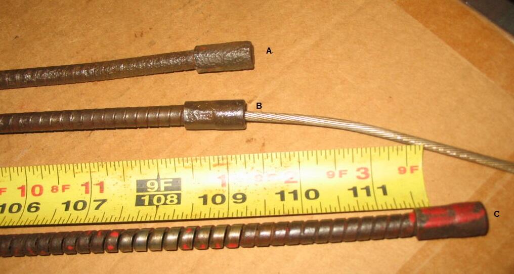

daveoman1966 3,881 #22 Posted December 12, 2022 (edited) I have the CONDUIT you want... a 1/8" cable easily passes thru all three of these. "A" is rusty/pitted...$30 shipped "B" is all good...Some original paint--- $40 shipped BOTH A and B are 13-3/4" LONG... Tip-to--Tip "C" is stretched out to 16-1/4" --otherwise good except for some pitting on one end....$35 shipepd Edited December 12, 2022 by daveoman1966 1 Share this post Link to post Share on other sites
