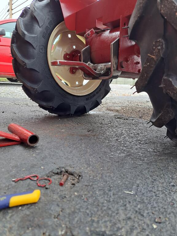

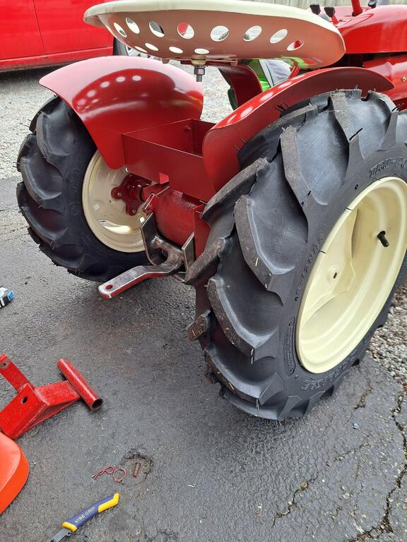

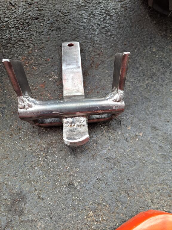

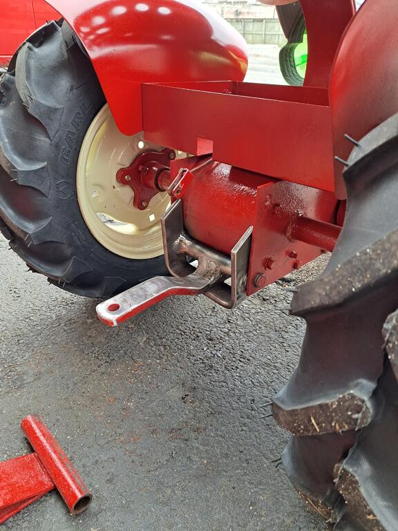

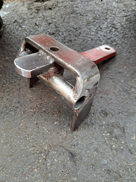

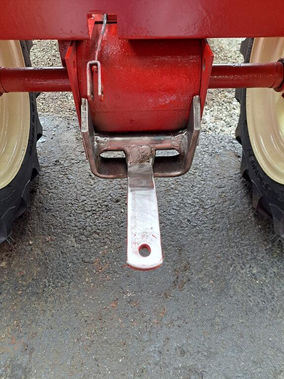

benjiboo 174 #1 Posted December 7, 2022 So I had previously bought a hitch for a larger horse and after trying to fit it to my Suburban like I had seen in another older post I found that it indeed did not fit without modification. So today I finally got time to retrofit the larger heavier duty more gooder better hitch to the Suburban. It's been about a year since I've fired up the welder but she ain't coming loose. Lol. 6 6 Share this post Link to post Share on other sites
Pullstart 64,593 #3 Posted December 7, 2022 That looks tough as [1,357] nails! 3 Share this post Link to post Share on other sites
Handy Don 13,340 #4 Posted December 7, 2022 Probably the strongest part on the tractor now! Looks nice. 1 1 Share this post Link to post Share on other sites
WHX?? 50,771 #5 Posted December 8, 2022 Tractor is not a tractor without a draw bar! 1 Share this post Link to post Share on other sites
Rick3478 434 #6 Posted December 8, 2022 6 hours ago, benjiboo said: 6 hours ago, benjiboo said: So I had previously bought a hitch for a larger horse and after trying to fit it to my Suburban like I had seen in another older post I found that it indeed did not fit without modification. So today I finally got time to retrofit the larger heavier duty more gooder better hitch to the Suburban. It's been about a year since I've fired up the welder but she ain't coming loose. Lol. Nice work, but couldn't you have just stuck a piece of bar stock in the existing slot hitch? Share this post Link to post Share on other sites
peter lena 9,092 #7 Posted December 8, 2022 @benjiboo very nice job on that , noticing the horizontal flat panel on lower fender connection , be a great spot for 2 LED tail lights , have them on my 3 horses , really stand out when road edge plowing , they have glowing brightness thats hard to ignore , pete 1 Share this post Link to post Share on other sites
