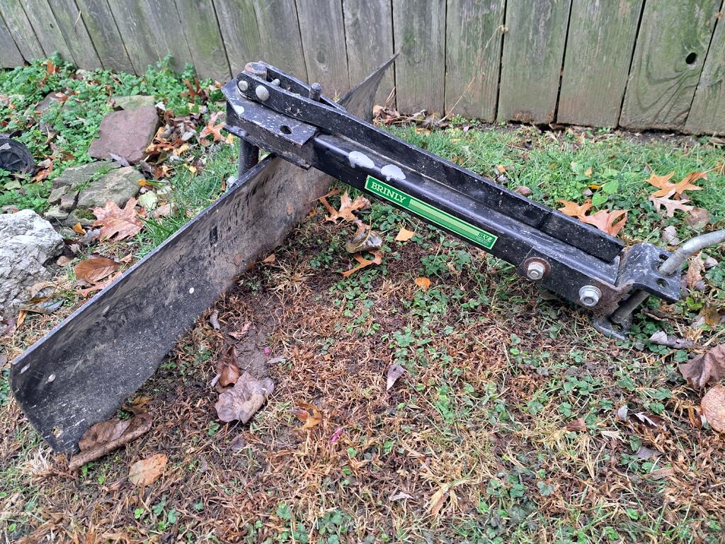

benjiboo 174 #1 Posted December 7, 2022 Yesterday I aquired a Brinly 38" blade and I was curious if anyone has adapted this to work on the back of a Suburban or other model with the slot hitch? Any pictures of how you did it? Would this be too much weight hanging in the air for the lift cable or would this be within a safe working load for it? The tongue is 24" long. Thanks y'all! 1 Share this post Link to post Share on other sites

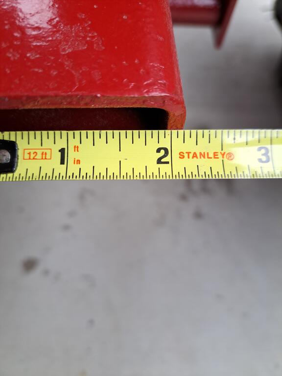

benjiboo 174 #8 Posted December 7, 2022 Just now, Achto said: 5/8" thick flat stock works the best but 1/2" thick will work as well. And what is the correct width? Seems like everything is either too loose or won't fit.... 1 Share this post Link to post Share on other sites
Achto 27,928 #9 Posted December 7, 2022 6 minutes ago, benjiboo said: And what is the correct width? I think it is 2", can't seem to remember that dimension off hand. A little loose will not effect things that much. You should not have to use any force to slide it into the receiver on the tractor. Some where on the forum there was a drawing with measurements for making the adapter. 1 Share this post Link to post Share on other sites
benjiboo 174 #10 Posted December 7, 2022 2" on my Suburban is too wide. Looks like 1 15/16" which is pretty odd ball to just run out and grab somewhere. 2 Share this post Link to post Share on other sites
Pullstart 63,205 #11 Posted December 7, 2022 Know anyone with a mill? Disk grinder? 1 Share this post Link to post Share on other sites
Achto 27,928 #12 Posted December 7, 2022 (edited) A little bit of time with a grinder and you could adjust a 2" wide piece. Only need to grind what goes into the slot. Edited December 7, 2022 by Achto 1 Share this post Link to post Share on other sites
