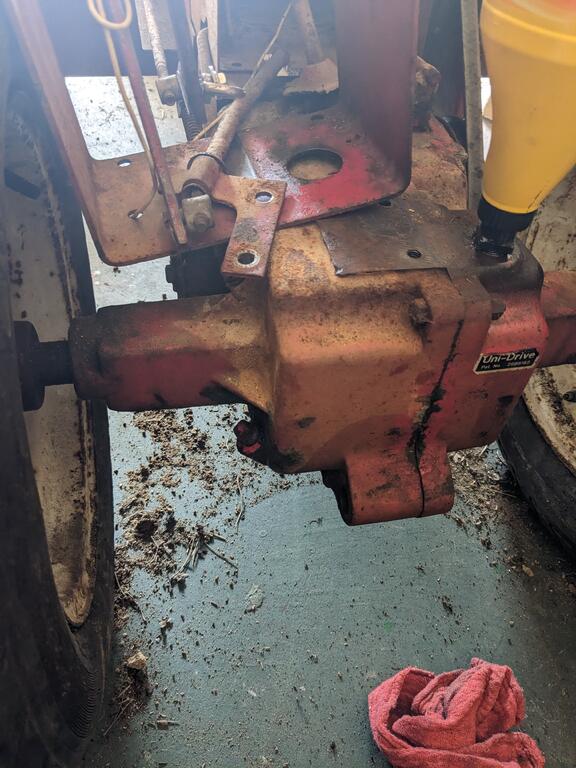

Treepep 935 #21 Posted February 21, 2023 2 hours ago, gwest_ca said: https://www.wheelhorseforum.com/search/?&q=71-12k801&type=downloads_file&search_and_or=or&sortby=relevancy Thank you for the information. I hope there is capacity and type of fluid for the uni drive. Has some condensation. Pretty milky. At least it has fluid??? Share this post Link to post Share on other sites
TractorEd 649 #22 Posted February 21, 2023 (edited) Yes, the manuals state the capacities and types. Engine holds about 2 quarts, sae 30, but get some higher zinc content oil the engine will appreciate it. I can’t find the trans oil that the manual calls for: 90W-140 gl-5 gear oil, but 85w-140 GL-5 works just fine and can be found fairly easily. About 2 quarts in the trans, too. I think she’s a nice looking machine! Edited February 21, 2023 by TractorEd 1 Share this post Link to post Share on other sites
Treepep 935 #23 Posted February 21, 2023 44 minutes ago, TractorEd said: Yes, the manuals state the capacities and types. Engine holds about 2 quarts, sae 30, but get some higher zinc content oil the engine will appreciate it. I can’t find the trans oil that the manual calls for: 90W-140 gl-5 gear oil, but 85w-140 GL-5 works just fine and can be found fairly easily. About 2 quarts in the trans, too. I think she’s a nice looking machine! Many thanks to all. Starts cold without smoke. She runs and drives great. I got it home and it would not start. Bad ground and PTO safety was the second culprit. I will rewire otherwise It will be my dedicated dump trailer hauler. I love it like it is. Thanks again! 1 3 Share this post Link to post Share on other sites

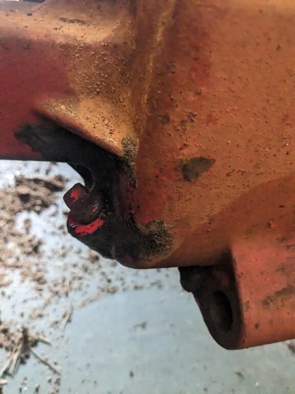

Treepep 935 #24 Posted February 22, 2023 So. Dumb question. Every piece of old equipment I own when you are filling and it starts weeping out from this plug it is full. That happened at 1qt exactly. Is 2 quarts necessary? Share this post Link to post Share on other sites
Treepep 935 #25 Posted February 22, 2023 11 minutes ago, Treepep said: So. Dumb question. Every piece of old equipment I own when you are filling and it starts weeping out from this plug it is full. That happened at 1qt exactly. Is 2 quarts necessary? Dipstick says yes. Sorry Share this post Link to post Share on other sites
