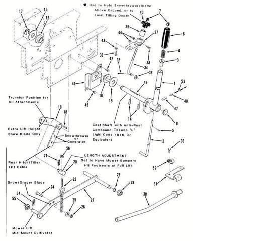

evaninsky 8 #1 Posted December 5, 2022 I'm struggling removing the bellcrank (#19) from the lift lever shaft (#46). The bellcrank needs to slide along the shaft, to reveal the key (#18) underneath. The diagram illustrates that this shaft should be coated with anti-rust compound, but the bellcrank seems rusted to the shaft regardless. There's no room in there swing a hammer. I'm thinkin about hitting it with a torch to see if that doesn't expand it a bit. any other thoughts ??? 1 Share this post Link to post Share on other sites

953 nut 57,980 #4 Posted December 5, 2022 10 hours ago, evaninsky said: The diagram illustrates that this shaft should be coated with anti-rust compound, but the bellcrank seems rusted to the shaft regardless. I don't think the factory ever coated the bellcrank with anything but oil. Unless the tractor never was exposed to the weather they will be rusted together. The only way that penetrating oil is likely to do any good would be to drill a series of holes in the top of the sleeve (19) and ad your favorite penetrating oil to each hole every day for a week or more so it can work along the shaft and thin hope for the best. What parts of the lift are you attempting to save? 5 2 Share this post Link to post Share on other sites

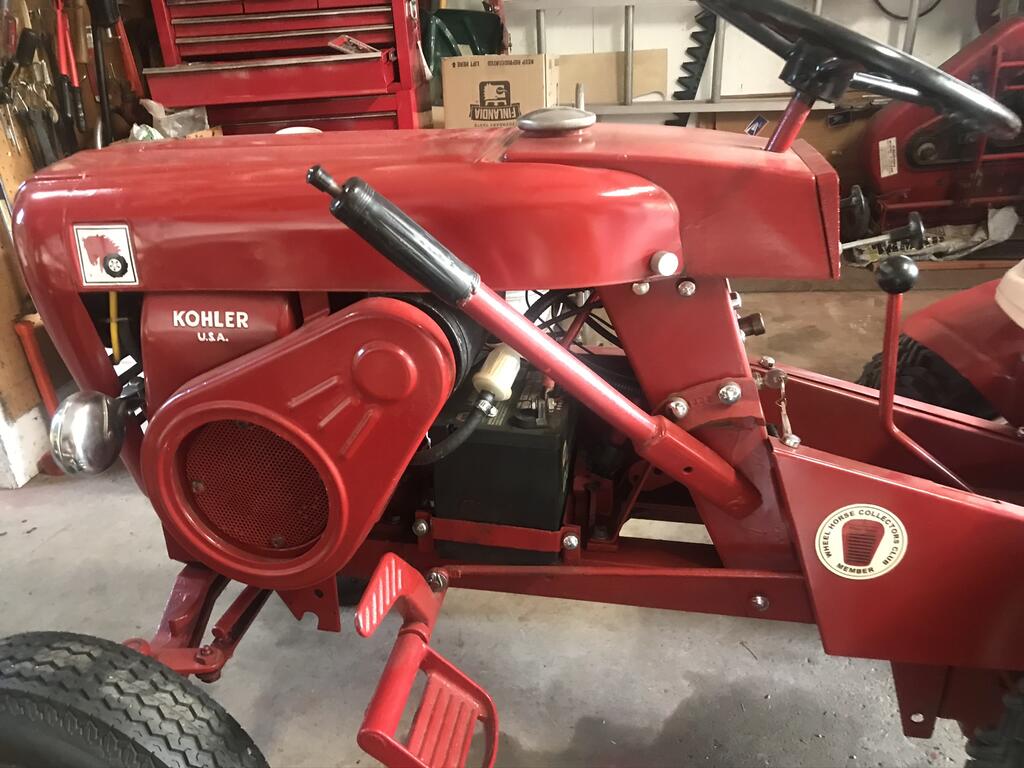

Lane Ranger 11,125 #6 Posted December 5, 2022 The early round hoods were made in a much easier way to remove lift handle and bell crank. Wheel Horse did not always improve upon an original design feature! 4 1 Share this post Link to post Share on other sites

ri702bill 8,992 #8 Posted December 5, 2022 (edited) On 12/5/2022 at 8:54 AM, Lane Ranger said: The early round hoods were made in a much easier way to remove lift handle and bell crank. In 1963 and later.... the 1961 701 and the 1962 502, 552, and 702 had a very rust prone design that was difficult to remove - in 63 they changed to the 2 bolt block at the lift lever - BIG improvement..... Edited December 6, 2022 by ri702bill 1 Share this post Link to post Share on other sites

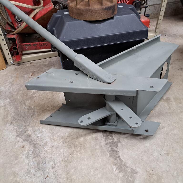

WHX?? 50,771 #9 Posted December 5, 2022 701 Bill ... looks like she gets painted on the hood stand.... afraid I was gonna bend or break something i couldn't fix. Odd there was a roll pin in there that sailed right out. 4 Share this post Link to post Share on other sites
daveoman1966 3,808 #10 Posted December 5, 2022 (edited) Some guys may not like this, but its worked for me in the past...a few times. (1) drop the bellcrank 19 down to its limit. (2) Use a die grinder with cut-off wheel to slice across the full length of the bellcrank. (3)Wedge a thick flat prybar in the crack and drip Some good penetrant into that crack. (4) Use a BFH and a drift pin, drive the bell crank 46 out of the hoodstand. (5) Before reinstall, either braze or electro weld the crack. (6) While still off, test fit 19 on the shaft 46 and, if not already done, (7) drill out the hair-pin holes of 19 and 46 to 1/4" and install two bigger hairpins 14. Edited December 5, 2022 by daveoman1966 4 4 1 Share this post Link to post Share on other sites
