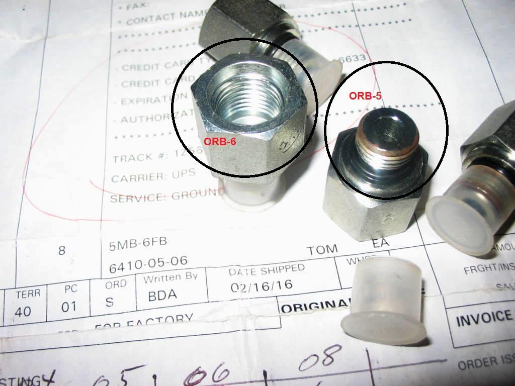

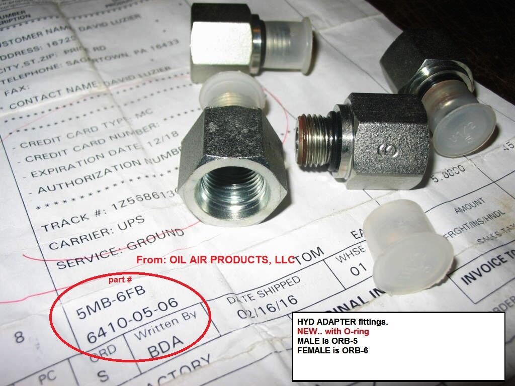

I have a set of FOUR hose adapters...with O-rings
MALE end is ORB-5 (with O-ring) and the FEMALE end is ORB-6
Supplied by OIL- AIR PRODUCTS llc.  I used these to install new hyd HOSE lines with MALE ORB 6 to connect to the older HYD Control Valve having a FEMALE ORB-5  on a 1972 Bronco 14 Automatic with hyd lift and later on a Charger 12.
These are the 4 extras that I still have.
$35 for all FOUR..... THESE ARE NEW....shipped in USA.
