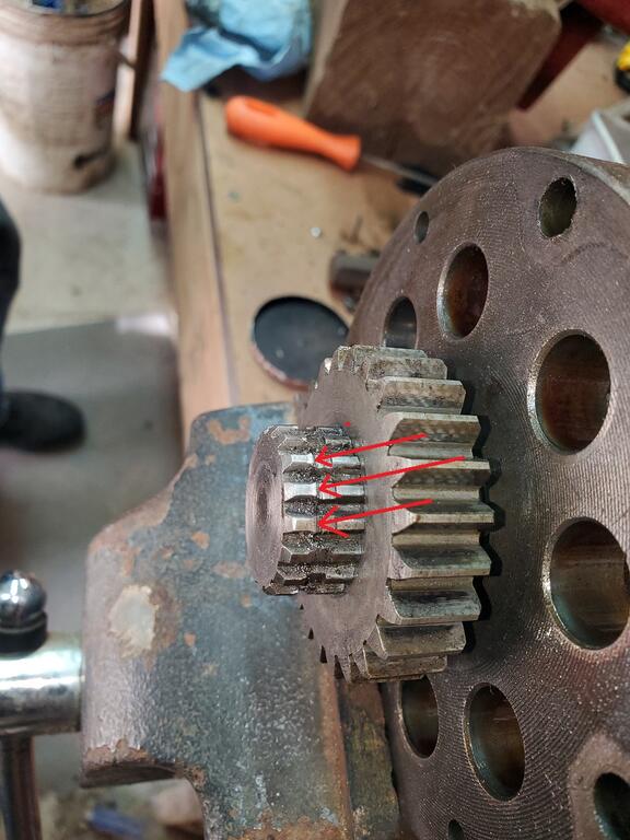

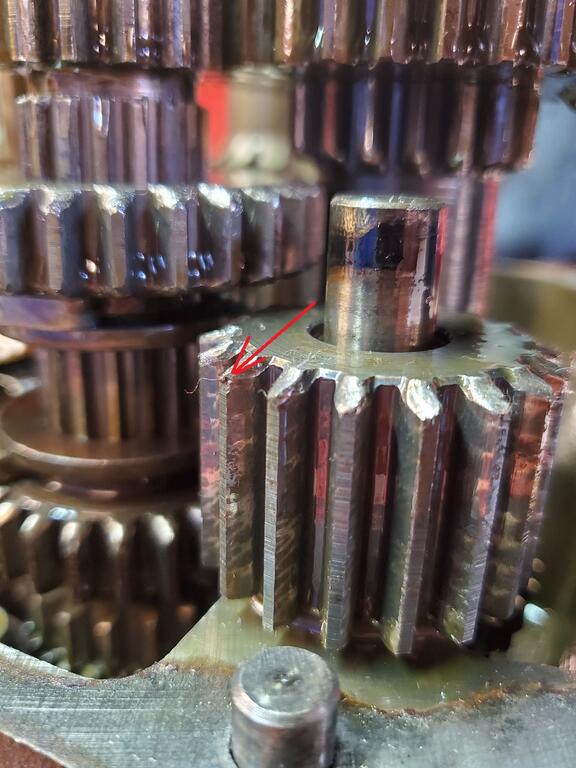

GAJoe 850 #126 Posted December 9, 2022 On 11/23/2022 at 3:27 PM, stevasaurus said: I suspect your issue with the input shaft is a loose pulley the got sucked in and ground down. It is not your input shaft moving in and out that is the issue. If it does move, it is only minimal and is designed to do that. I think your pulley was not tight and moved in to grind the edge of it. You need to make sure the pulley is secured with the Allen Set Screw...maybe even file a flat spot for the screw to set in. I know some have shimmed the input shaft to decrease the in and out, but that is not your issue. They do that to make 3rd gear tighter. Your issue is a pulley not setting on the shaft where it should be. I think I saw a lip on the pulley in one of your pictures. If that is so, grind it smooth and when you put it back together check the pulley alignment and tighten it up and then keep an eye on it. It is not internal. I took the burs off of those gear spline ends. Considering the wear, you had mentioned that if it has a problem staying in third gear that the wear is the cause but you thought it looked ok. Should I shim the input to make third gear tighter? If so should the shim go on the end closest to the pulley or the other end to make third gear tighter? 3 Share this post Link to post Share on other sites
ebinmaine 70,764 #127 Posted December 9, 2022 We've run gears in worse shape with no issues. 2 1 Share this post Link to post Share on other sites
stevasaurus 23,072 #128 Posted December 9, 2022 If you think you need to shim the input shaft, you want to shim on the inside between the input gear and the casting. The splined shaft keeps the input shaft in place. 2 Share this post Link to post Share on other sites

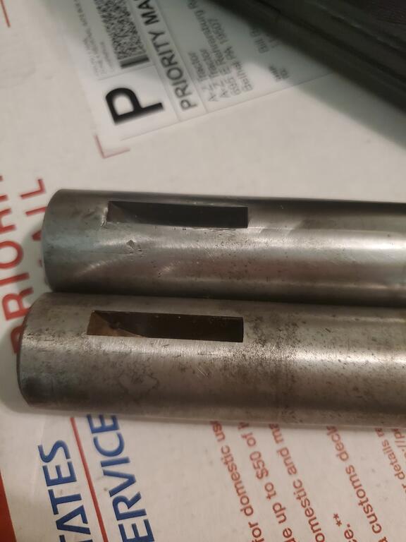

GAJoe 850 #129 Posted December 10, 2022 On 12/7/2022 at 8:58 PM, GAJoe said: a #21 woodruff Key (1/4' thick, 9/16" tall, and 1 & 1/4" long) On 12/4/2022 at 7:09 PM, GAJoe said: Well bummer! My axle shaft order package from A to Z Tractor arrived this evening but the box was empty. Well not completely empty there was a A to Z Tractor ink pen and paper in it. But it looks like the handlers tossed it into one of those buggys and it landed hard enough that the ($40 + $9 shipping) shaft punched out of the box. See the hole in the corner. I'm surprised that that hasn't happened before resulting in different packaging practices. I wonder if A to Z will re-send it or if I will have to file a claim with the USPS? Just wanted to let everyone know that A to Z Tractor got another shaft to me. Great folks to do business with! 2 2 Share this post Link to post Share on other sites

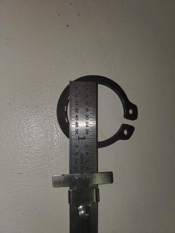

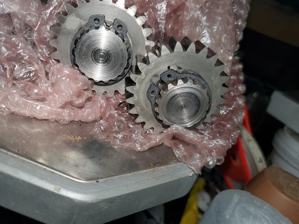

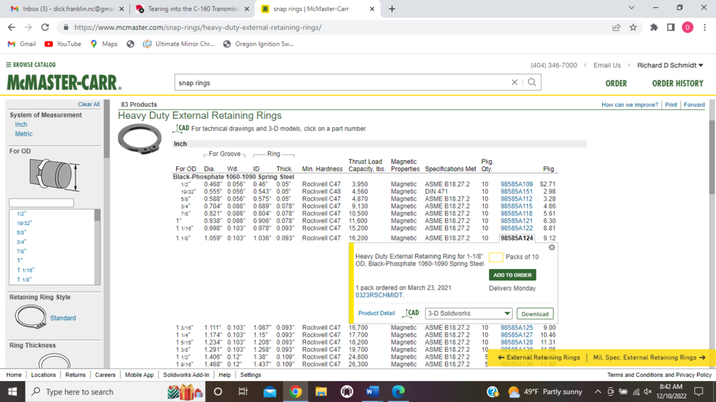

GAJoe 850 #130 Posted December 10, 2022 (edited) On to my next dilemma . The latest shaft from A to Z tractor is the same as the one that I got from eBay; #21 woodruff keys and deep cut snap ring groove of 1" OD. They both need 1.0" ID snap / retaining ring. My original axle shafts have a shallower cut snap ring groove, that uses a 1 and 1/16th inch ID snap ring. with "W" and "112" stamped into it. I haven't been able to find these 1" snap rings in the 1/10" thickness to fill the ring groove. What ID measurement are you guys and gals getting on your 1 and 1/8" shaft snap rings? Where can I find the extra thick (looks like 1/10th inch.) 1" snap rings to fit these axle shafts? Granger's "Heavy Duty Snap Rings are only 0.078 in. thick. Are my original axle shafts, with shallower snap ring grooves, the odd balls? Steve and I have discussed drilling the shafts and installing roll pins as the earlier models. I'm just afraid of my drill not being perpendicular to the shaft and one end of the roll pin would be getting all of the force. I think that I'll put the reassembly on hold another week and order the correct rings for the new to me axle shafts from A to Z.... Edited December 10, 2022 by GAJoe added info 3 Share this post Link to post Share on other sites

WheelHorse_of_course 99 #132 Posted December 10, 2022 1 hour ago, GAJoe said: On to my next dilemma . The latest shaft from A to Z tractor is the same as the one that I got from eBay; #21 woodruff keys and deep cut snap ring groove of 1" OD. They both need 1.0" ID snap / retaining ring. My original axle shafts have a shallower cut snap ring groove, that uses a 1 and 1/16th inch ID snap ring. with "W" and "112" stamped into it. I haven't been able to find these 1" snap rings in the 1/10" thickness to fill the ring groove. What ID measurement are you guys and gals getting on your 1 and 1/8" shaft snap rings? Where can I find the extra thick (looks like 1/10th inch.) 1" snap rings to fit these axle shafts? Granger's "Heavy Duty Snap Rings are only 0.078 in. thick. Are my original axle shafts, with shallower snap ring grooves, the odd balls? Steve and I have discussed drilling the shafts and installing roll pins as the earlier models. I'm just afraid of my drill not being perpendicular to the shaft and one end of the roll pin would be getting all of the force. I am not the biggest expert by far. But I would certainly considerusing two thinner snap rings if you find two the right thickness to fill the groove. 3 Share this post Link to post Share on other sites

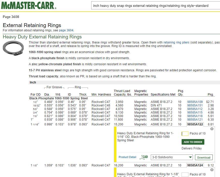

953 nut 57,948 #133 Posted December 10, 2022 Check this out from McMaster-Carr. They have an outlet in Douglasville GA and ship very quickly. 3 2 Share this post Link to post Share on other sites
pfrederi 18,334 #134 Posted December 10, 2022 You buy snap rings by the external diameter of the axle. Also by the heavy duty ones. and mount so sharp edge faces the inner end of the axle 5 Share this post Link to post Share on other sites
ebinmaine 70,764 #135 Posted December 10, 2022 @GAJoe I'll put a 3rd vote in for McMaster Carr. Excellent company. 4 Share this post Link to post Share on other sites
GAJoe 850 #136 Posted December 10, 2022 1 hour ago, pfrederi said: You buy snap rings by the external diameter of the axle. Also by the heavy duty ones. and mount so sharp edge faces the inner end of the axle So my originals are oversized for 1 & 1/8". I wonder if they couldn't sorce the correct size and went a size larger and cut the groove more shallow to have a snug fit. My original shaft was not cut deep enough to take the ring for 1 & 1/8" inch. 2 Share this post Link to post Share on other sites
GAJoe 850 #137 Posted December 10, 2022 OK I got a 10 pack ordered. If anybody needs some I'll sell up to four to recoup some shipping, nearly $10. But at least I found and got what I need. Thanks again you guys! 2 1 Share this post Link to post Share on other sites

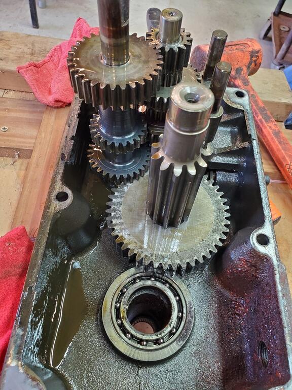

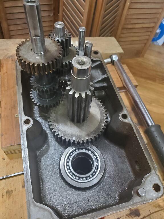

GAJoe 850 #141 Posted December 10, 2022 (edited) 20 hours ago, GAJoe said: I think that I'll put the reassembly on hold another week and order the correct rings for the new to me axle shafts ............... The weather wasn't good today for working on the deck so I decided to put the gears and shifter rails back in. All went well. I think that I got the second detent bearing on my third try. I nearly had to take everything out to find that second bearing on the second try. Here's a before and after. And it passed the shift test! And look what else turned up: My key ! The original complete with dealer key fob. It was a good day! (:. Edited December 11, 2022 by GAJoe 5 Share this post Link to post Share on other sites

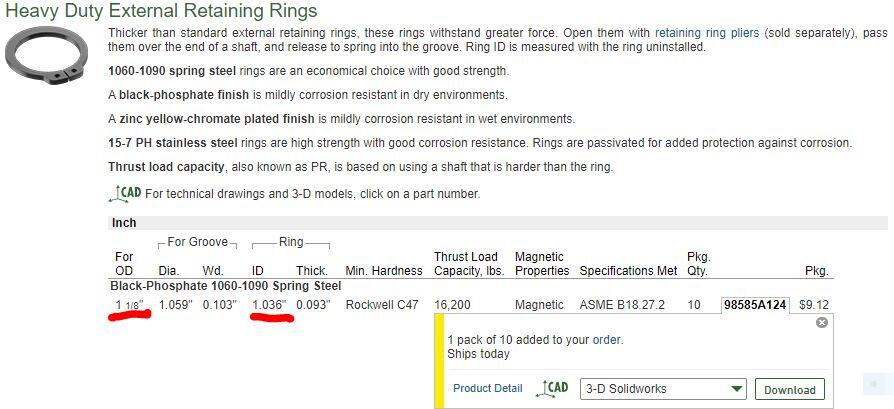

GAJoe 850 #145 Posted December 14, 2022 On 12/10/2022 at 8:48 AM, 953 nut said: Check this out from McMaster-Carr. They have an outlet in Douglasville GA and ship very quickly. I got the snap rings for 1 and 1/8" shaft and they arrived quickly but the groove is deeper than the ID so it is loose to spin. I guess I will have to measure the diameter of the groove with an accurate devise and reorder ): . 2 Share this post Link to post Share on other sites

GAJoe 850 #148 Posted December 15, 2022 The diameter of the groove measures 0.995 on both axle shafts. The snap ring for the 1 and 1/8" inch shaft that I got measures 1.03" ID. The next smaller size is 0.978 ID for a 1 and 1/16" shaft. I think that is what I need. What say you guys with experience? 1 Share this post Link to post Share on other sites
GAJoe 850 #149 Posted December 17, 2022 Those smaller snap rings did stretch a bit to get them over the splines and they can be rotated in the groove but they don't have the 1/16' up and down movement. It the best that I can do. They are getting maximum contact with the splines. 3 Share this post Link to post Share on other sites

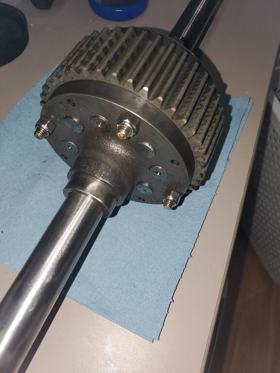

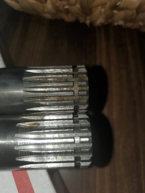

GAJoe 850 #150 Posted December 17, 2022 (edited) I just have to say that the Evapo-Rust performed excellent for removing the rust. Look at the before and after with no elbow grease what-so-ever. Edited December 17, 2022 by GAJoe added details. 2 2 Share this post Link to post Share on other sites
