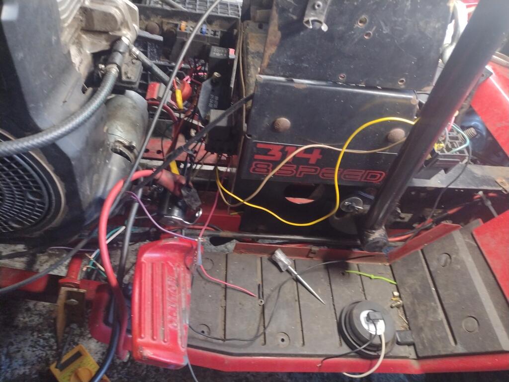

David phillips 2 #1 Posted November 14, 2022 I'm trying to bypass all my fuses linkages what do you call it relays I just have a start switch and a kill switch that's it does anybody know how to do that 1 1 Share this post Link to post Share on other sites
lynnmor 7,572 #2 Posted November 14, 2022 Was it hit with a hand grenade? 1 1 Share this post Link to post Share on other sites
953 nut 57,978 #3 Posted November 14, 2022 As stated on your other post, it is the policy of this website to maintain all safety switches in working order. If we lead you to defeat any safety equipment and an accidental injury were to occur we would feel terrible. Please give us the year or Model number (found on the fender under the seat) of your 314 8 and we will help you correct the problems. 3 Share this post Link to post Share on other sites
Rick3478 434 #4 Posted November 15, 2022 6 hours ago, David phillips said: I'm trying to bypass all my fuses linkages what do you call it relays I just have a start switch and a kill switch that's it does anybody know how to do that Yeah, don't do that. The safety interlocks are there for good reason. 2 1 Share this post Link to post Share on other sites
Snoopy11 5,717 #5 Posted November 16, 2022 I don't necessarily plan to help anyone delete their safety devices, but I don't frown on it with non-mowing machines. If deleting some of the safety switches on non-mowing machines saves a Wheel Horse from the scrap pile... I respect the owner's effort. Just a look at the wiring guide on the tractor and a little logic will tell you how to rewire it... it isn't rocket science... and I'm no electrical guru... p7-56A 1999-2001 314-8 Rev'd.pdf Don 2 Share this post Link to post Share on other sites
