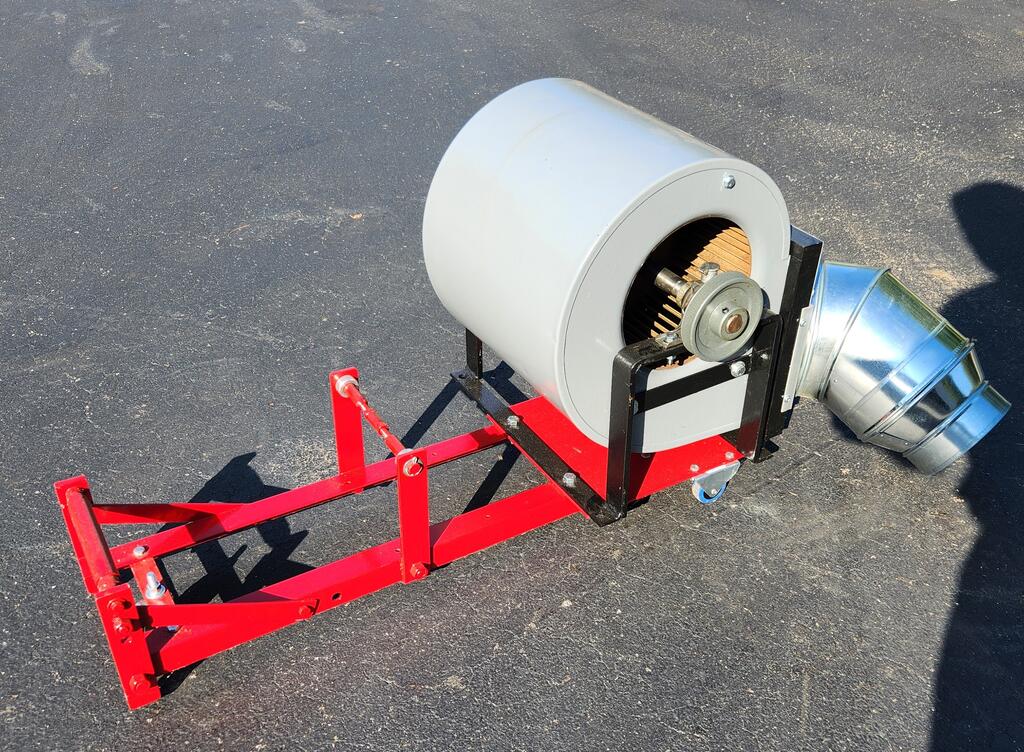

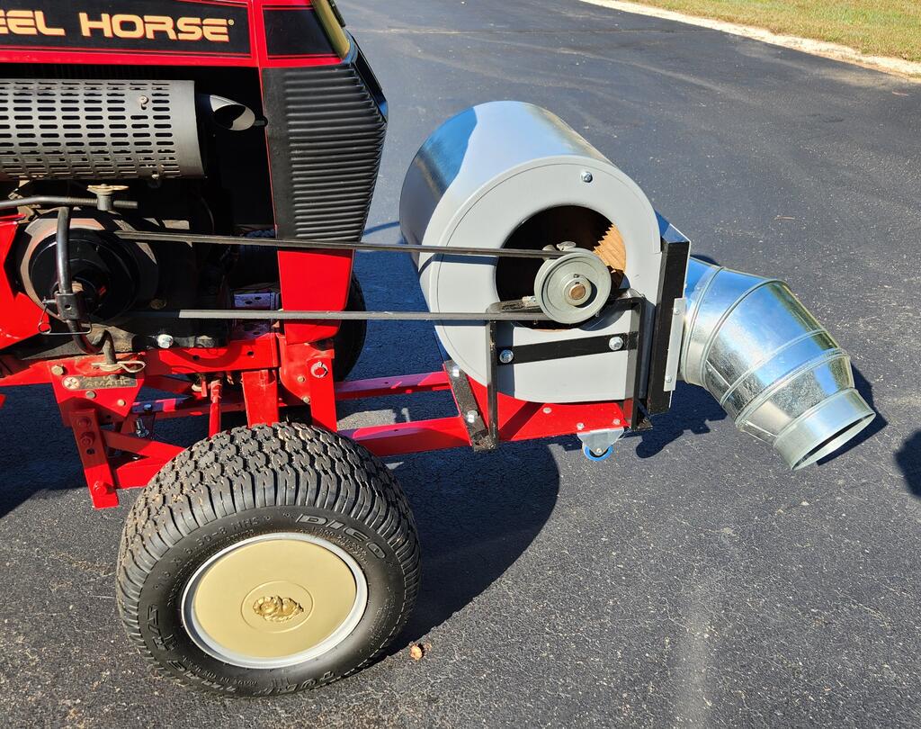

ebinmaine 69,444 #2 Posted November 14, 2022 Seems to me there's a couple. I know @953 nut Richard has one... 1 Share this post Link to post Share on other sites
Blasterdad 2,774 #3 Posted November 14, 2022 (edited) Yep, @953 nut This one Edited November 14, 2022 by Blasterdad 2 Share this post Link to post Share on other sites
Southern_Secret 463 #4 Posted November 14, 2022 @Blasterdad @ebinmaine That's it that's the one i'm thinking of, so that's @953 nut build? Share this post Link to post Share on other sites
Blasterdad 2,774 #5 Posted November 14, 2022 5 minutes ago, Southern_Secret said: so that's @953 nut build? Yes indeed 1 Share this post Link to post Share on other sites

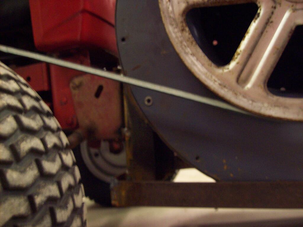

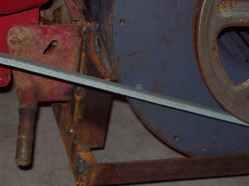

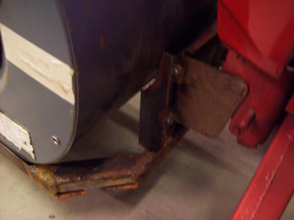

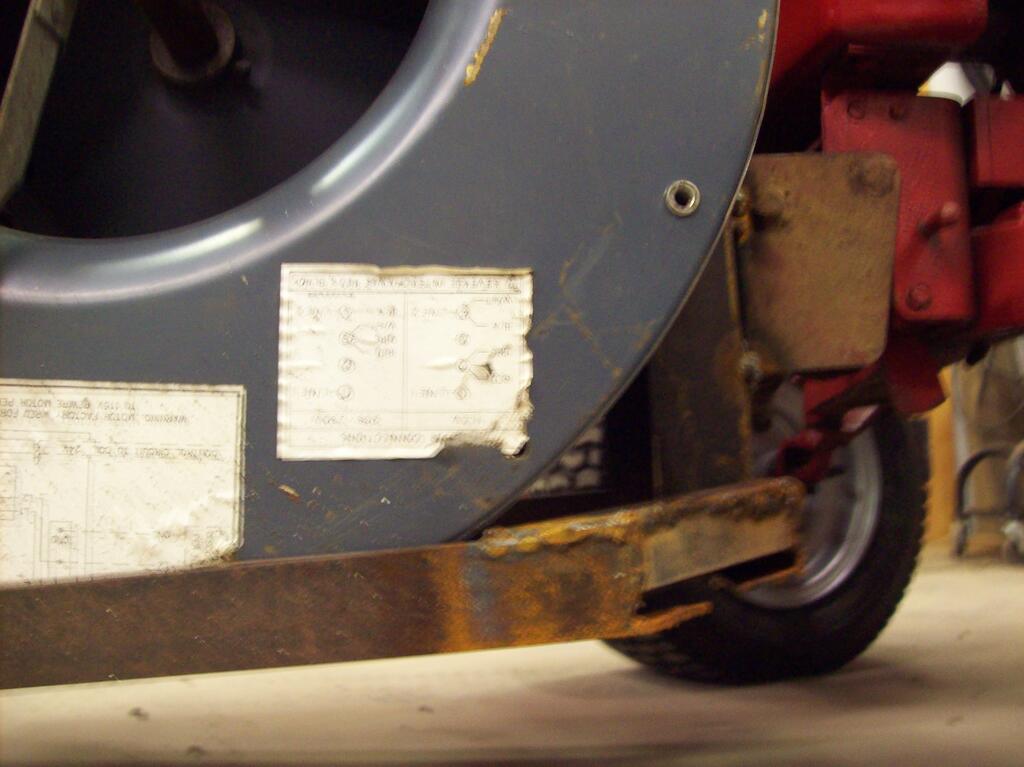

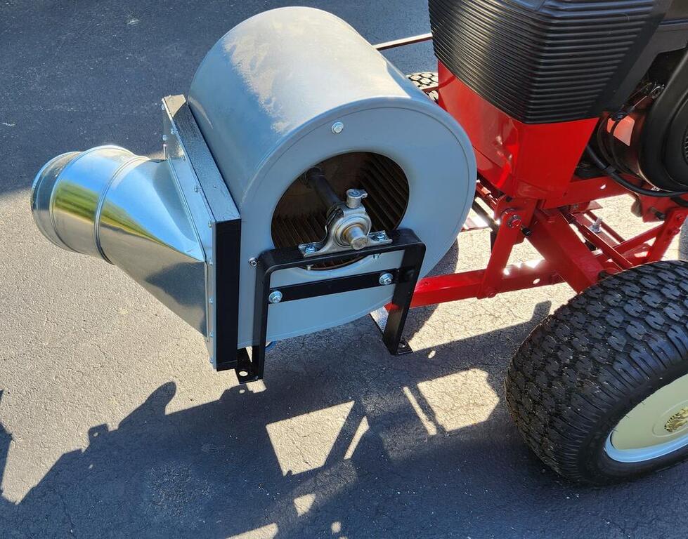

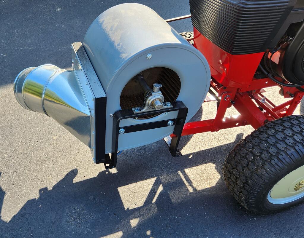

953 nut 56,566 #7 Posted November 14, 2022 The suspension for the leaf blower is an old Mule Drive and some scrap metal. Here are a few pictures of it. 2 4 Share this post Link to post Share on other sites
Southern_Secret 463 #8 Posted November 15, 2022 @953 nut do you run the belt on the "big or little" side of the PTO? What did you use to kame the nozzle? Share this post Link to post Share on other sites
