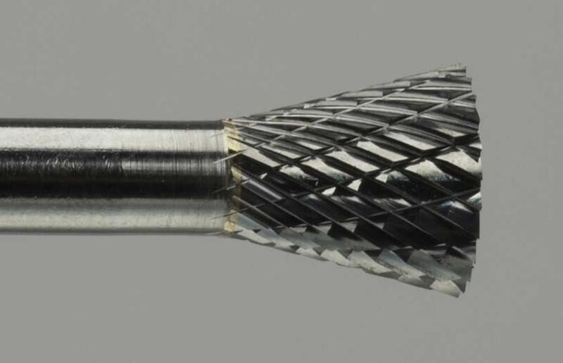

sjoemie himself 3,072 #4 Posted November 9, 2022 (edited) There are special tools for this application. Check out this link and scroll through the pictures, I think you'll get the picture https://superhandig.nl/achterwaartse-ontbramer-voor-boringen-o10-22m-grattec.html Also a dovetail shaped burr in a die grinder should work aswell. Edited November 9, 2022 by sjoemie himself Added picture 1 Share this post Link to post Share on other sites
Pullstart 64,426 #5 Posted November 9, 2022 @sjoemie himself I actually might have some of those dovetail burrs! Great idea! 2 Share this post Link to post Share on other sites
