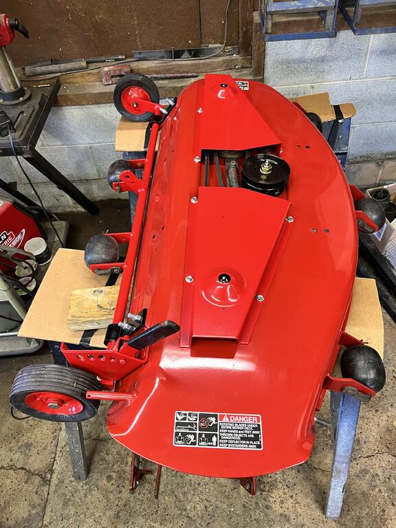

Wvtroutbum81 233 #6 Posted November 12, 2022 Put the new deck on and moved the fuel pump back by the tank, the new deck isso quiet! 5 Share this post Link to post Share on other sites
Lee1977 7,041 #7 Posted November 15, 2022 You need to add a 1/8" thick plate inside the deck under the height adjuctment bracket. The 42" decks are bad to crack right between the bolts and rust out there.. 2 Share this post Link to post Share on other sites
peter lena 9,092 #8 Posted November 15, 2022 @Wvtroutbum81 like your road testers, in addition to that deck , could re grease those mule drive bearings , with a hi temp grease , also lightly grease the pto inner needle bearing and outer bearing . that mule drive is usually in a heavy drag state , having converted my 3 units over , the easy / quiet spin up is so worth it . pete 1 Share this post Link to post Share on other sites
