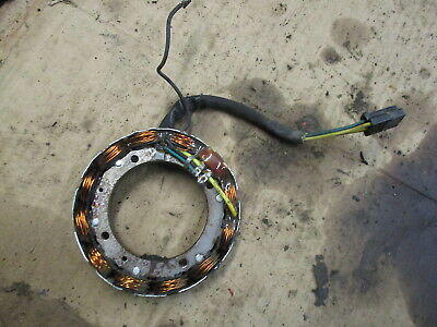

Does anyone have information or know of a video showing how to rewire a HH 100 10 Amp stator? I have the same one in the picture. Thanks!
I can tell you straight up.
The 2 yellow wires are AC power, so they go to your regulator.
The green wire is kill switch ground (grounds stator when circuit is completed... grounding this wire prevents and charge pulses from reaching the charge terminal on the SSI unit).
The wire all by itself is SSI charge wire... that would go to the left side of the SSI module itself.
