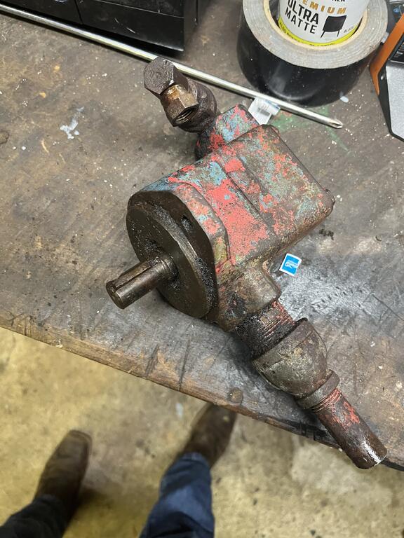

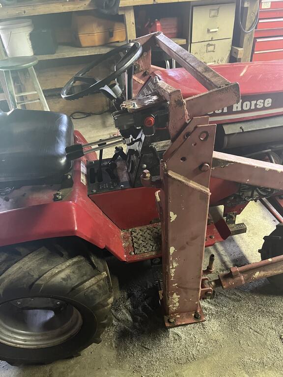

857lover 291 #1 Posted November 6, 2022 so i found the pump that was used with this loader originally and i’m wondering how i know if it’s in good working condition or not or if it needs a rebuild or if i should just get a new pump and i did get the spool valves as i belive they are called and i moved my towers back a little 2 Share this post Link to post Share on other sites
sjoemie himself 3,075 #2 Posted November 6, 2022 Well you could get lucky but imho it most of the time isn't without reason that pump is out of a tractor. Best way to go is to let a local hydraulic shop check it out. They can tell you pretty quick if it's good or not and if it is repairable. 3 Share this post Link to post Share on other sites

JoeM 7,928 #10 Posted November 6, 2022 looks like a standard old gear pump. If you can put the intake in some oil and spin it with a drill it will tell you alot. biggest issue would be the shaft seal leaking. single stage is all you need about 4-6 gpm. one issue is using a pump designed for side loading. They have a bearing on the shaft to support the side load of the belt tension. Of course this feature cost more money. 2 Share this post Link to post Share on other sites
857lover 291 #11 Posted November 6, 2022 1 minute ago, JoeM said: looks like a standard old gear pump. If you can put the intake in some oil and spin it with a drill it will tell you alot. biggest issue would be the shaft seal leaking. single stage is all you need about 4-6 gpm. one issue is using a pump designed for side loading. They have a bearing on the shaft to support the side load of the belt tension. Of course this feature cost more money. see other people have told me to chuck the shaft in a drill but the shaft diameter is to big unfortunately Share this post Link to post Share on other sites
JoeM 7,928 #12 Posted November 6, 2022 3 minutes ago, 857lover said: told me to chuck the shaft in a drill but the shaft diameter is to big unfortunately just figured you would have to make some kind of adapter. tack a nut to end of the shaft? I have already put a pulley on the shaft and spun them with a wire wheel in the drill running it in the grove. 1 Share this post Link to post Share on other sites
oliver2-44 10,367 #13 Posted November 7, 2022 When it comes to hydraulics, Cleanliness is paramount. A little grit can destroy a pump, valve and cylinders in short operating time. Before you start spinning that pump give it a good clean outside. Then try to flush it out with clean diesel or kerosene I would pour some in one of the ports, let it sit a while to soften crud, then dump it out. If a lot of grit/filth comes out, repeat. Then do the other port. Once both ports seem clean, pour your cleaning fluid into the intake port and spin it by hand to move the fluid through the pump. doing this at slow speed (hand turning) will help prevent internal scratches (wear) that can occur quickly at high speed. If the ports are not marked (inlet/outlet, or suction/pressure) spinning it by hand will confirm which is which. Looking at the picture I suspect the side with the pipe reducer is the Inlet (suction) and the side with the high pressure hose fitting is the outlet (pressure) In the picture with the loader towers I can see what looks like a partial sub frame that stops at the center attach-a-matic bracket under the engine. Do you have any bracing all the way to the front of the tractor and bracing going back from the front at an angle to the towers? 1 Share this post Link to post Share on other sites

953 nut 57,902 #15 Posted November 8, 2022 With a front end loader it is more a matter of volume than it is about high pressure. Much like air compressors the two stage pump builds higher pressure and is not the way to go, On 11/6/2022 at 11:43 AM, 857lover said: it ended up working out and i definitely learned a lot from this kind of stuff That is why we enjoy helping our younger members. None of us were born knowing anything, we had the blessing of being around people who were willing to help us learn and now we can pass it along. Before long you too will be helping others. Keep up the god work. Share this post Link to post Share on other sites
