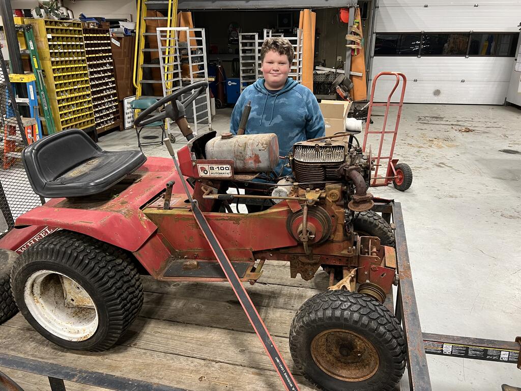

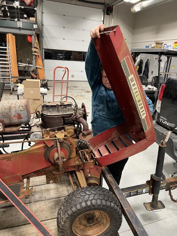

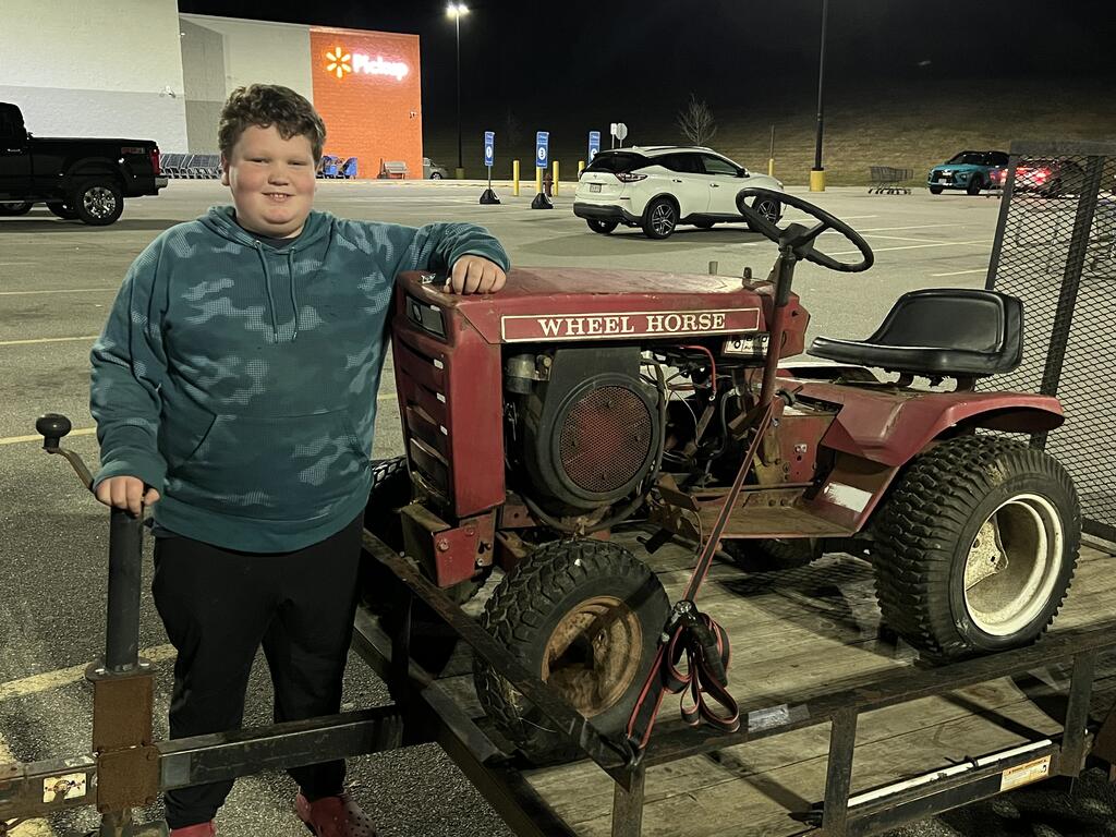

WheelHorse_Kid 355 #1 Posted November 5, 2022 I’m always looking for tractors and my dad found a c-100 8 speed for sale kind of close to home.I had my dad reach out with a offer and the person refused and then raised the asking price.My dads friend @Crazywheelhorseman found out and told my dad that he had a tractor that he would sell to me.He said it was a c-100 automatic but when he got home he realized it was a b-100 automatic.He sent my dad pictures and I liked the tractor so we went and picked it up today.He included a new hood because the one on it was dented and included a few other parts.We went to my dads work because he had to swap out tires so while he did that I swapped out the dented hood out with the extra one he gave me.It runs and drives great.and the muffler broke so we have to fix that.I am thinking about swapping it to hydro lift and using it as a mowing tractor.as a bonus some one put a 12hp Motor in it. 3 11 3 Share this post Link to post Share on other sites

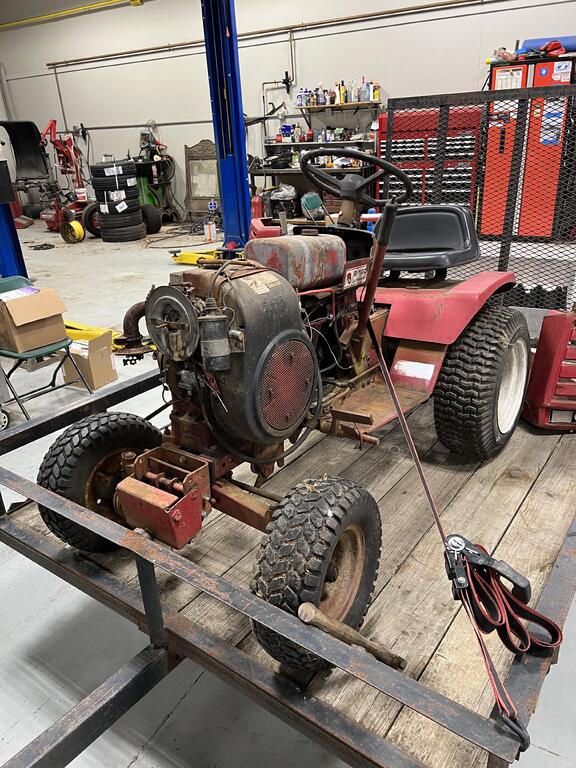

WheelHorse_Kid 355 #2 Posted November 5, 2022 2 5 2 Share this post Link to post Share on other sites
kpinnc 12,943 #3 Posted November 5, 2022 Congrats! Looks like a good solid machine. Hydros definitely make better mowers. I'm sure you will enjoy it! 2 Share this post Link to post Share on other sites

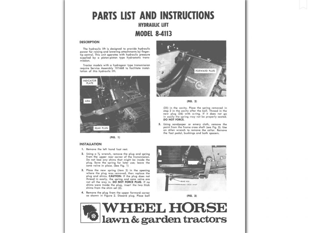

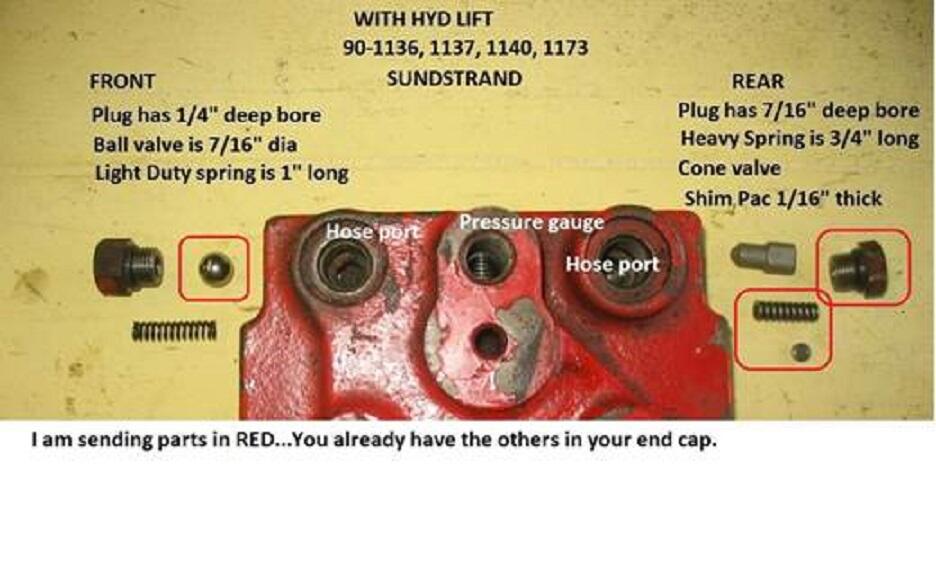

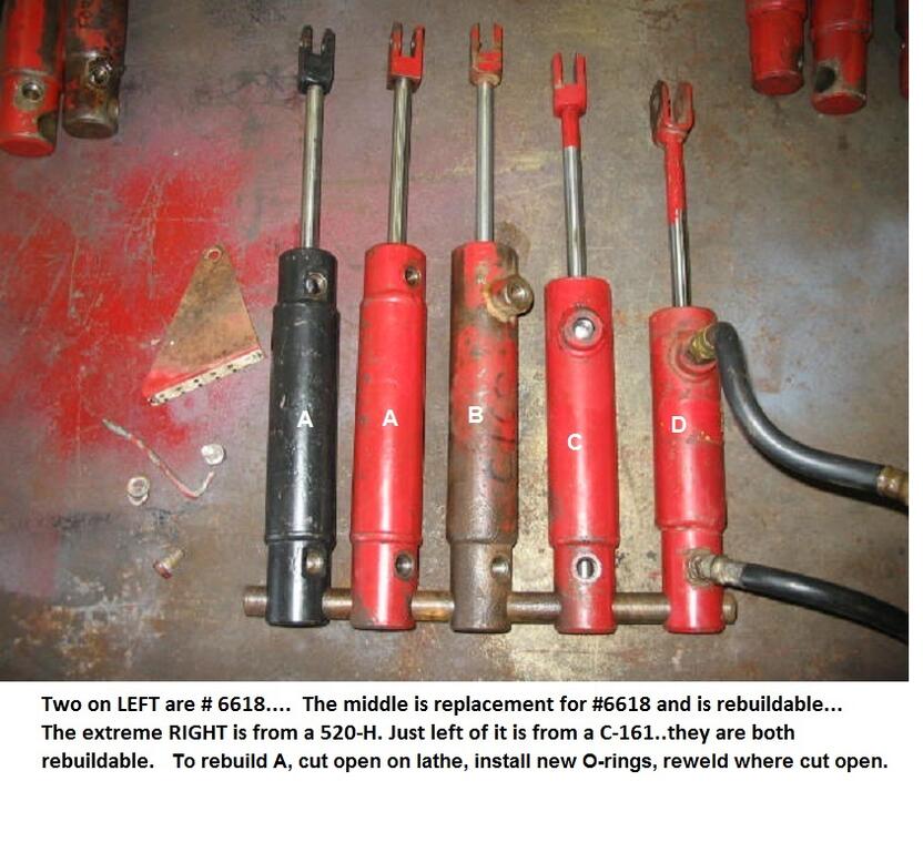

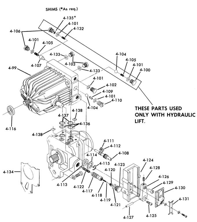

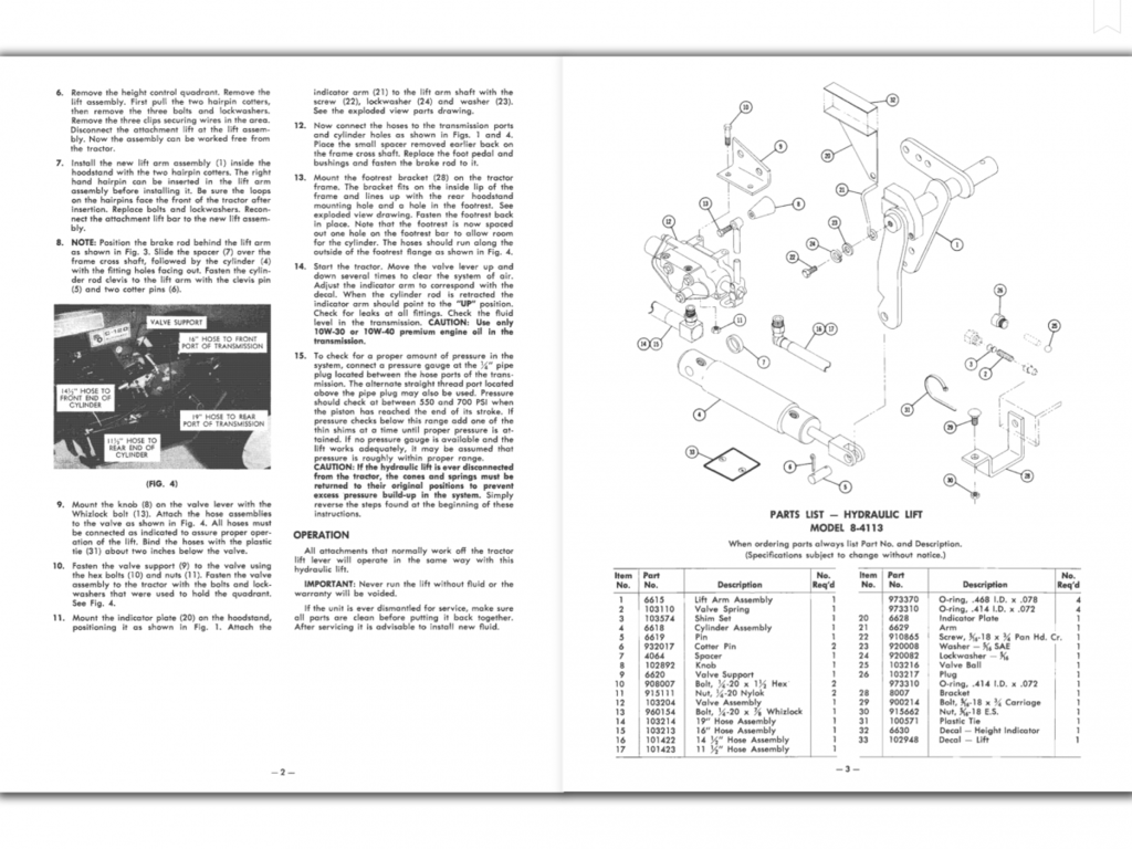

daveoman1966 3,766 #4 Posted November 5, 2022 HYD LIFT CONV 90-1136 90-1140.docxThe B-100 has Sundstrand Piston-to-Piston power unit. If you can find the parts, it is quite easy to add the HYDRAULIC LIFT. The OEM lift kit is part# 84113. You can see it on the TORO MPV. https://lookup3.toro.com/partdex/index.cfm?xCaller=Toro Aside from the hoses, ram, control valve, you will need the END CAP valve parts shown here. I have made up and provided a couple dozen of these Hyd lifts, but not sure where you'll find parts today. NOTE... Best bet may be to locate from eBay... Wheelhorse Parts N More can supply new hoses and O-rings as needed. Hose #s are one the TORO MPV too. 1 6 Share this post Link to post Share on other sites
Achto 28,083 #6 Posted November 5, 2022 Great looking tractor!! Enjoy it. 1 2 Share this post Link to post Share on other sites
ebinmaine 69,361 #7 Posted November 5, 2022 Very cool story. Nice to see our own members help out when someone else... Didn't. Looks like you've got a good solid runner there. Interesting old style metal gas tank sideways mount. @daveoman1966 Excellent write up! Thank you for sharing you long experience and knowledge. I've done the conversion you folks are speaking of. Fairly easy. 3 Share this post Link to post Share on other sites
WHGuy413 2,769 #8 Posted November 5, 2022 24 minutes ago, ebinmaine said: Very cool story. Nice to see our own members help out when someone else... Didn't. Looks like you've got a good solid runner there. Interesting old style metal gas tank sideways mount. He’s pretty excited. It sounds great and drove great when we picked it up. Haven’t even unloaded it yet. The gas tank is in there temporarily. The right one was included in the sale along with the air filter housing and filter, and a non dented hood. 3 Share this post Link to post Share on other sites
Retired Wrencher 5,569 #9 Posted November 5, 2022 Nice tractor with an auto. Is that your Dads Garage? If so, very nice and handy to have. Enjoy the auto, looks to be a good worker. 1 1 Share this post Link to post Share on other sites

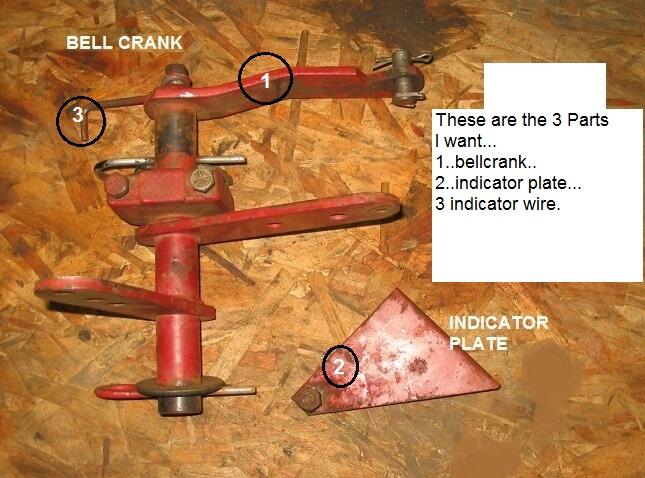

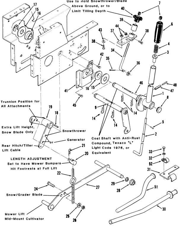

953 nut 56,481 #10 Posted November 5, 2022 8 hours ago, WheelHorse_Kid said: I am thinking about swapping it to hydro lift and using it as a mowing tractor Looks like a good sound tractor. A strong young man like you should have no problem using the manual lift for mowing, I'm 77 years old and use the manual lift on my 310-8 for mowing all the time. If you decide to swap over to hydraulic lift the removal of the old manual rock shaft will be the hardest part of the job. Part #46 slides into part #19 and is secured with a square key part #18. On the surface this seems simple enough but most of the time part #46 will be rusted (Brown Welded) inside of #18 1 2 1 Share this post Link to post Share on other sites

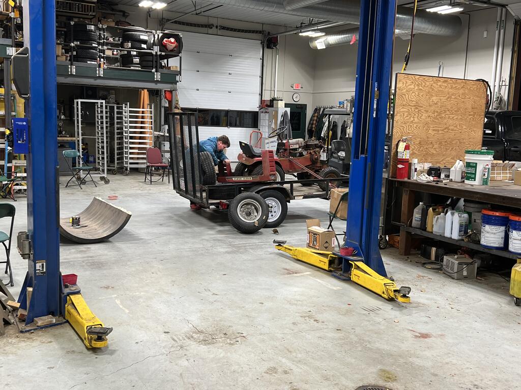

WHGuy413 2,769 #13 Posted November 5, 2022 2 hours ago, Retired Wrencher said: Nice tractor with an auto. Is that your Dads Garage? If so, very nice and handy to have. Enjoy the auto, looks to be a good worker. Technically no it’s not my garage. I work for a place that lets me use the garage, lift and shop space. Tonight I had to pick my daughter up at her job which is conveniently 2 mins from my job. we picked up the tractor and instead of driving home we went to the shop where I used the tire machine to dismount old tires and install new tires on the rims of my 416H. While there Alex started tinkering using tools in the shop. I definitely wish I had all this spade to work on stuff. 2 Share this post Link to post Share on other sites
WHGuy413 2,769 #14 Posted November 5, 2022 2 hours ago, 953 nut said: Looks like a good sound tractor. A strong young man like you should have no problem using the manual lift for mowing, I'm 77 years old and use the manual lift on my 310-8 for mowing all the time. If you decide to swap over to hydraulic lift the removal of the old manual rock shaft will be the hardest part of the job. Part #46 slides into part #19 and is secured with a square key part #18. On the surface this seems simple enough but most of the time part #46 will be rusted (Brown Welded) inside of #18 He’s definitely strong! But Crazywheelhorseman has all the parts needed to swap it over. He has 4 other tractors with hand lift so it would be something different for him. 1 Share this post Link to post Share on other sites

kpinnc 12,943 #16 Posted November 5, 2022 (edited) 12 hours ago, daveoman1966 said: HYD LIFT CONV 90-1136 90-1140.docxThe B-100 has Sundstrand Piston-to-Piston power unit. You should put this procedure up somewhere. Thought it doesn't happen much anymore due to lack of parts, it's good info to have. Edited November 5, 2022 by kpinnc 1 Share this post Link to post Share on other sites

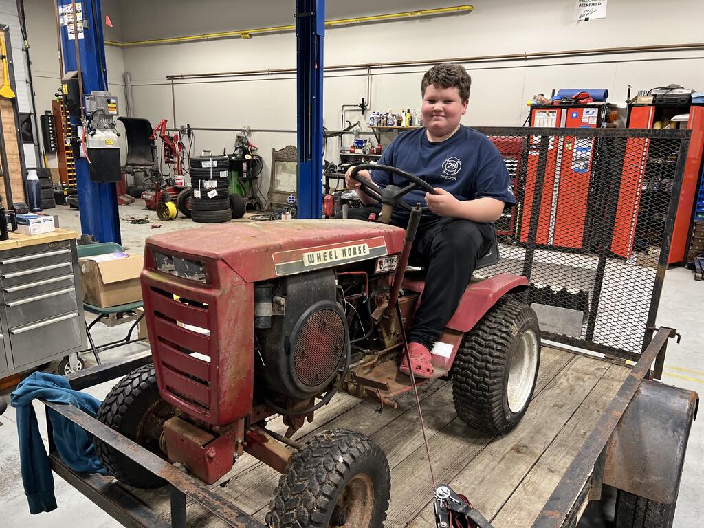

WheelHorse_Kid 355 #17 Posted November 5, 2022 With the help of our friend Kyle we heated up the block and we’re able to get the old Broken exhaust off and then my dad and I put a new one on.it was so much quieter and I got to drive it.still lots more to do. 3 1 Share this post Link to post Share on other sites

Retired Wrencher 5,569 #20 Posted November 6, 2022 20 hours ago, WHGuy413 said: Technically no it’s not my garage. I work for a place that lets me use the garage, lift and shop space. Tonight I had to pick my daughter up at her job which is conveniently 2 mins from my job. we picked up the tractor and instead of driving home we went to the shop where I used the tire machine to dismount old tires and install new tires on the rims of my 416H. While there Alex started tinkering using tools in the shop. I definitely wish I had all this spade to work on stuff. Well Matt at least you can use it when you need it. I would say very handy especially the tire changer and rack. 2 Share this post Link to post Share on other sites
