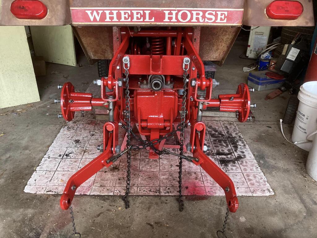

"Manic-Mechanic" 1,228 #1 Posted November 2, 2022 (edited) Finally rebuilt the 3 pt and kept accomodations for the anti-sway chains to the Finish Mower Edited November 3, 2022 by "Manic-Mechanic" 8 Share this post Link to post Share on other sites
Pullstart 64,594 #2 Posted November 3, 2022 Sa-weet! What are the vertical chains for, limit straps for downward movement? 1 Share this post Link to post Share on other sites
"Manic-Mechanic" 1,228 #3 Posted November 3, 2022 1 hour ago, Pullstart said: Sa-weet! What are the vertical chains for, limit straps for downward movement? Yes, for the Finish Mower. Share this post Link to post Share on other sites

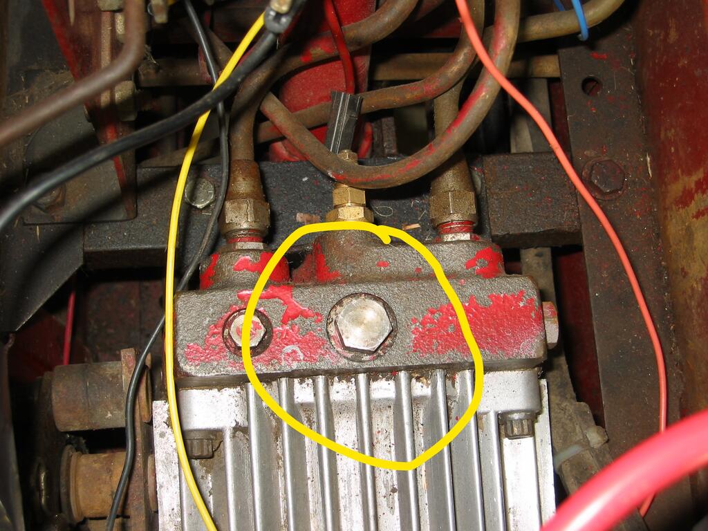

"Manic-Mechanic" 1,228 #5 Posted November 3, 2022 (edited) 25 minutes ago, pacer said: I hereby nominate you for 3 'attaboys' ---- naw, make it 4! Not so fast! I put the 5-1/2 quarts in and she moved nice then quit, no pump sound at all? How do I get the air out of the line? Edited November 3, 2022 by "Manic-Mechanic" 1 Share this post Link to post Share on other sites
pfrederi 18,335 #6 Posted November 3, 2022 They say you d not have to prime a sunstrand but when I work on my D200 i put fluid in the pump Share this post Link to post Share on other sites
