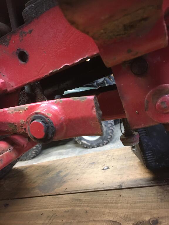

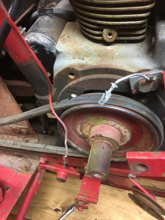

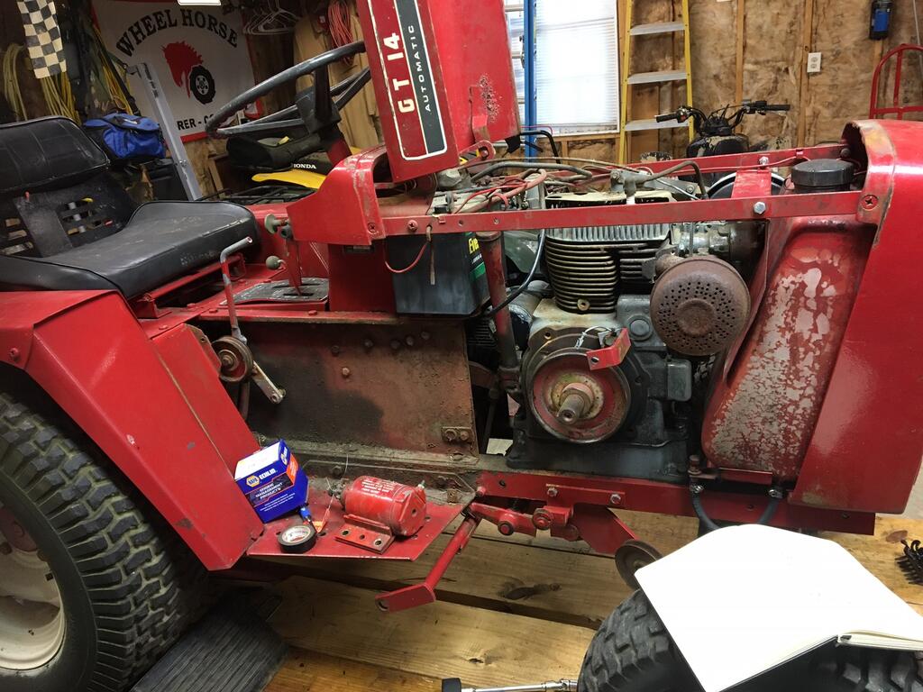

Kibbie01 28 #1 Posted October 31, 2022 I bought a GT 14 yesterday that the guy said runs, but needs a new solenoid. After I got it home and put it on the lift, I noticed that it has a broken deck bar and missing the pulley/spindle that makes the deck work. My last Wheel Horse was a C-141, so I am familiar with the 14 HP motor, but almost everything else is different on this GT 14. I will need some parts and I have no clue where to start looking other than Ebay. any suggestions? 3 Share this post Link to post Share on other sites

Kibbie01 28 #14 Posted November 2, 2022 GT 14 1st start try.MOV 1 Share this post Link to post Share on other sites

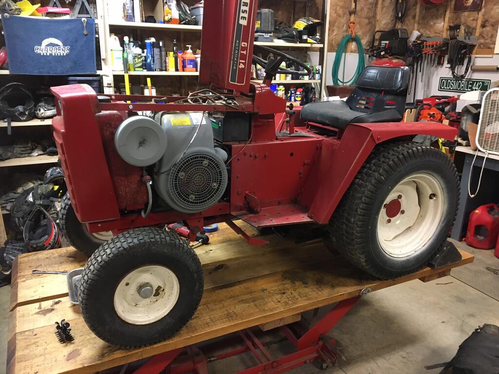

gt14rider 812 #15 Posted November 2, 2022 Can you take some not so close, rt side, lt side, eng. 1 Share this post Link to post Share on other sites

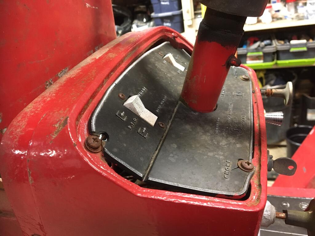

gt14rider 812 #16 Posted November 2, 2022 Looks like your missing electric pto. 1 Share this post Link to post Share on other sites

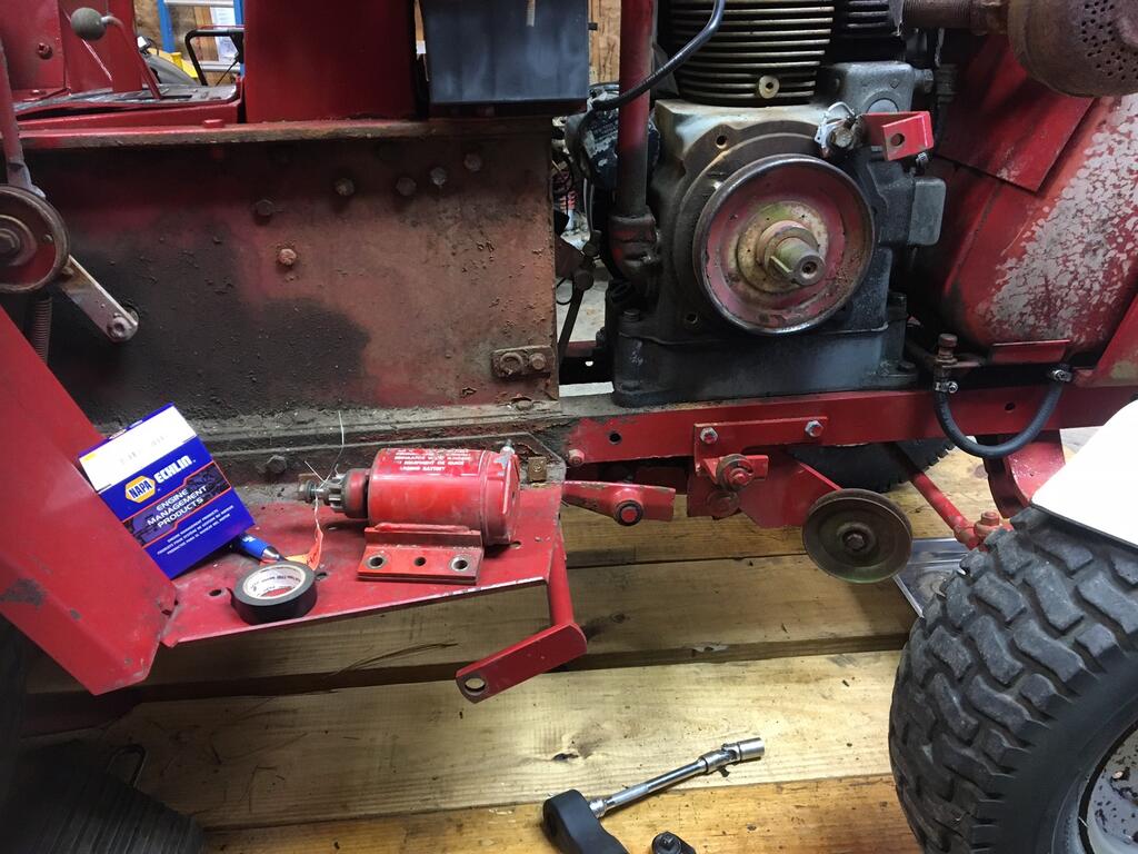

Kibbie01 28 #17 Posted November 7, 2022 that solenoid for the ford didnt work. I hooked it up and it didnt even click. when I installed the other one back on, it started working. well, the starter started spinning, but would never engage. not sure what the issue is now? 1 Share this post Link to post Share on other sites

Kibbie01 28 #21 Posted November 7, 2022 Not sure what you mean about pulling the starter manually? it will spin when I tried it after i took it off. I put another starter I had left over from my C-141. still wouldnt engage. 1 Share this post Link to post Share on other sites

Kibbie01 28 #23 Posted November 7, 2022 I tried pulling it out, but doesnt look like there is enough power to spin the big one 1 Share this post Link to post Share on other sites
Snoopy11 5,717 #24 Posted November 7, 2022 Just thinking out loud... what condition is the battery in? Seems to me the battery doesn't have enough juice to kick the starter gear out, and when you manually pull the starter gear out to contact the flywheel gear, it won't spin the flywheel because there isn't enough power.... I would try jumping your machine with, perhaps your car battery, and see if that helps your machine's condition... Don Share this post Link to post Share on other sites
pfrederi 18,103 #25 Posted November 7, 2022 use jumper cables. Black to Battery NEG and a clean bolt on the engine block. Red to battery positive and touch other end to the starter input terminal. If it engages you have a weak solenoid or more like bad ground somewhere. if it doesn't work load test battery it is bad. So many electrical problems here come back to weak battery or bad ground. 1 Share this post Link to post Share on other sites
