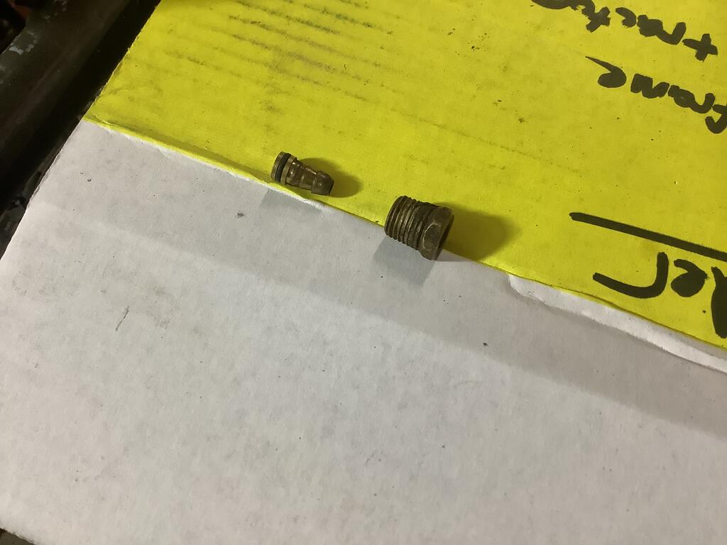

Pullstart 64,582 #1 Posted October 31, 2022 It’s a two piece hose barb, with an o-ring. I thought it was broken when the barb twisted and the body stayed put! Share this post Link to post Share on other sites

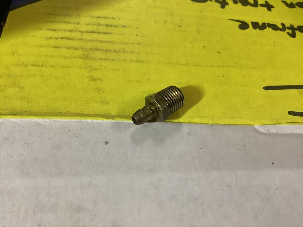

Pullstart 64,582 #2 Posted October 31, 2022 Cleaned up and assembled… Share this post Link to post Share on other sites
ri702bill 8,990 #3 Posted October 31, 2022 To allow the hose to rotate?? Seems you have to assemble the hose on to seat against the fitting, then screw the fitting in?? 1 Share this post Link to post Share on other sites
953 nut 57,969 #4 Posted October 31, 2022 Was there a sleeve that would go over the tubing and be compressed by tightening the nut? Share this post Link to post Share on other sites
WHX?? 50,768 #5 Posted October 31, 2022 That's bizarre... what was it on? Guessing low pressure? Barb looks short? 1 Share this post Link to post Share on other sites

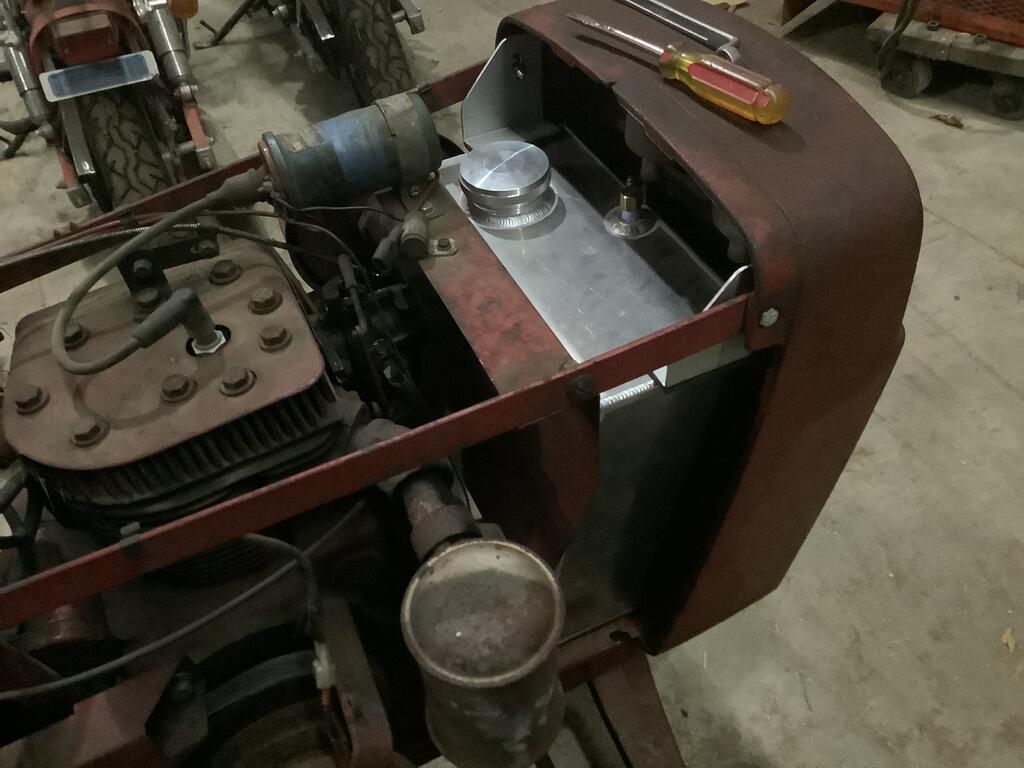

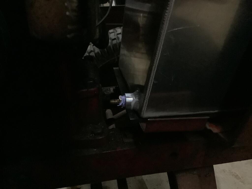

Pullstart 64,582 #6 Posted October 31, 2022 10 minutes ago, WHX?? said: what was it on the top drawer of my tool box… 12 minutes ago, 953 nut said: Was there a sleeve that would go over the tubing and be compressed by tightening the nut? your guess is good as mine, but I don’t think it would make any difference. 12 minutes ago, ri702bill said: To allow the hose to rotate?? Seems you have to assemble the hose on to seat against the fitting, then screw the fitting in?? we’ll find out if it works…. I’ll only keep 1/2 gallon or so in the tank to see if the o-ring holds up. My guess is maybe for a welder, the argon tube? 1 Share this post Link to post Share on other sites
peter lena 9,092 #7 Posted October 31, 2022 @Pullstart 2 different fitting types , HOSE BARB TO PIPE THREAD FITTING , that first picture threw me off , did not see any threads to screw into the pipe fitting . hose barbs come 2 ways , barb to barb or barb to male / female end finish . good spot for a SWAGE LOCK FITTING , available in male or female . 2 Share this post Link to post Share on other sites
squonk 42,572 #8 Posted October 31, 2022 4 minutes ago, Pullstart said: we’ll find out if it works…. I’ll only keep 1/2 gallon or so in the tank to see if the o-ring holds up. My guess is maybe for a welder, the argon tube? I 've seen them on some boilers on the air switches and sensors. Gasoline will probably turn that o-ring into oatmeal after a while. 2 Share this post Link to post Share on other sites

Ed Kennell 40,500 #10 Posted October 31, 2022 With nothing but the O ring friction holding the two parts together , It can't hold much pressure. 1 Share this post Link to post Share on other sites
Jeff-C175 7,203 #11 Posted October 31, 2022 2 hours ago, Ed Kennell said: With nothing but the O ring friction holding the two parts together , It can't hold much pressure. There must be a lip on the threaded part, and the barb goes in from the rear. Has to be some application where the hose need to rotate. Never saw that before myself. 1 1 Share this post Link to post Share on other sites
Snoopy11 5,717 #12 Posted October 31, 2022 2 hours ago, squonk said: Gasoline will probably turn that o-ring into oatmeal after a while Valid statement. Would probably happen in a matter of days. I give it a week... maximum... Don 1 Share this post Link to post Share on other sites
Ed Kennell 40,500 #13 Posted October 31, 2022 3 minutes ago, Jeff-C175 said: barb goes in from the rear. Now I see it. Probably lost too many brain cells. Eighty years of washing up in gasoline, lacquer thinner and acetone could be taking it's toll. 6 Share this post Link to post Share on other sites
Pullstart 64,582 #14 Posted October 31, 2022 3 hours ago, squonk said: Gasoline will probably turn that o-ring into oatmeal 35 minutes ago, Snoopy11 said: Valid statement. Would probably happen in a matter of days. I give it a week... maximum... Don I’ll let y’all know how long it lasts! 1 Share this post Link to post Share on other sites
Jeff-C175 7,203 #15 Posted October 31, 2022 1 minute ago, Pullstart said: I’ll let y’all know how long it lasts! You could always replace the O-ring with NBR or some such that resists the ethanol. 1 Share this post Link to post Share on other sites
Pullstart 64,582 #16 Posted October 31, 2022 Just now, Jeff-C175 said: You could always replace the O-ring with NBR or some such that resists the ethanol. I’ve resorted to pure fuel, if that helps. No corn mash in my tanks 1 2 Share this post Link to post Share on other sites
wh500special 2,249 #17 Posted October 31, 2022 It’s a swivel barb fitting. Not available at the hardware stores but available in catalogs. It allows you to preattach the hose without it rotating during assembly or is used to allow some repositioning once installed. We use them once in a while on machines where it’s hard to get a hose into place after assembly. Never had the o-ring leak as far as I know. steve 3 Share this post Link to post Share on other sites
oliver2-44 10,370 #18 Posted October 31, 2022 (edited) Since thats a speciality fitting i would bet that O-ring is something better than plane rubber. Probable Viton or NBR which should be fine for gasoline. Edited October 31, 2022 by oliver2-44 1 Share this post Link to post Share on other sites

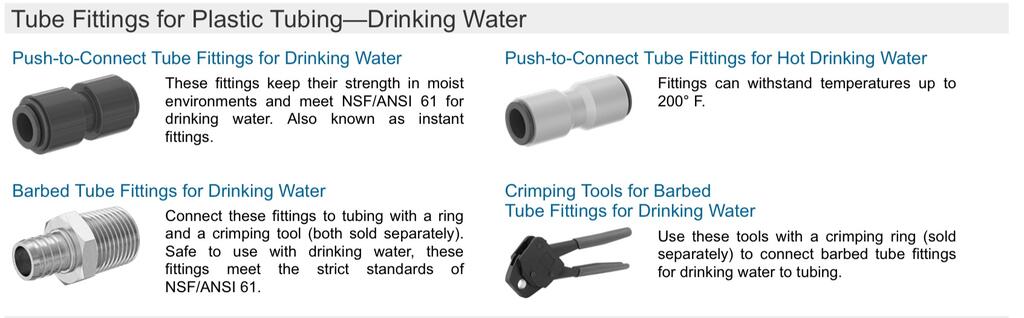

Mows4three 826 #19 Posted October 31, 2022 Me thinks it’s a drinking water fitting. You can view a similar one in the catalog of a famous hardware catalog by searching “barbed swivel fitting and looking through the pictures. Dave 1 Share this post Link to post Share on other sites
